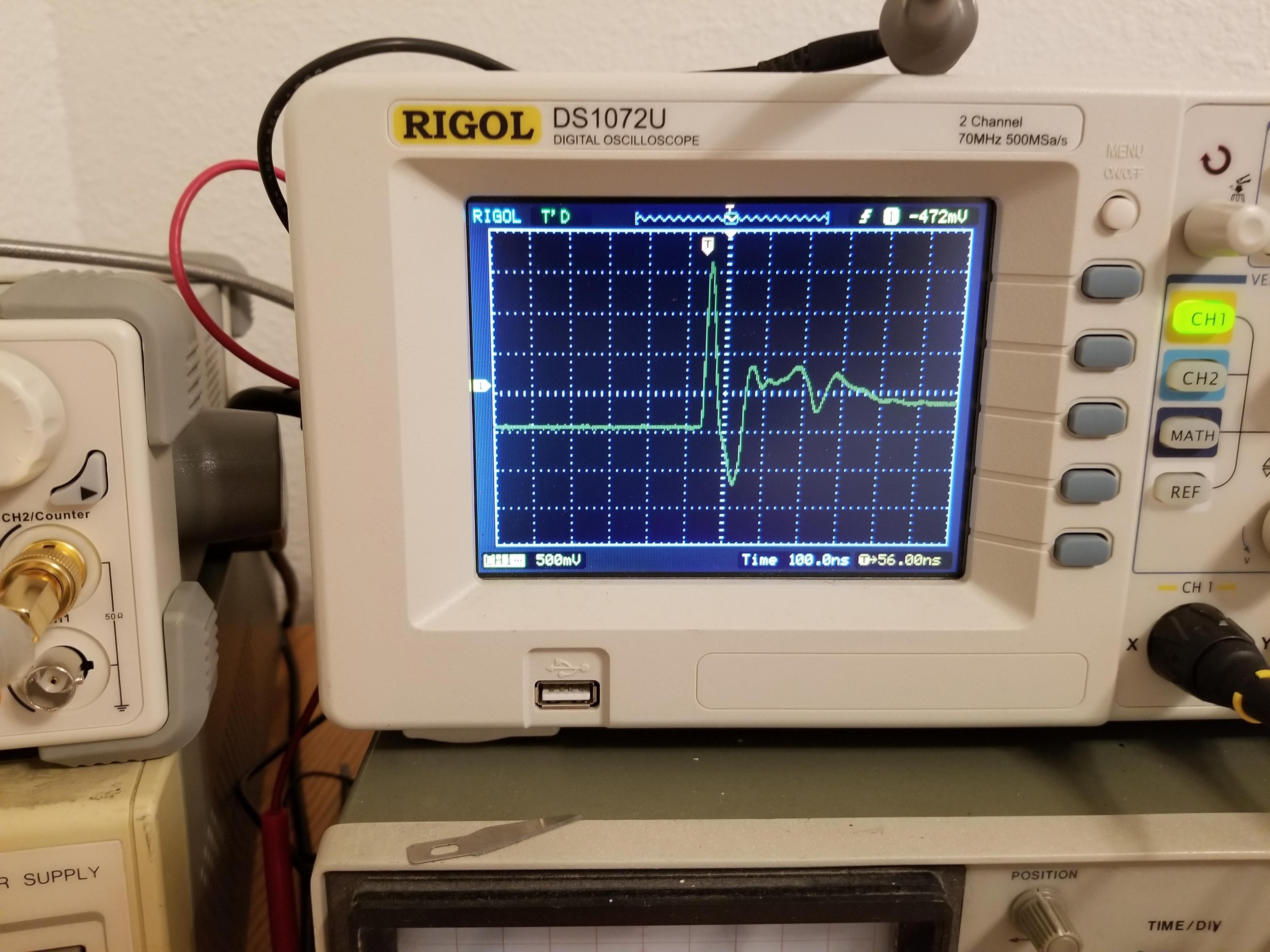

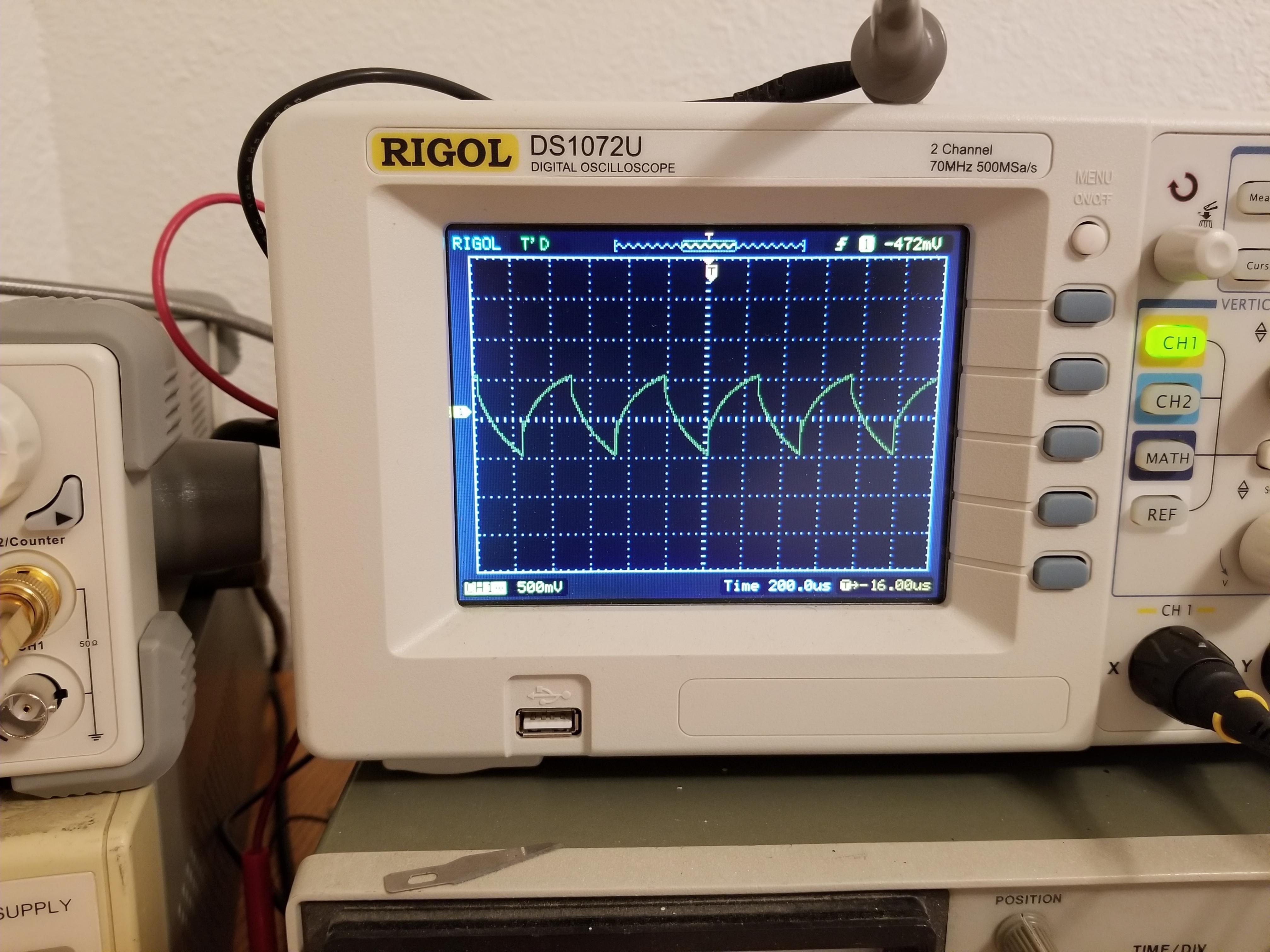

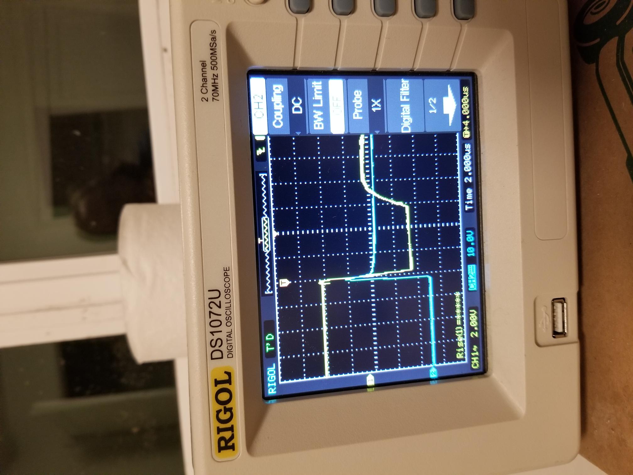

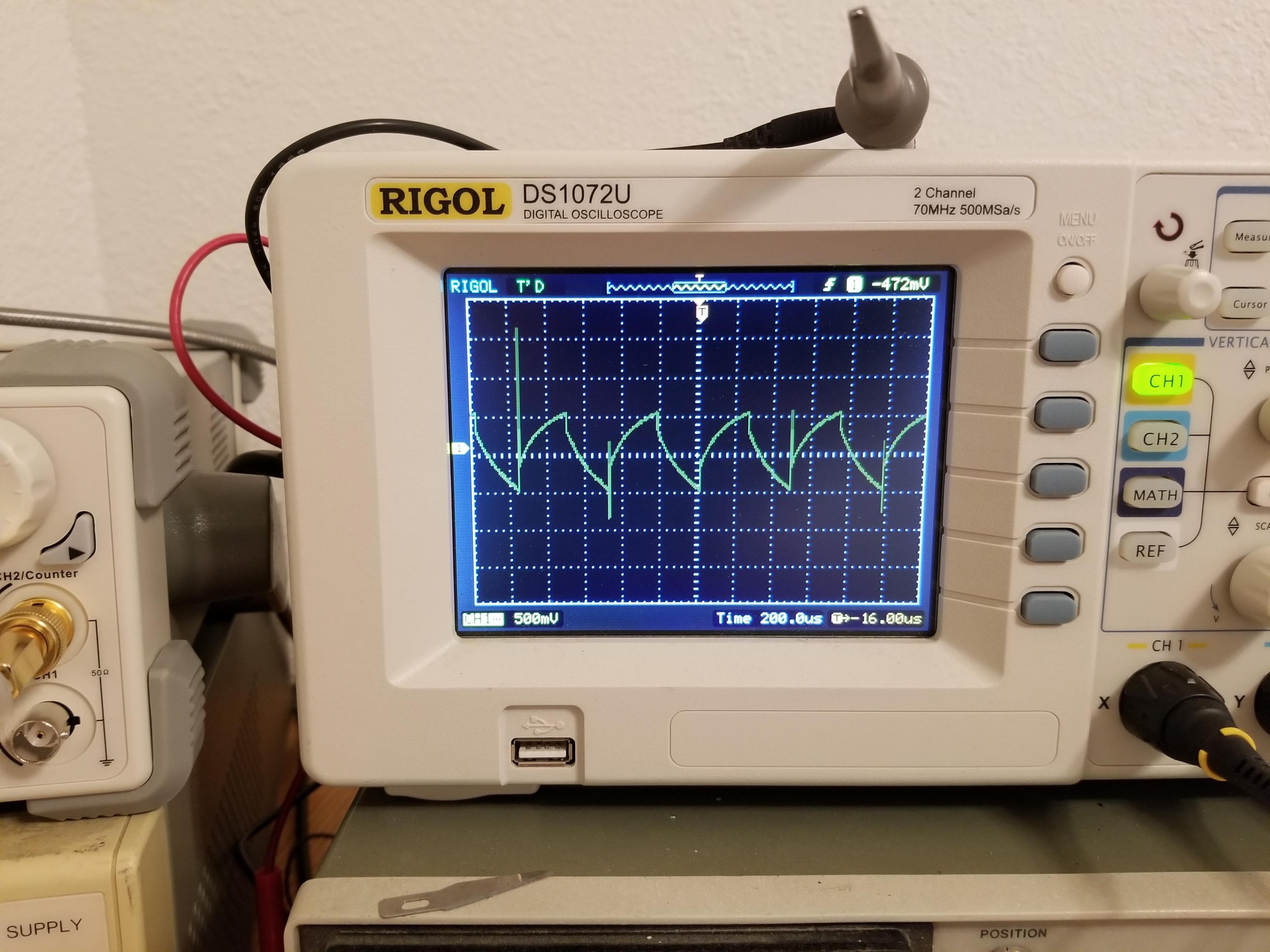

    godigit1, what was the blue spike in your 3 pictures of the preamp ?

        godigit1, what was the blue spikey pulse in your 3 pictures of the preamp in post #56 ?
        Hi 6666
        Thats the coi flyback pulse. on MPP rev d , running at almost 2 khz
        You could even add a couple Us to this coil if i was measuring from the fet to sample time. as has been stated by Carl.
        I didnt know to measure there until recently.

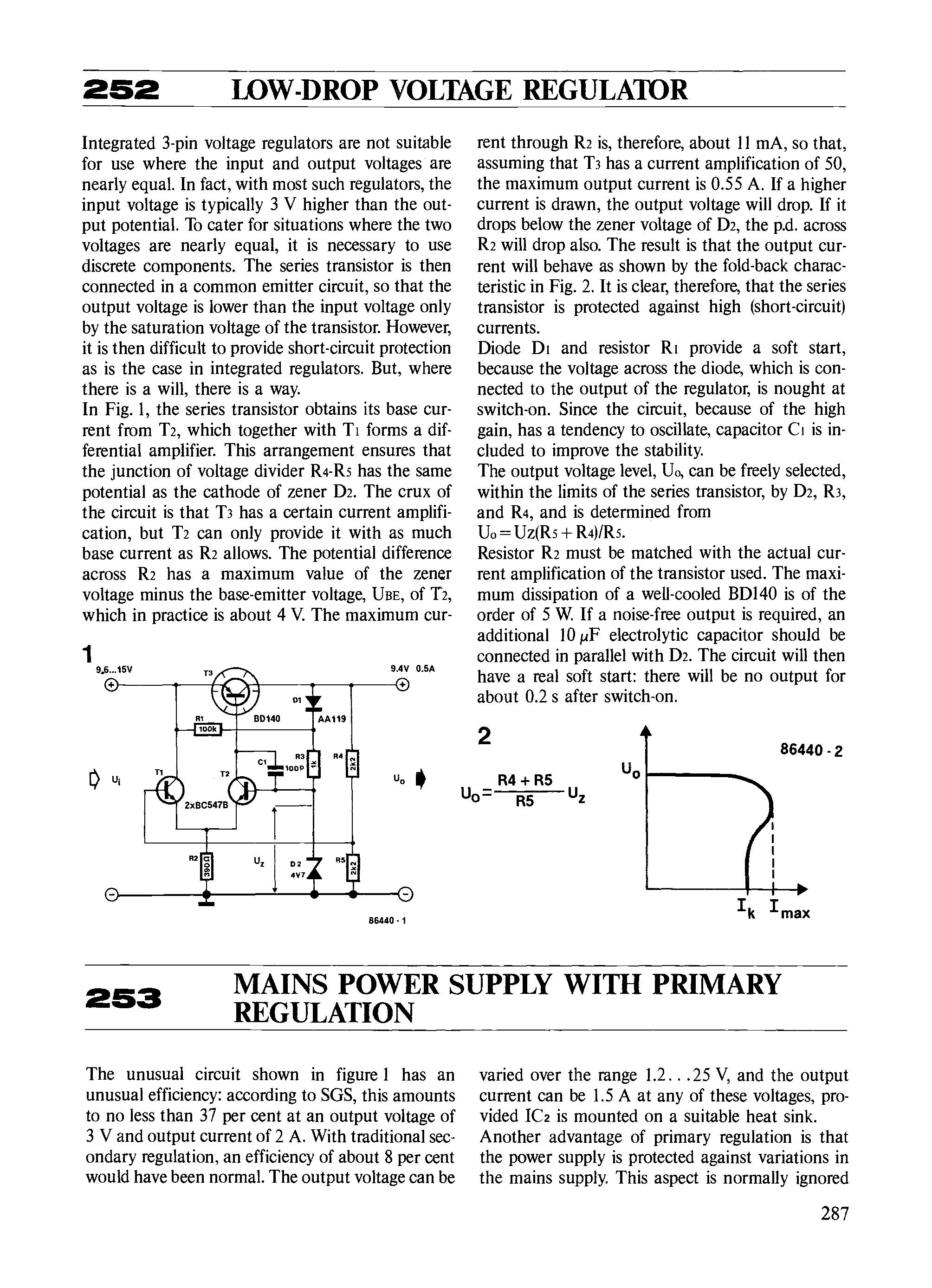

          Has anyone tried using a Low Drop Out (LDO) chip to smooth things out?
          I came across this circuit, maybe can be tinkered with.

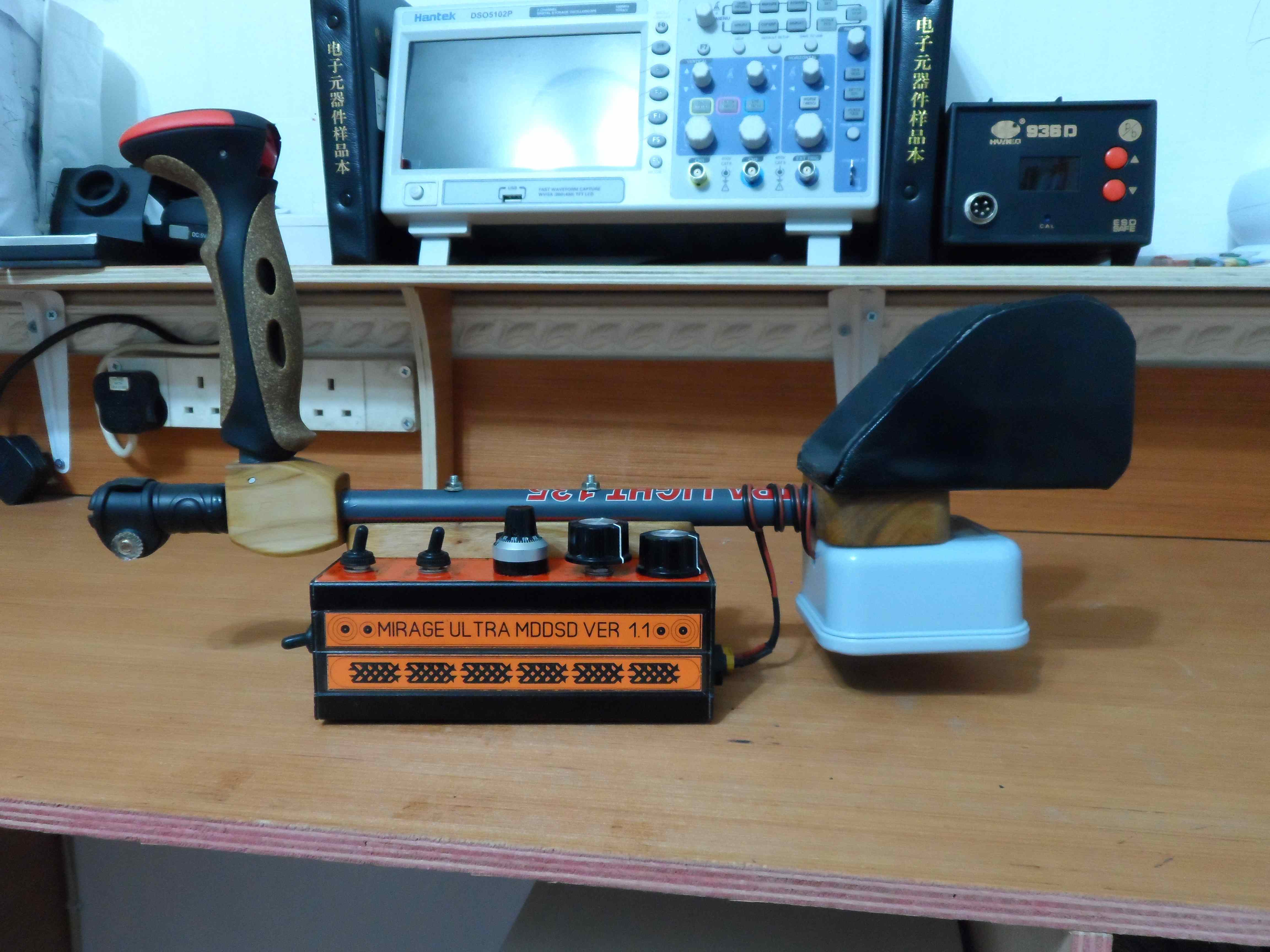

              Hi all,,,,Finally completed my 2 new Mirage Ultra MDDSD Ver 1.1 boards from Elliot. Big thanks to Elliot for all nagging I gave him in the countless emails I sent him during my build,,Great bloke and totally happy with the build. Just a couple of pics I thought I'd post of my 'Crivit hiking stick' detector shaft,,,Thanks,,,Regards,,,Marty

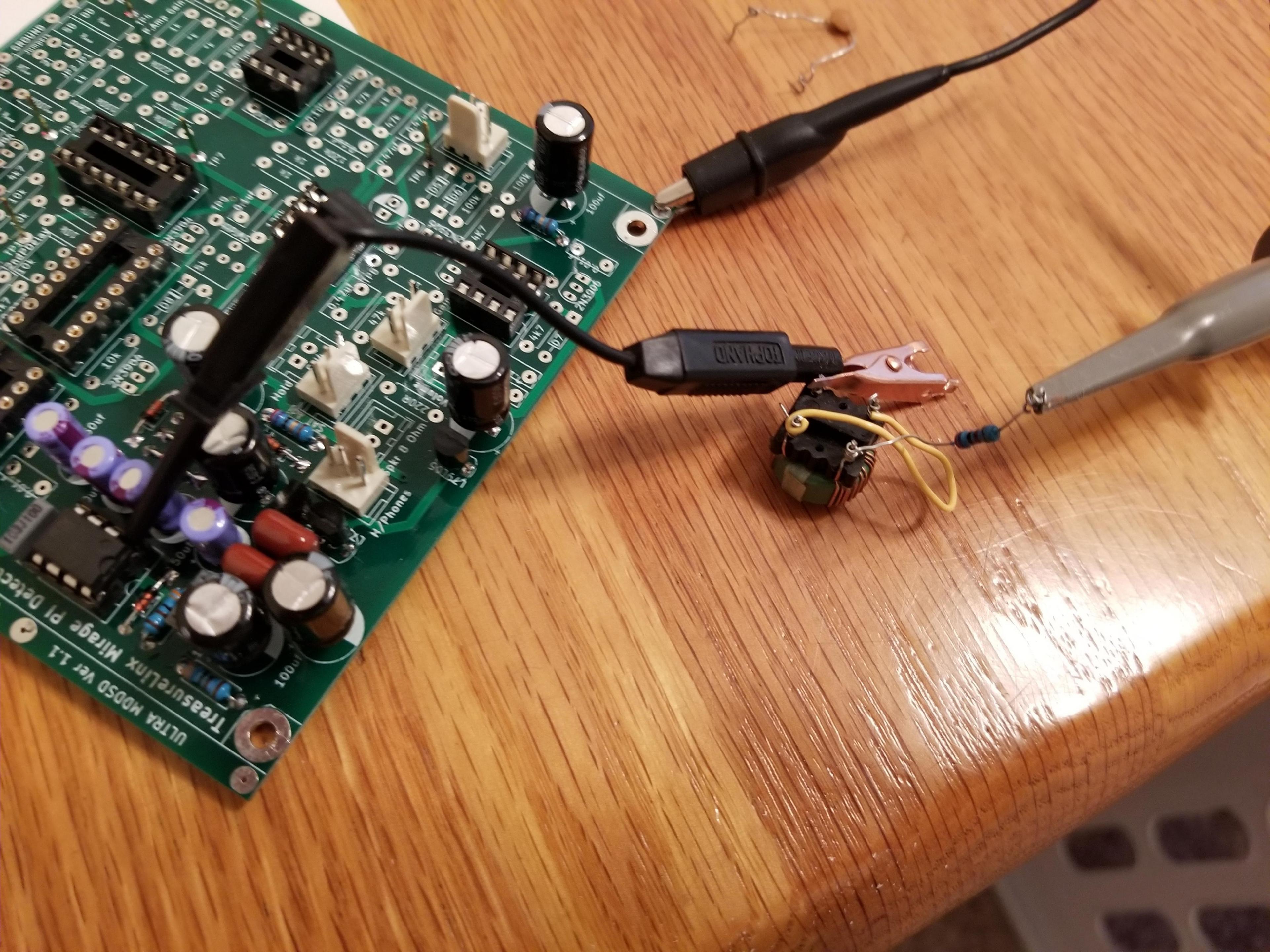

                Hi Elliot,
                Im wondering if you or anyone else here has come up with a easy solution to the power supply noise yet?
                Ive been playing with some filters and inductors and have cleaned it up pretty well I think.
                Im no engineer so could someone here possibly take a look at this to see if its a viable solution.
                Ive added a common mode choke wired in series with itself and in series with a 2.7 K resistor.
                I tried conventional hook ups and inductor cap combos but this was the cleanest Ive gotten so far.
                Following are scope shots from +18 at D9. Before and after wave form and zoom shots of the noise.
                The filter was hitched inline on the positive rail only. Im not sure how this would act under load and I know its not proper use of a commn mode choke to wire it in series and all but it seems to be working.
                The choke is two 188uH coils .
Name:	mirage powr supply.jpg
                D9 +18 Test point before and after filter.
Name:	before filter.jpg
Name:	after filter.jpg
                D9 Zoom of the noise spike.
                Zoom of noise after filter.
Name:	after filter zoom.jpg
                Starting voltage was 17.50 after choke is 17.46.
                My thought was to add this fiter inline to the output of the 555 hopefully to cleanup the +and -5 rails as well.
                Is This a Bad Idea?
                Is there a better way?
                Thanks again.

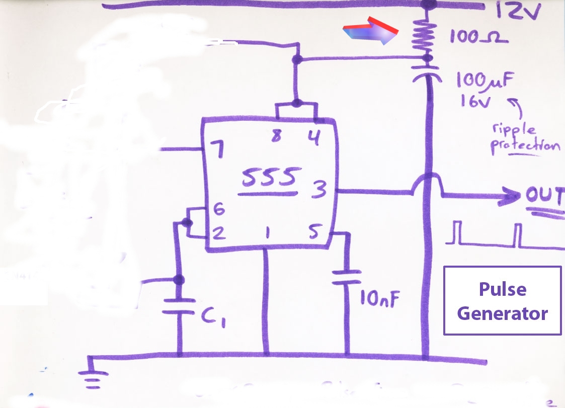

                            Been trying to post a simple 555 power mod to stop the hash ripple but forum is acting up
                            Any chance that you could try again to post this mod that you are referring to?
                            Cheers
                            • #74
                              Cheers
                              BUMP........
                              Hi 6666,
                              I am interested in seeing the mod that you were referring to in post #25.
                              Cheers
                              • #75
                                BUMP........
                                Hi 6666,
                                Cheers
                                Its just a hash filter for 555 power rail.
