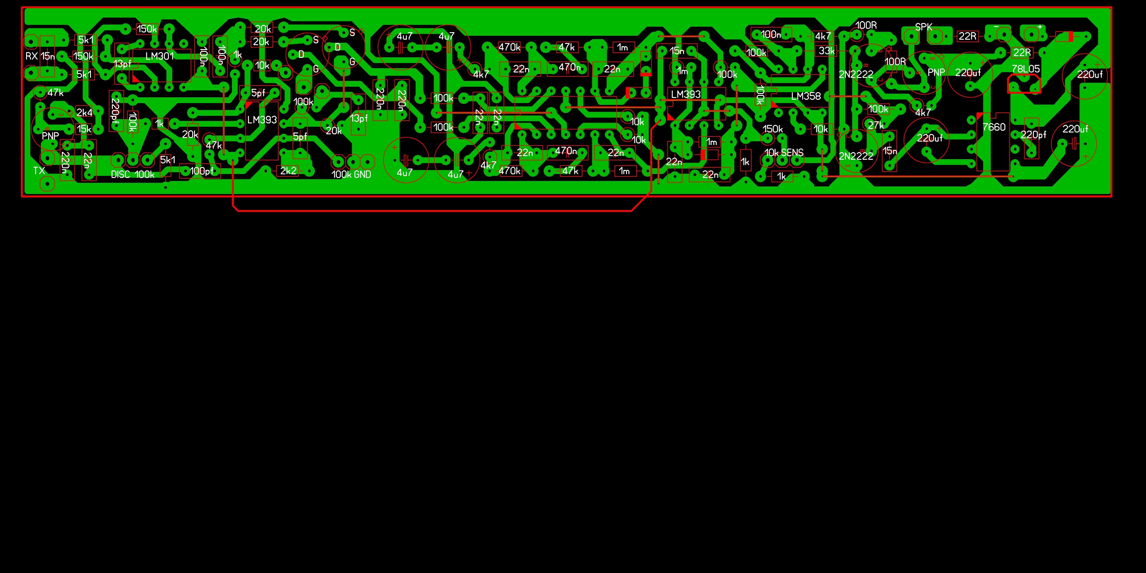

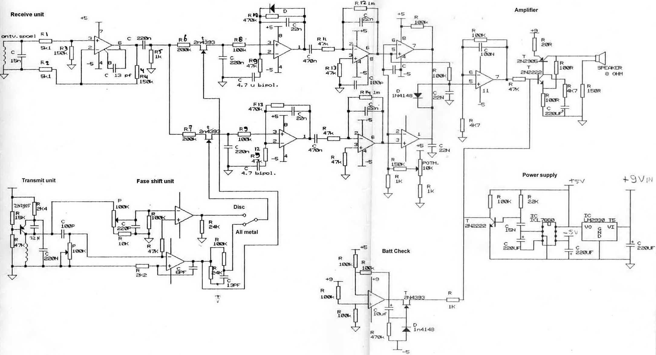

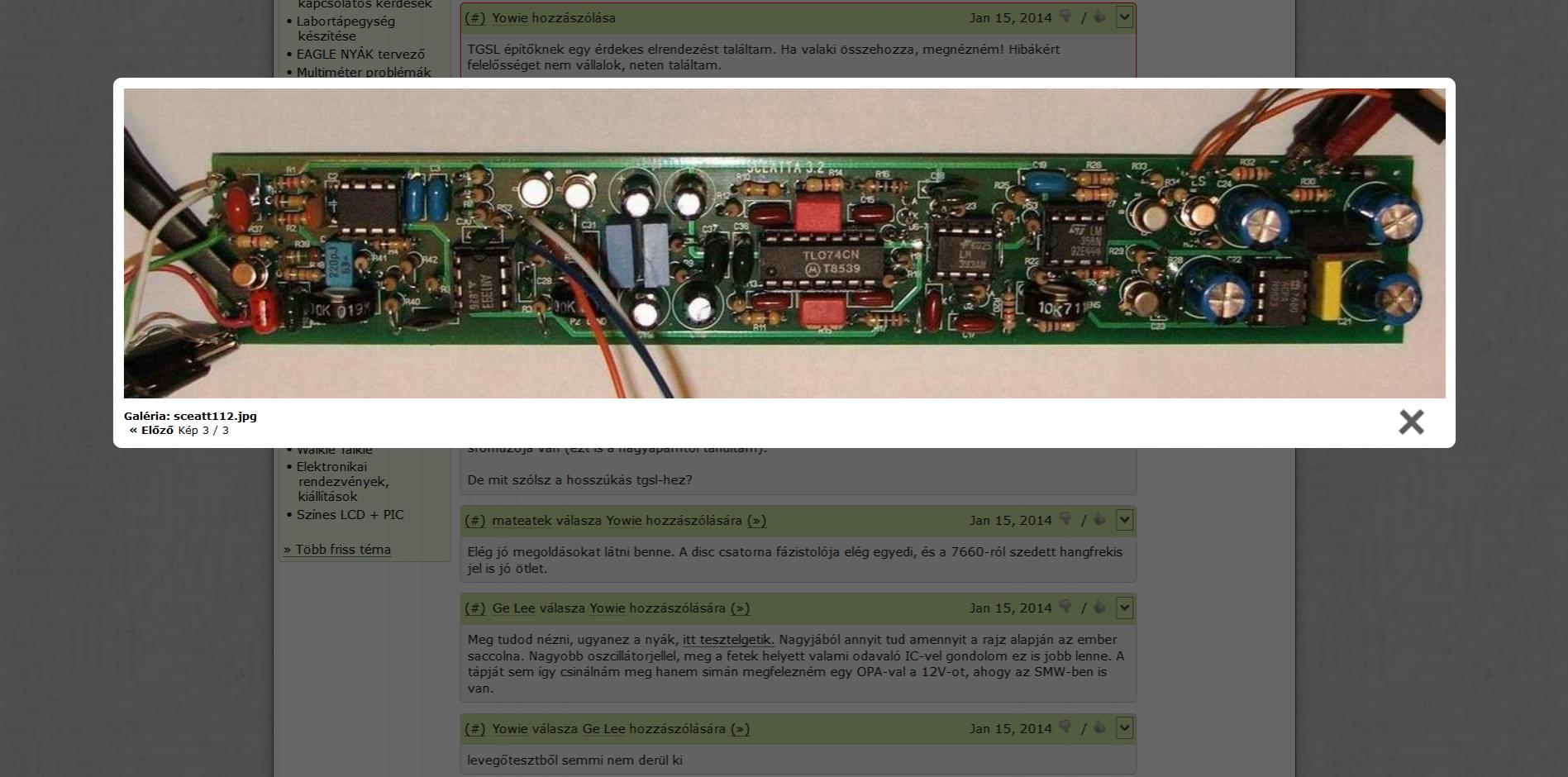

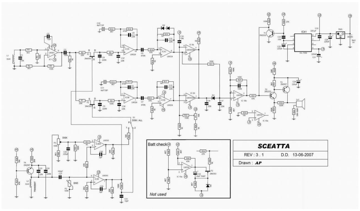

    I was on an obscure forum in metal detecting when I came across this design I have just built it after redesigning the PCB the image is not very clear but it worked first go and is an easy detector to build
    I have not tested it yet in the field, I am building it into a small hand held detector for checking small patches for nuggets or to search up walls.
    My search coil is only 100mm diameter but shows good sensitivity I used an ne5534 for the coil amp, and a tl074.

    PCB looks nicely done.

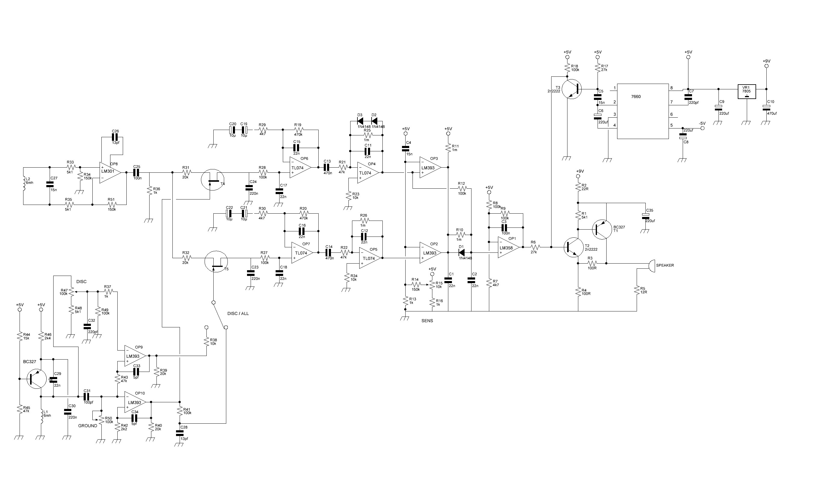

    Schematic is a little hard to read. Any better image available to post.
    What frequency does the TX run at and what are to coil specs.
      I will have to redraw it give me a bit of time it doesn't say the frequency just gives the transmit coil inductance and that is a bit hard to read i would say anywhere around 15khz, my coil was putting out about 50khz on the bench while i was playing around with it and was still showing signs fer rite reject with ground balance and iron discriminate showed signs of working as well but i have to play around with it to bring it down in frequency as i am using a 100mm coil, but picks up a mans ring at about 160mm with that coil. important thing to note is there is a 1meg resistor in parallel with D2 on the board that is not marked on the schematic but you can see it on the photo.

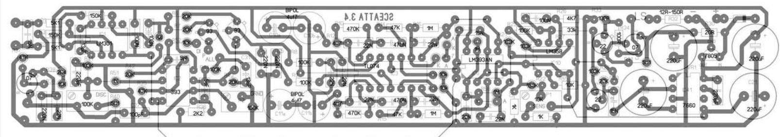

      this is the original parts placement.
      if you want the sprint layout i redrew let me know.

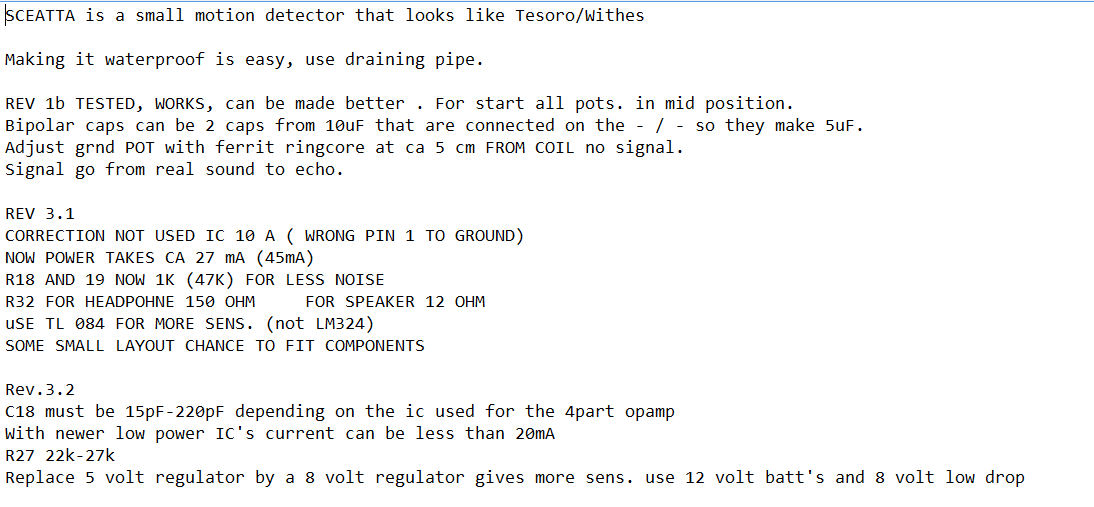

      also just found this info while searching

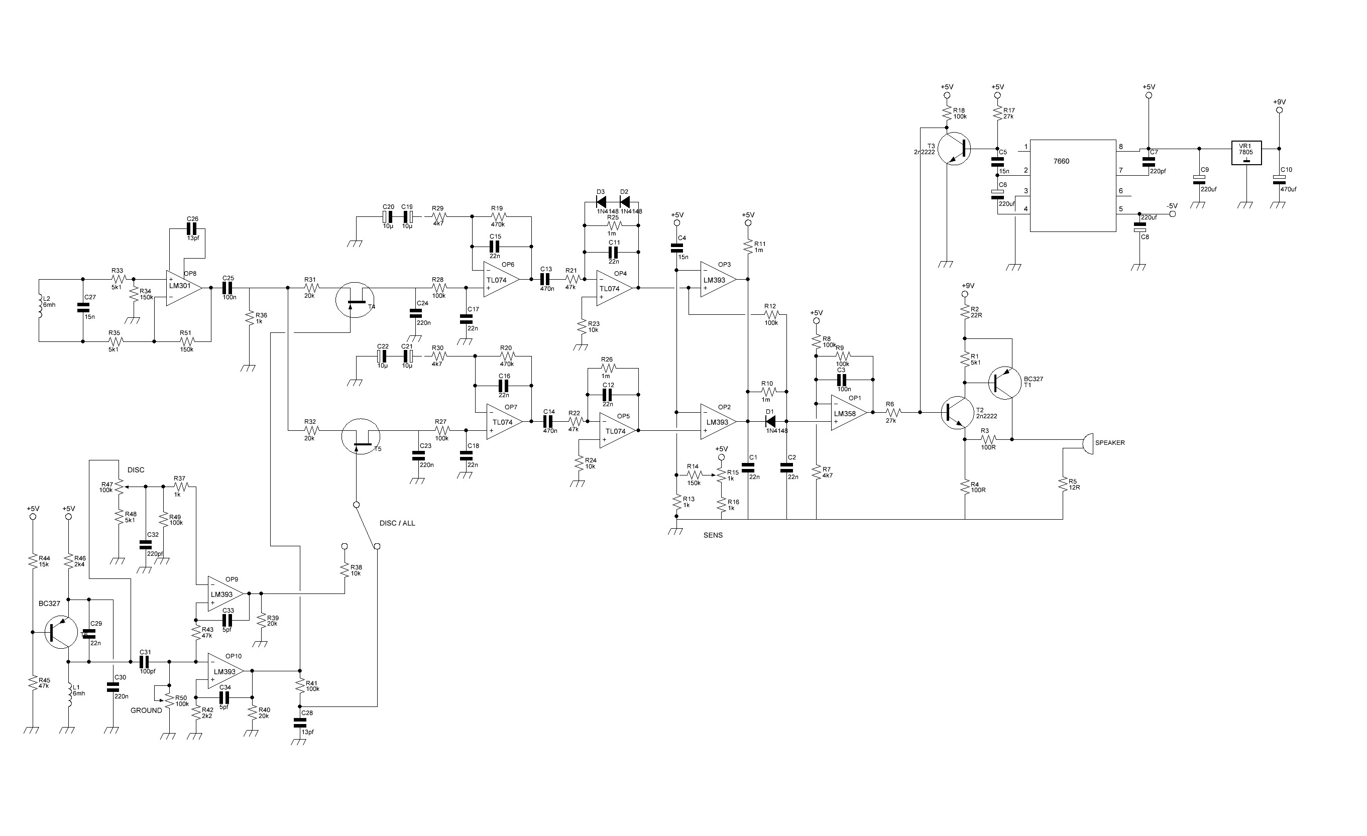

        Here is the redrawn schematic I think it should be right
        correct one others have minor errors.....Click image for larger version

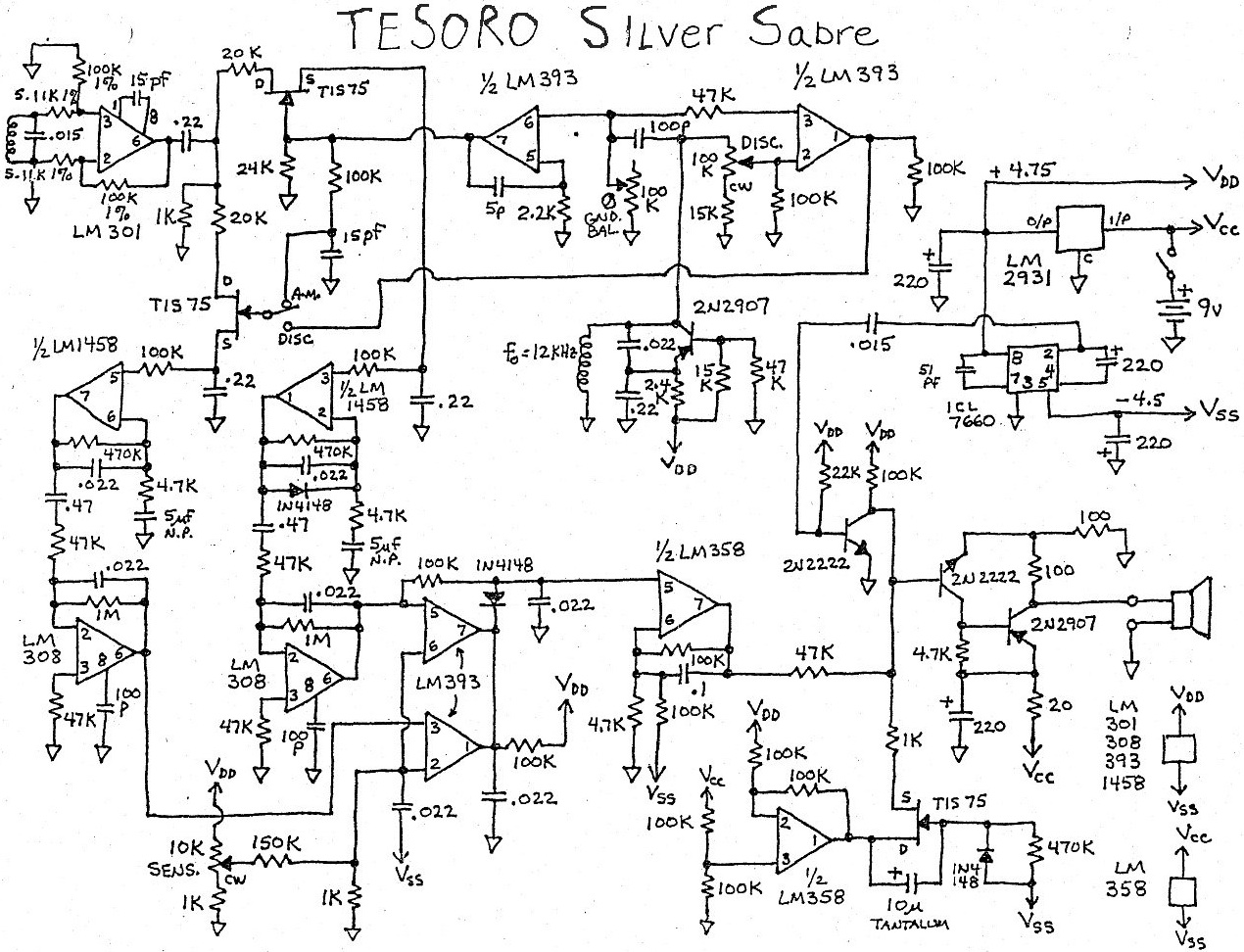

          Can't anyone tell it is a Tesoro?
          Long time seen on this forum already.
          TGSL topic is HUGE and this version is sunk somewhere there.
          If i recall correctly; i got it from Nakky or ApBerg, several years ago.
            to hard to keep track of them all ivconic this version has a nice pcb and does work well
            handy for a small portable unit.
              Yes it is.
              Whatever applies to TGSL; applies to this one too.

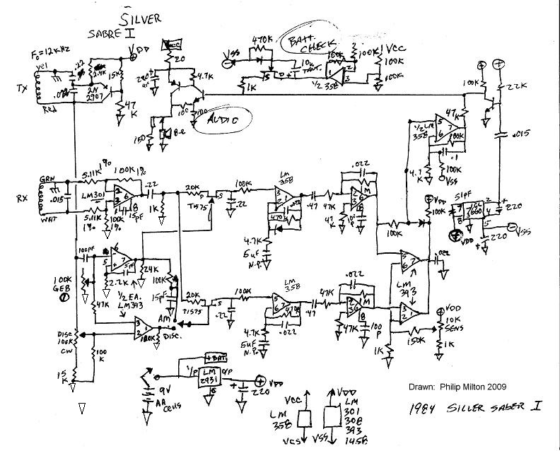

              Since i got it from Nakky or ApBerg; i would call it "Dutch version", although "Sceatta" resembles on Italian.
                "Drawn: Ap".
                So it is ApBerg.
                My memory serves me well after all.
                From time to time...
                  I thought it was very clever the way they used the negative voltage generator to generate the tone as well keep the part count down, that's what caught my eye first and threw me off from working out it was TGSL
                    tesoro pantera-royal sabre-GMT king cobra, amputated certainly to tesoro amigo-compadre. new? not.
                    all you say thats new is long forgotten old. negative voltage generator was to generate TWO tones, in right full schematic.
                    that we call NOTCH FILTER, that was insolently cutted in this 'new light tesoro one'.
                    PS. this is sure tesoro silver sabre I.

                    The Silver Sabre circuit is one of the most successful beeper platforms in this industry. I think it dates to about 1986, and products which are very nearly the same thing are being manufactured today. Admittedly it is not particularly sensitive, but it is easy to build with readily available parts, and has an excellent discriminator.
                    I recommend building it just the way you see it on the schematic, using a purchased Tesoro searchcoil. If you happen to know how, you might want to substitute CMOS switches for the JFETS, which however is not likely to improve performance. If you're using a Tesoro coil of the specified type, I would discourage you from attempting to operate it at a different frequency or using a crystal controlled transmitter: although conceptually easy, there are many potential pitfalls in doing such things, which are not obvious.
                    Attempts to increase the sensitivity of this circuit are likely to either fail, result in only slight improvement, or cause other problems (which may not be obvious at first). If a person is striving for high sensitivity, the Silver Sabre is not a very good foundation for such a quest.
                    If, once you've gotten the circuit to work satisfactorily, you want to play around with it, the easiest thing to do is add simple "features", for instance an external ground balance knob and a switch to disable discrimination.
                      Very nice PCB to stick into PVC pipe housing. Niced job dom44.
                      This is obviously a tesoro circuit. The TGS/royal sabre are very good detectors as far as sensititvity is concerned. This circuit is a stripdown of those. So performance will be comparable, if you can source a stock coil, even better.
                      The best part about this circuit is the long board layout. I love it.
