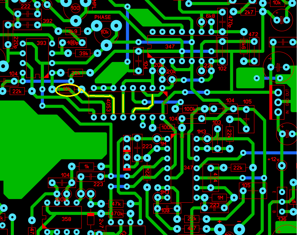

          • Hello Iconic good work for the contribution of the SMW.
            I am just getting started on this MD and I am mounting all the components on the PCB; but I would like to ask you several questions regarding the latest publication of the PCB.

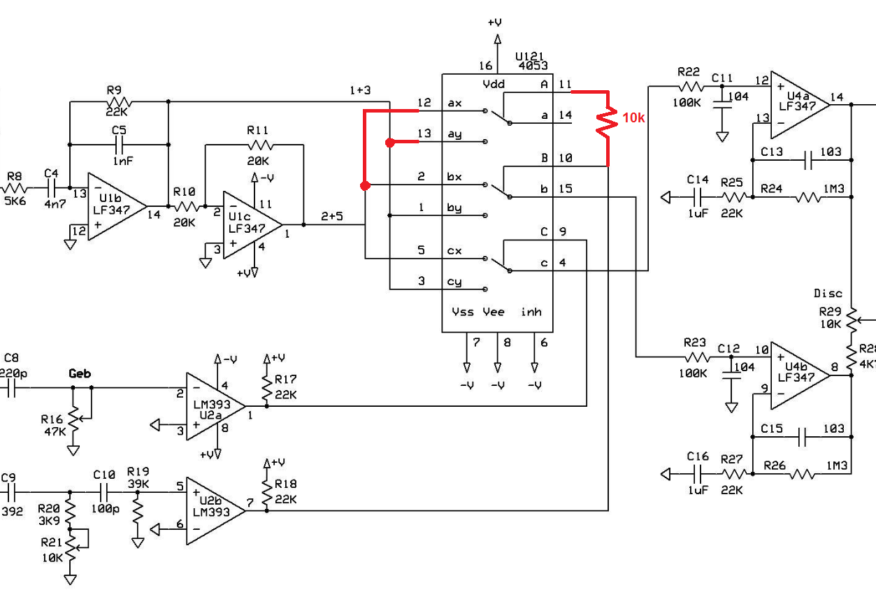

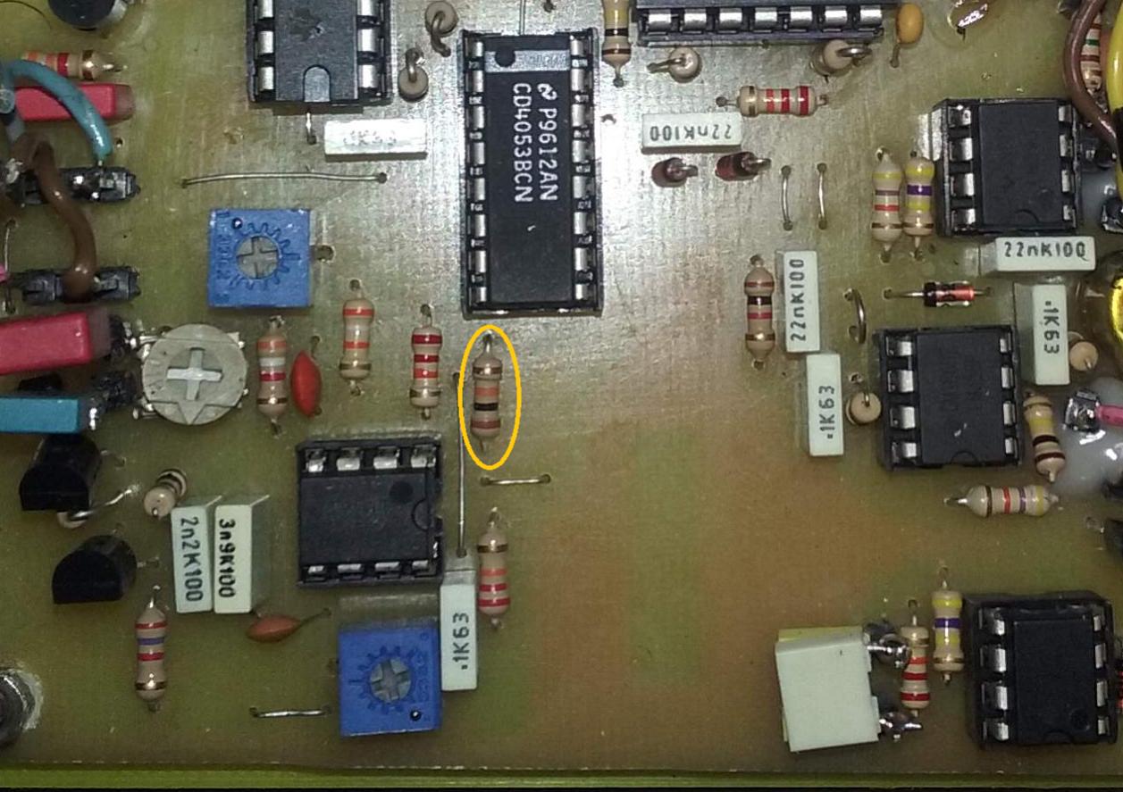

            • First I would like to know why you added this resistor and the connections?Click image for larger version

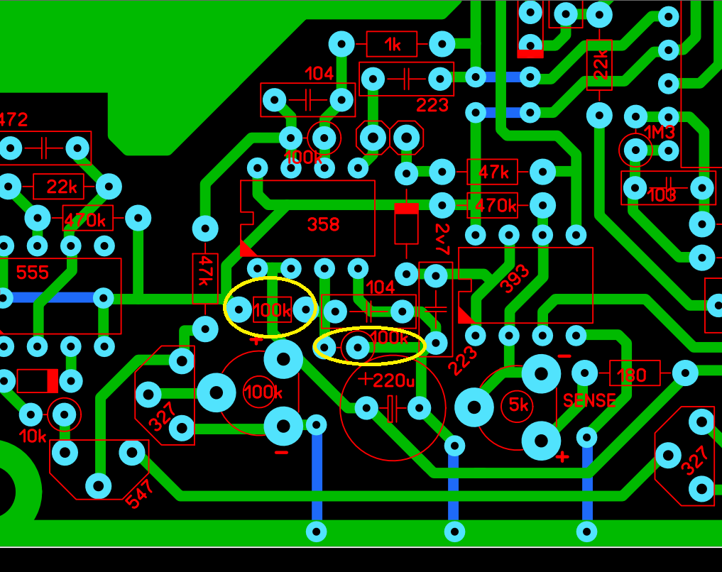

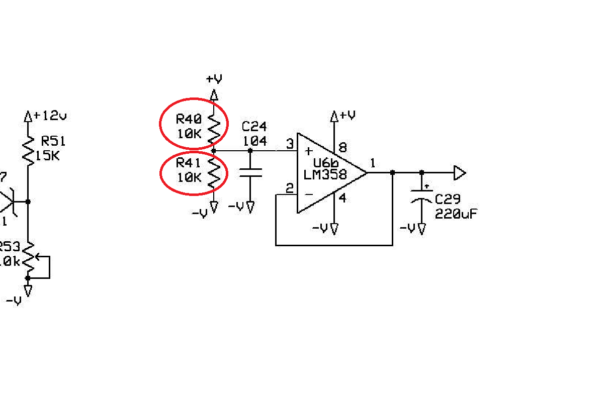

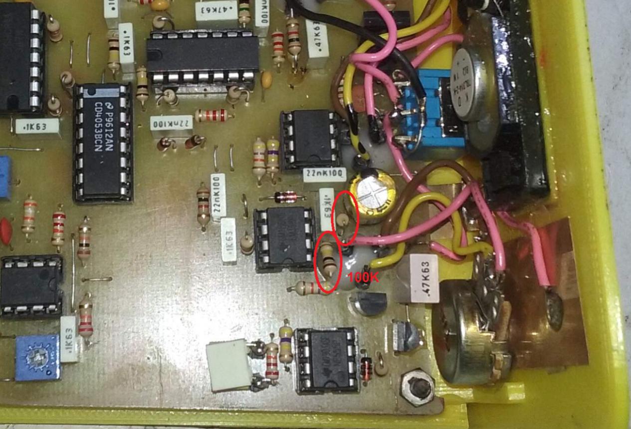

              • Second, on its PCB and on the Lay I put two 100K resistors but in the diagram they are 10K.Click image for larger version
