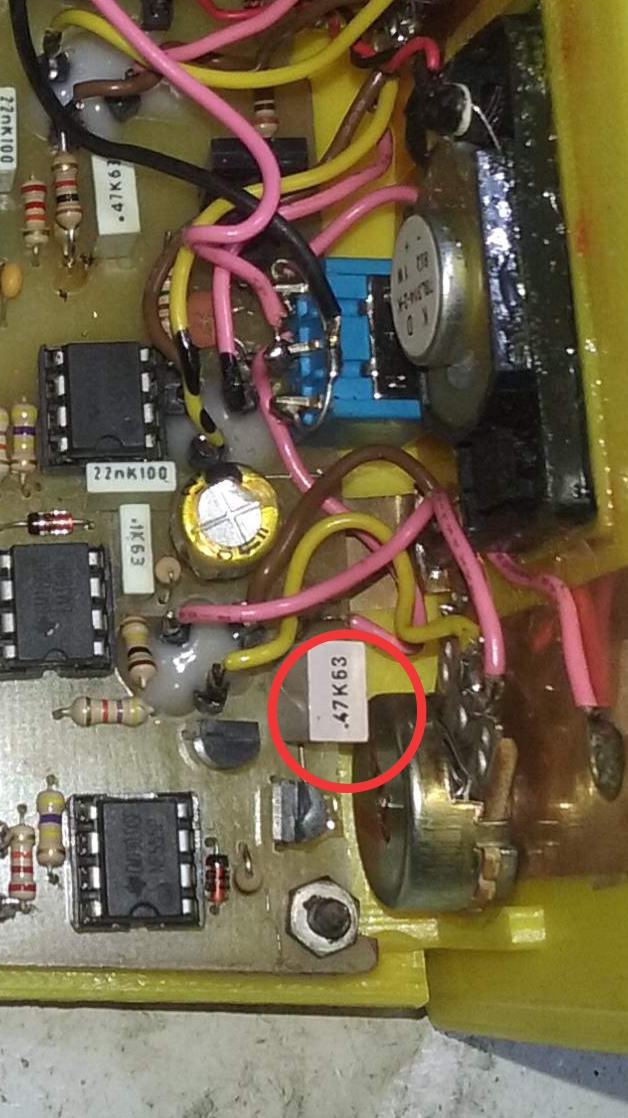

          Hi ivconic
          C30 in circuit brings up the "bell tone", similar as at Garret's. Very effective at some type of targets. ?
          1)
          What is C30 capacitor value
          2)can you mark it on the c30 pcb
          Best regards
          • It is 0.47uf

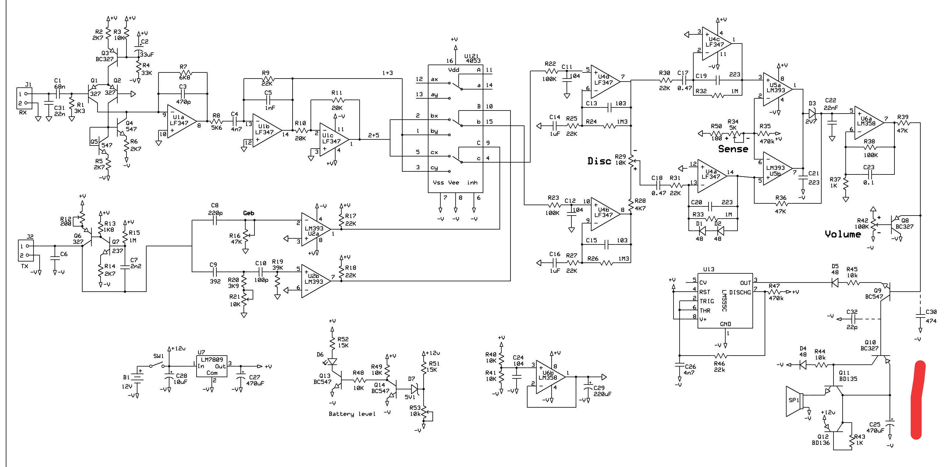

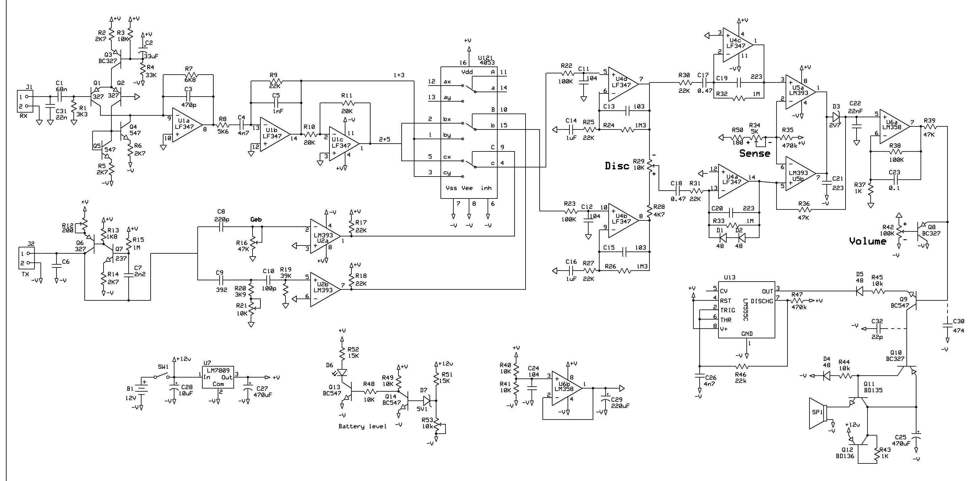

            • Look at shema
              • Hi,
                ib detectors tx high rx low frequency
                we know as.
                smw detector is just the opposite, rx high tx low
                Is this true?.
                Or did I get it wrong?
                also what is the net coil information capacitor information of this circuit.
                Best regards
