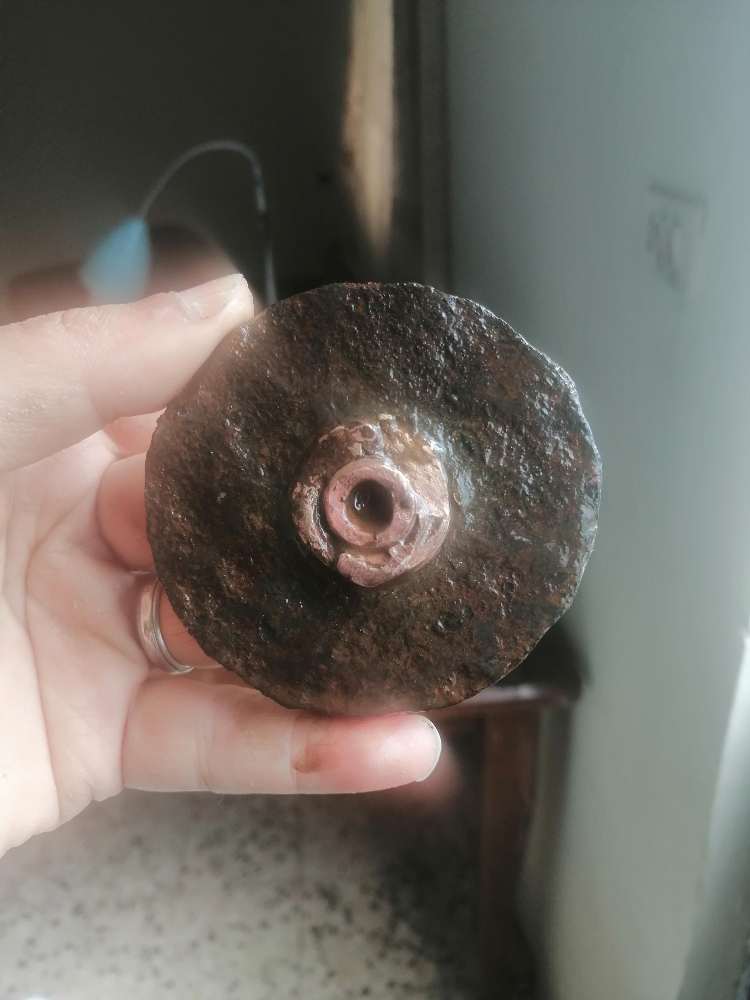

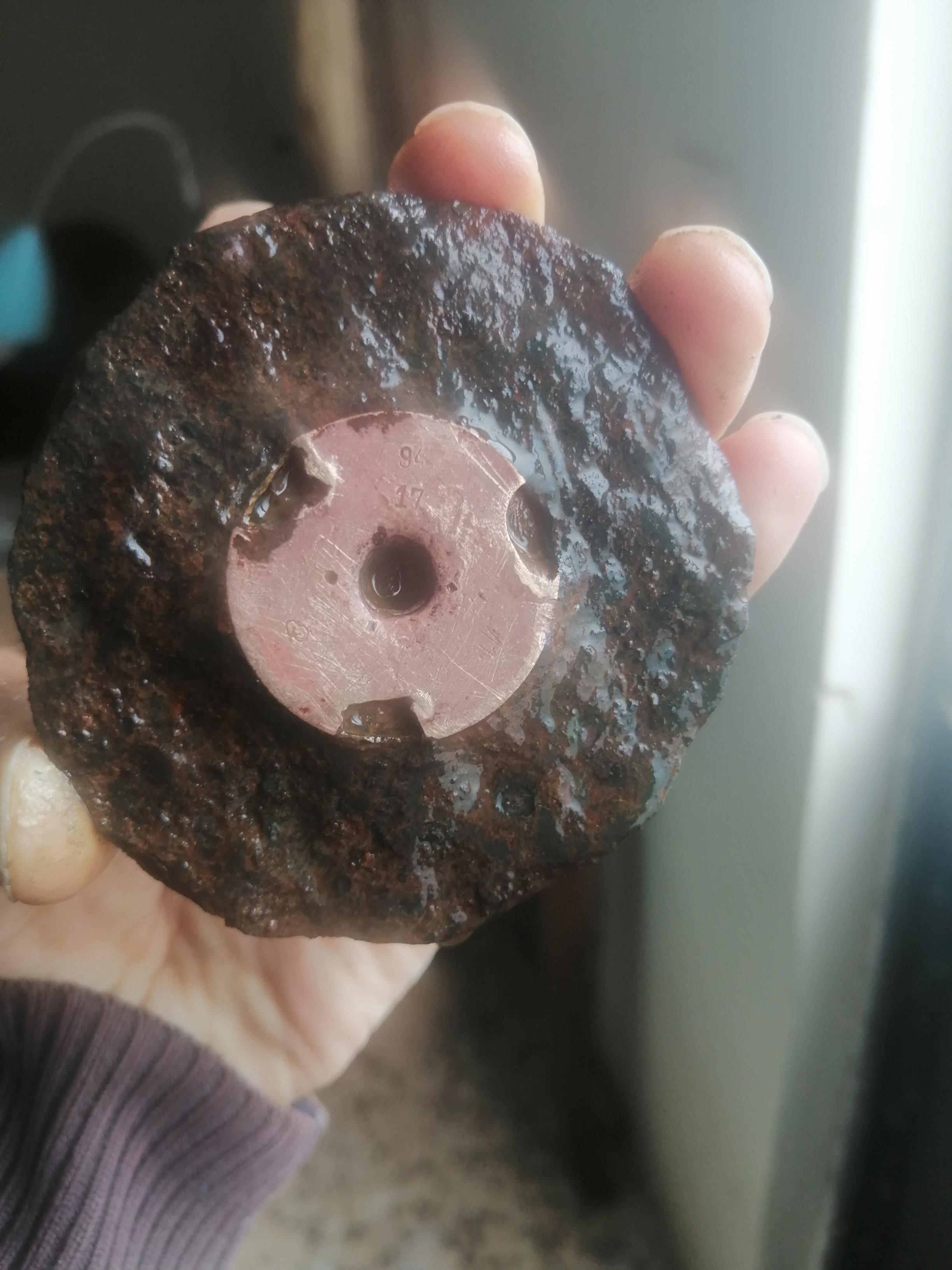

                      First hunt with Smw 25cm in the ground
                      I don't know what it's look like a mine

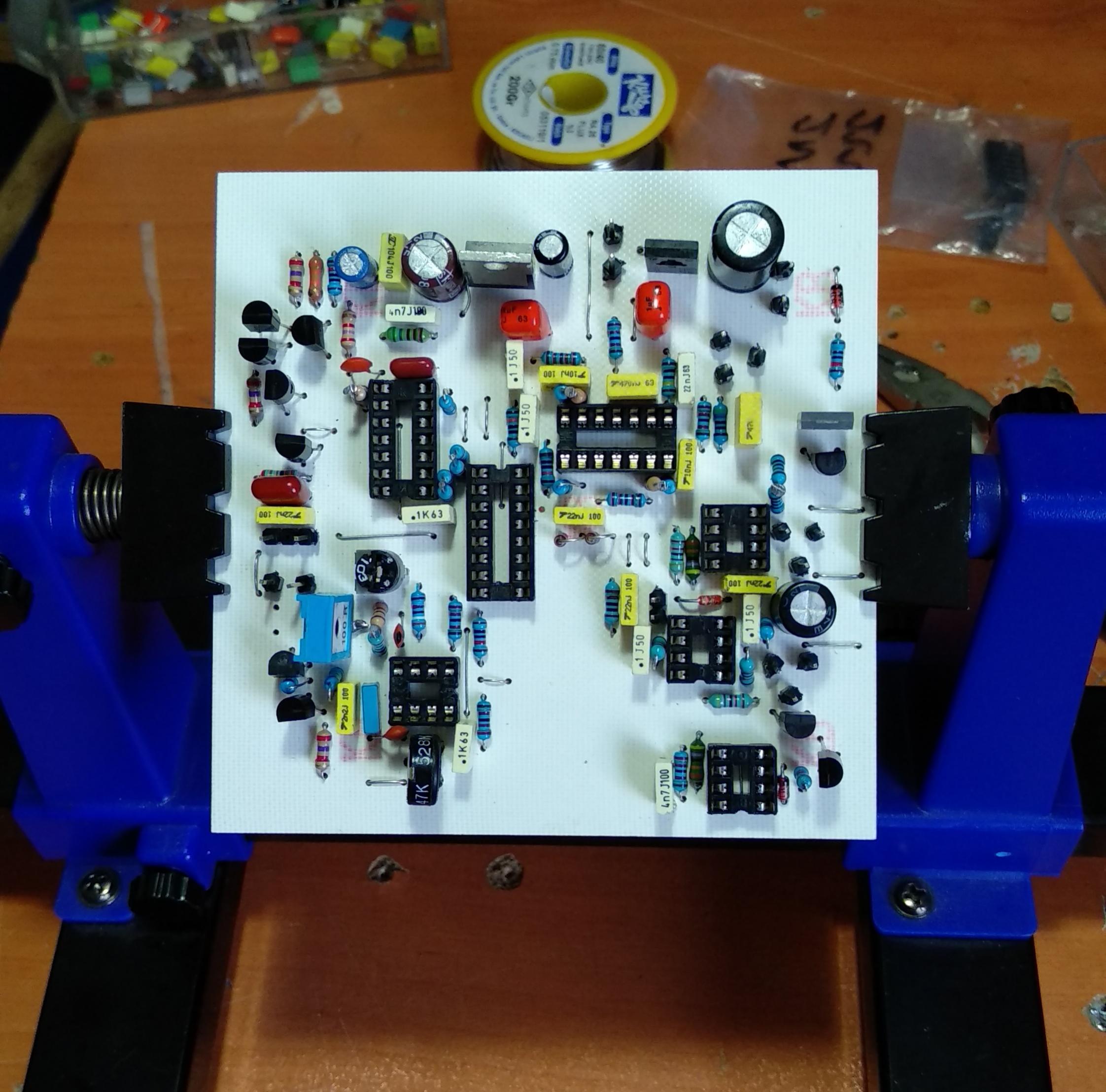

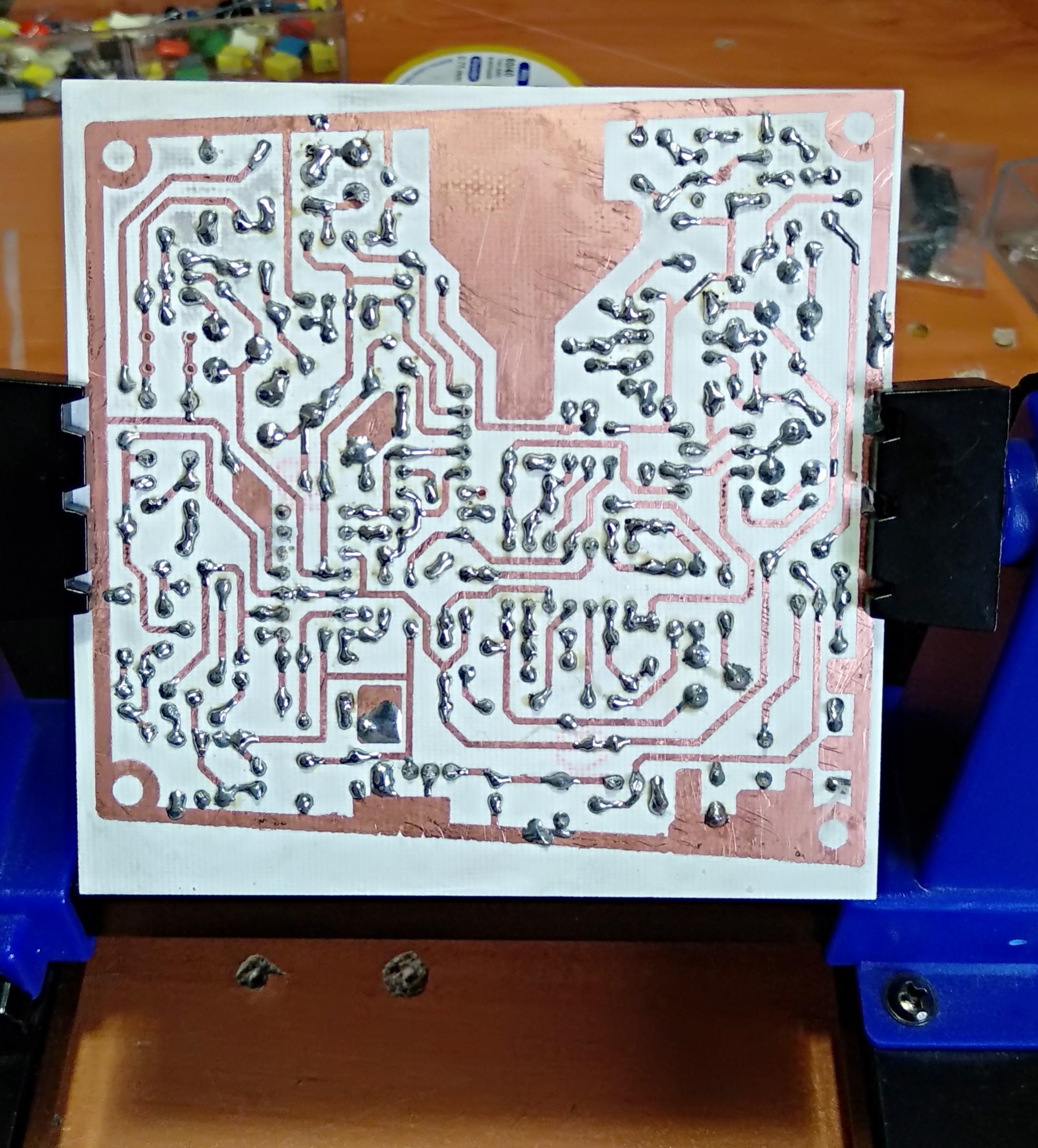

                        • SMW
                          Hi
                          pcb ready for testin
                          • Originally posted by gurdal View Post
                            Hi
                            Nice gurdal
