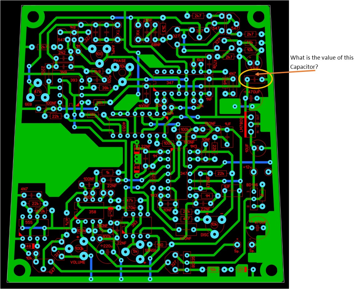

        C30 and C32 are not present on pcb draw.
        Those are optional.
        Try them, if you like them; keep them.

          Hiya Ivconic,,,Thanks for sharing the SMW layout,,,Could you let us know the Coil Data for this pcb please and Frequency,,Thanks in advance. Regards, Marty.
          • #80
            Hiya all,,,Thanks again Ivconic for the SMW Layout,,,,Can anyone tell me the value of the Capacitor in the picture please? I've been Looking forward to making this S.M.W for a couple of years now for my collection,,Also, if anyone knows the TX and RX frequencies so I can have a go at making the coils,,,Much appreciated, Regards,,,Marty.
            • #81
              Coil specs close to specs of Minelab TS1000 coil.
              1mH TX and 15mH RX.
              Although SMW is tolerant and can be trimmed also with bit different coil specs too.
              Frequency can be 6 to 8kHz.
              Capacitor is 100nF.

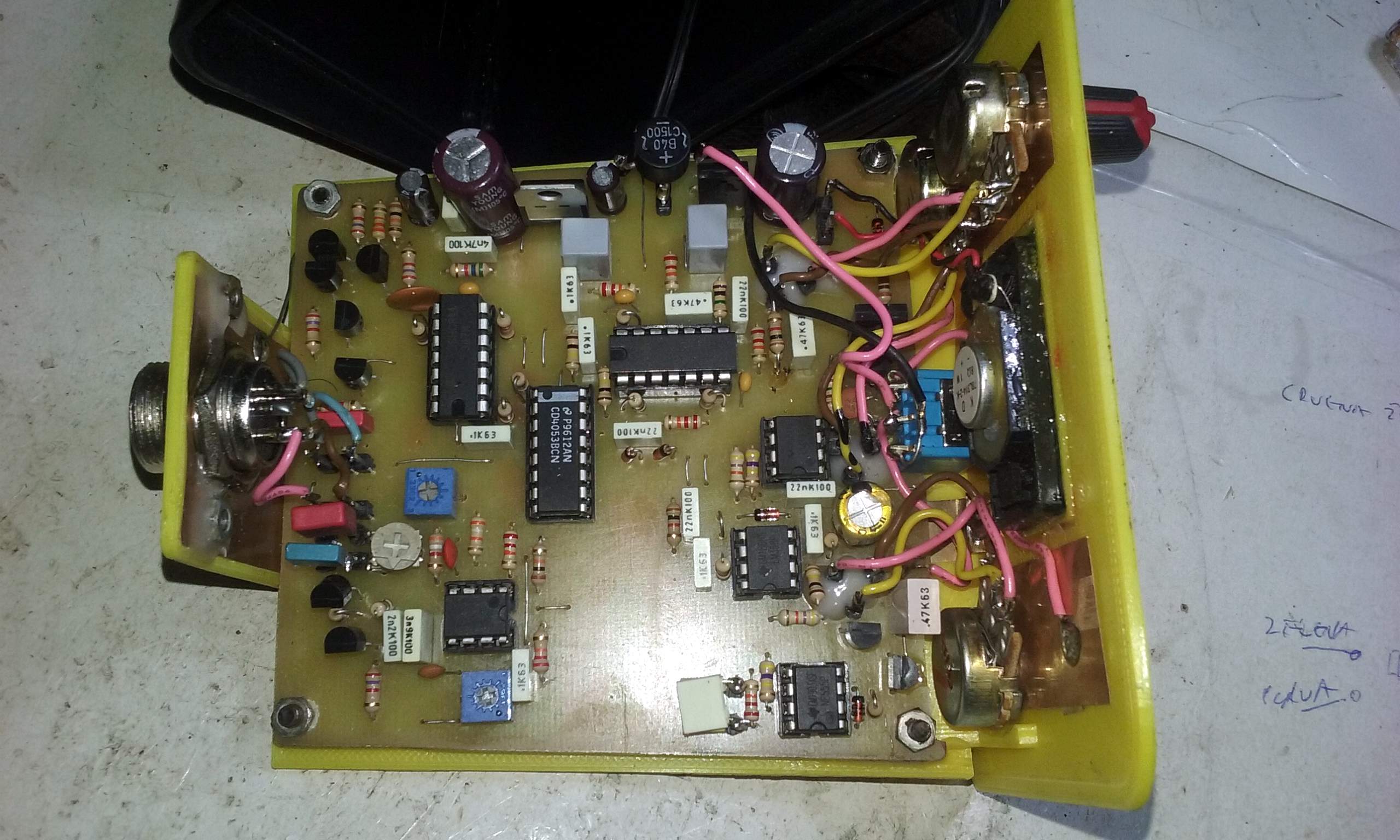

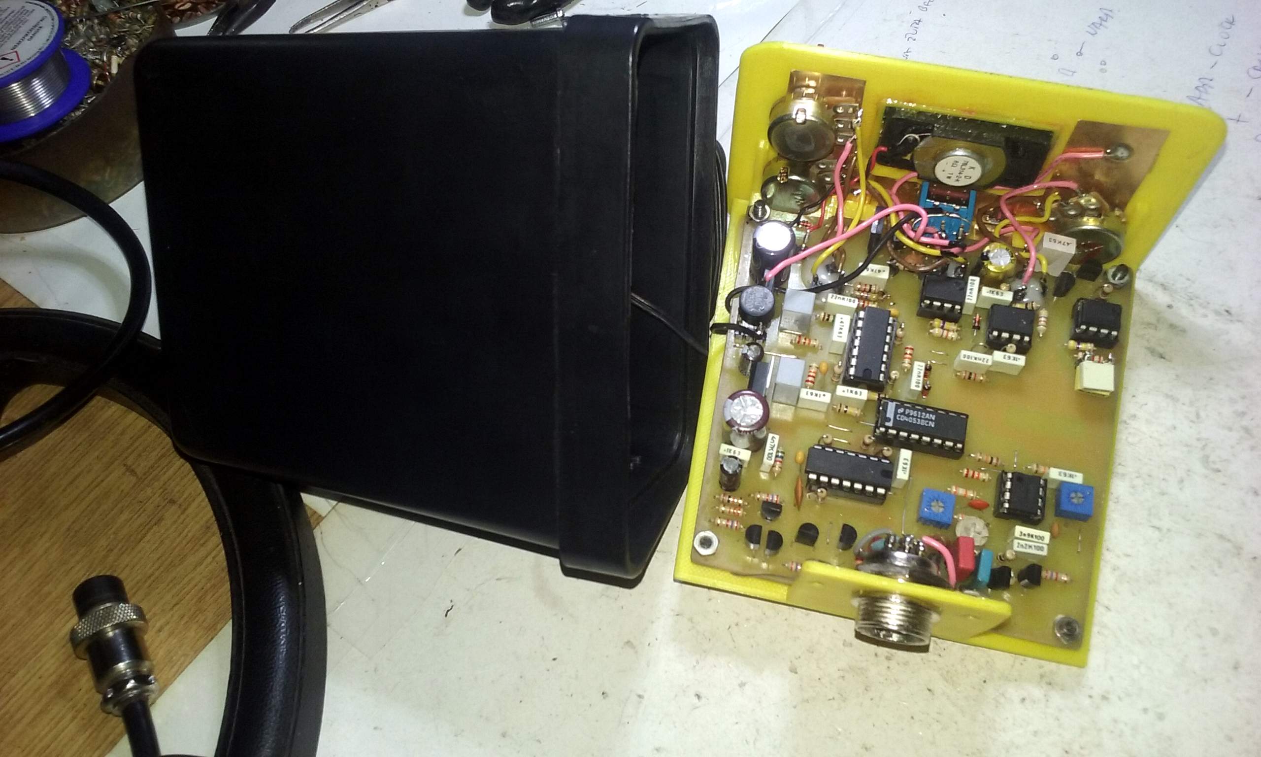

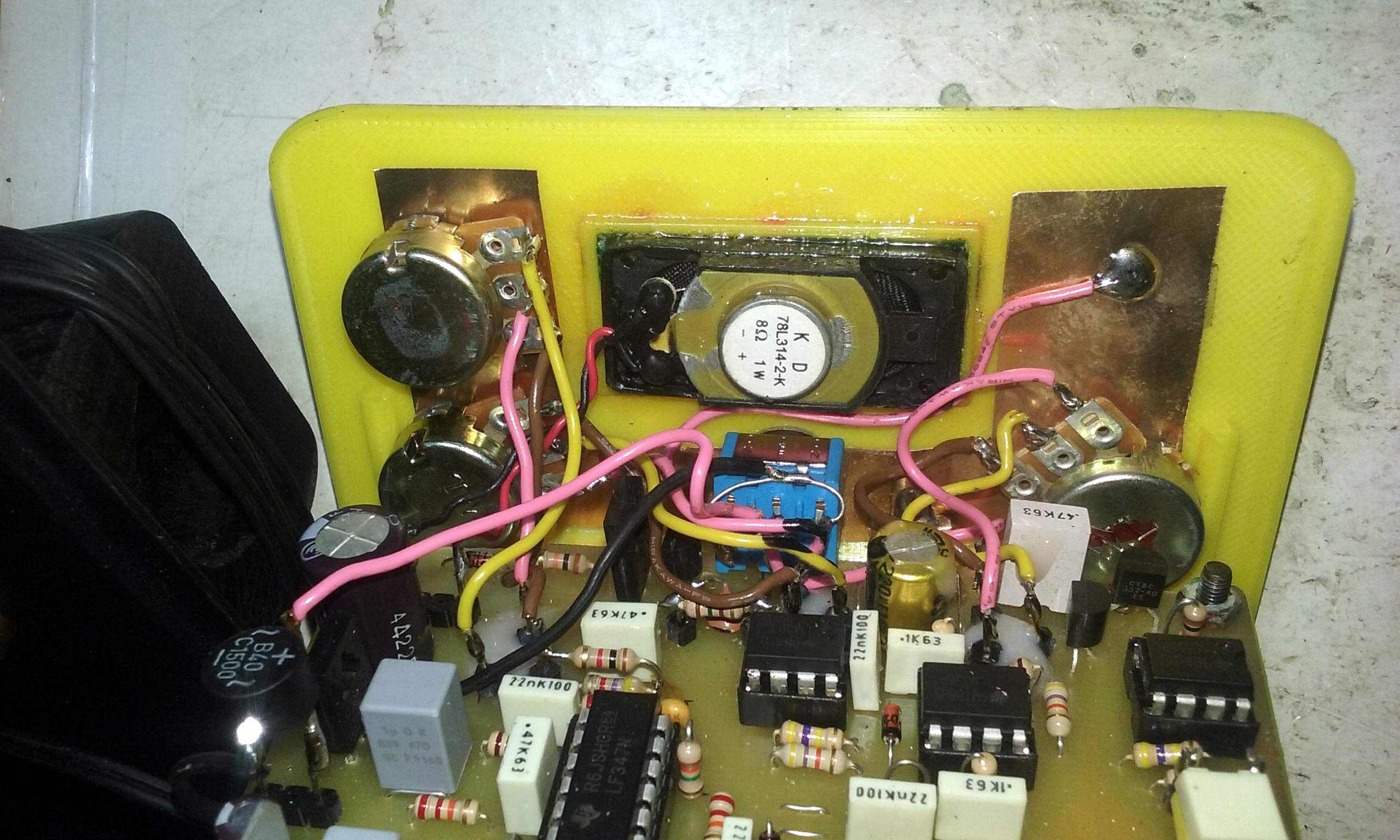

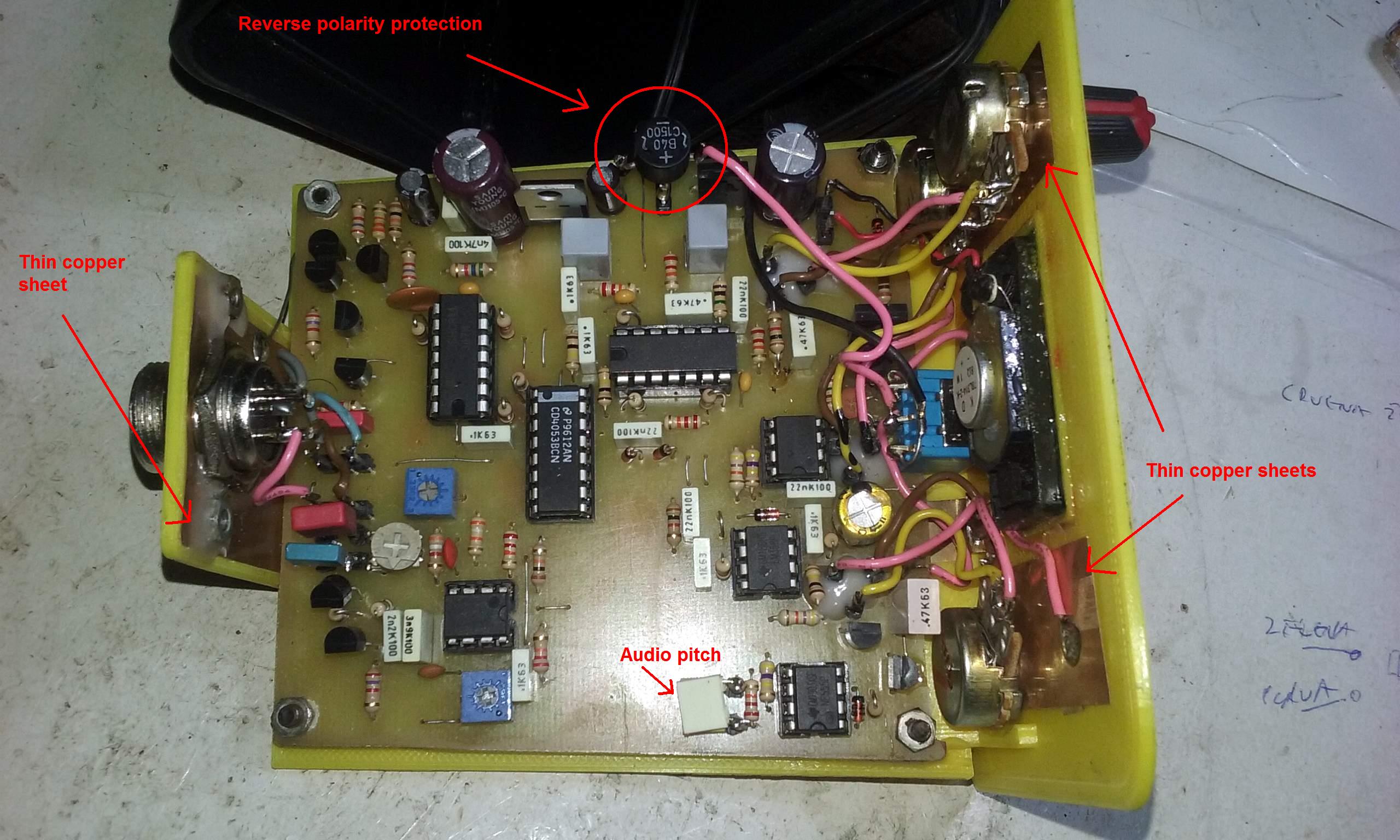

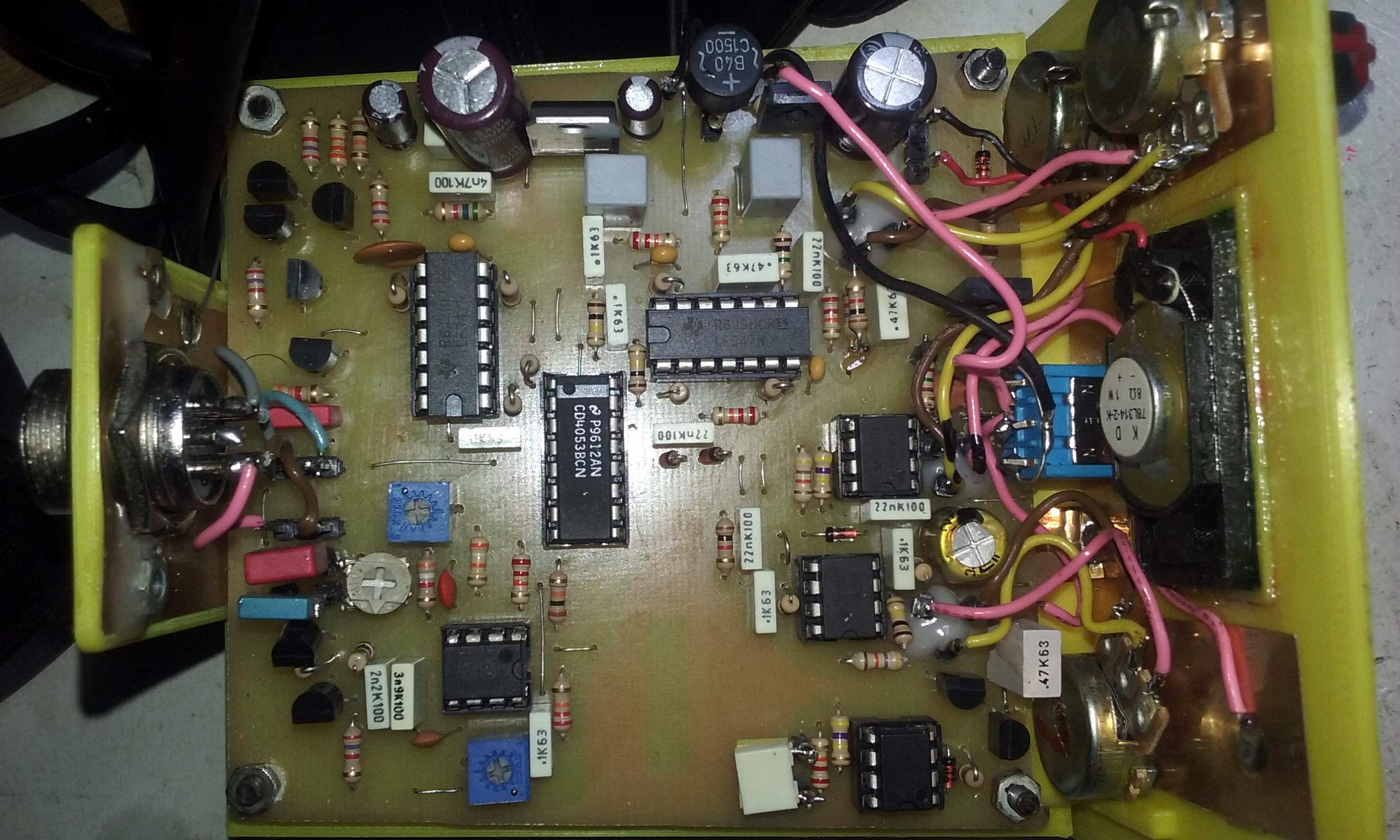

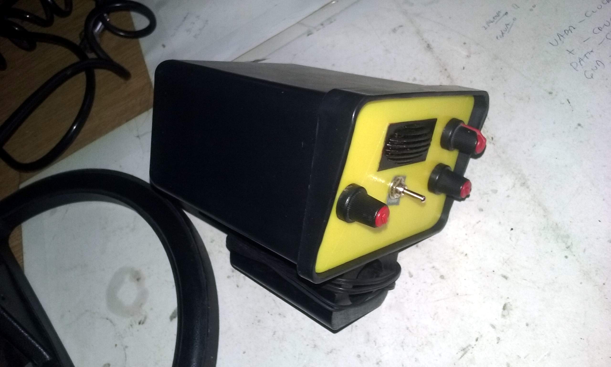

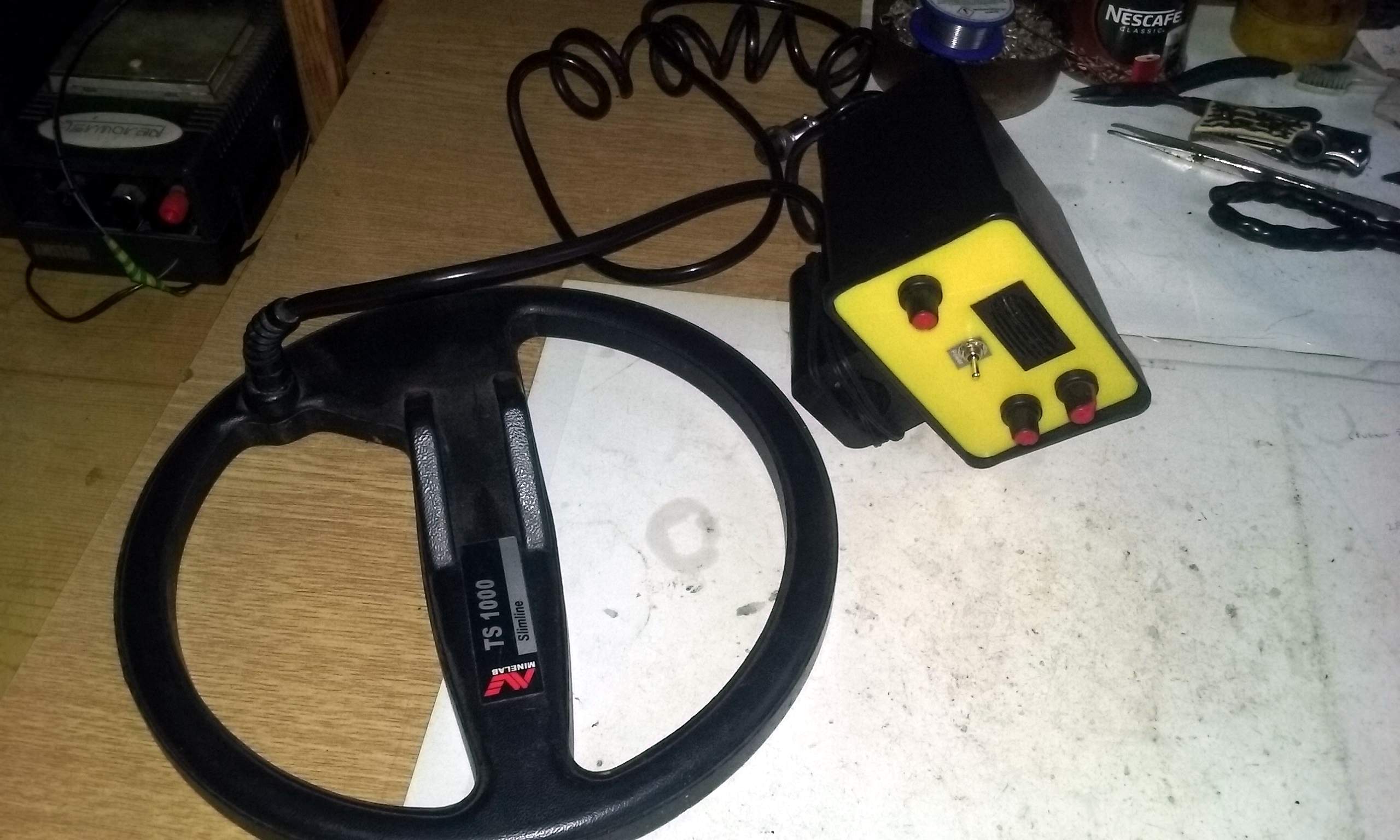

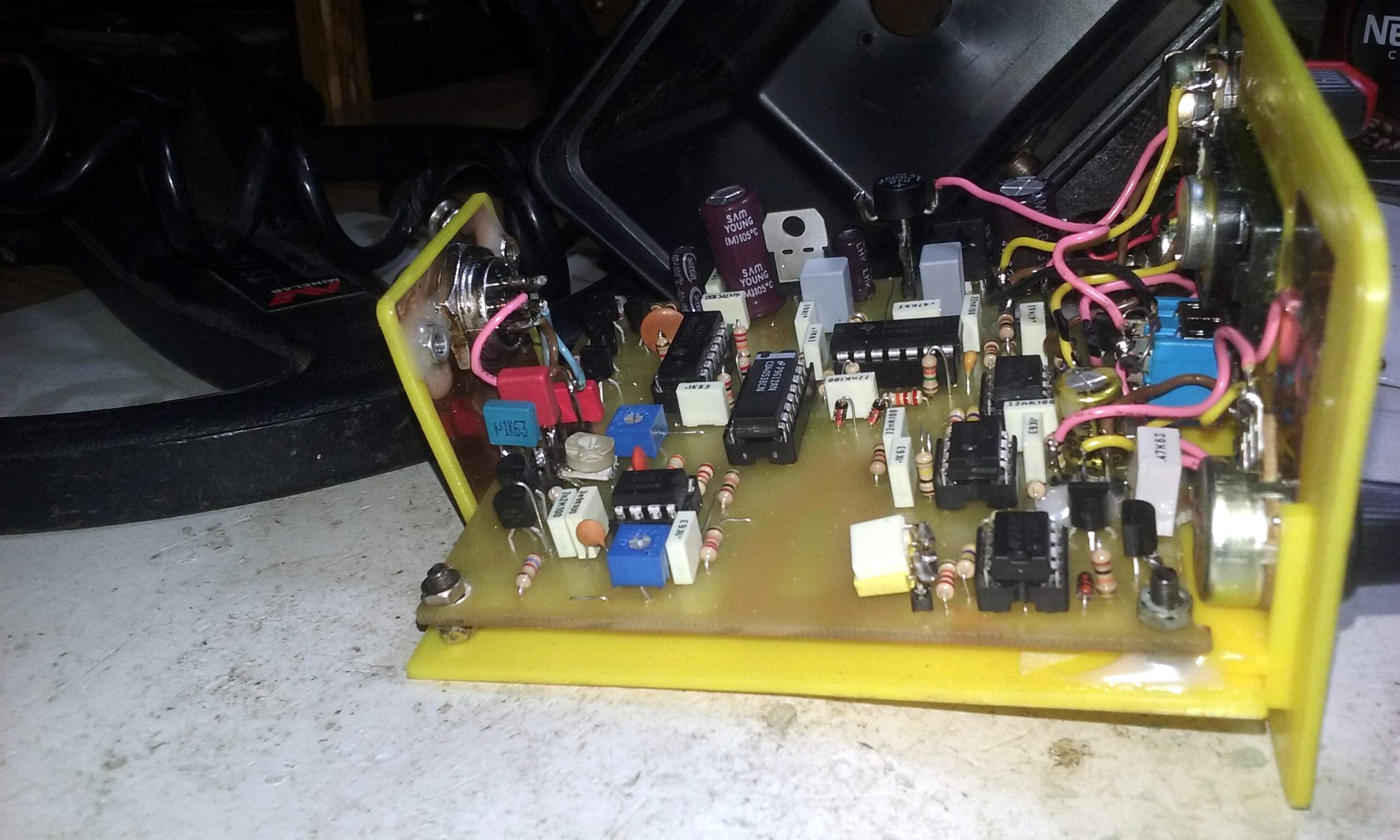

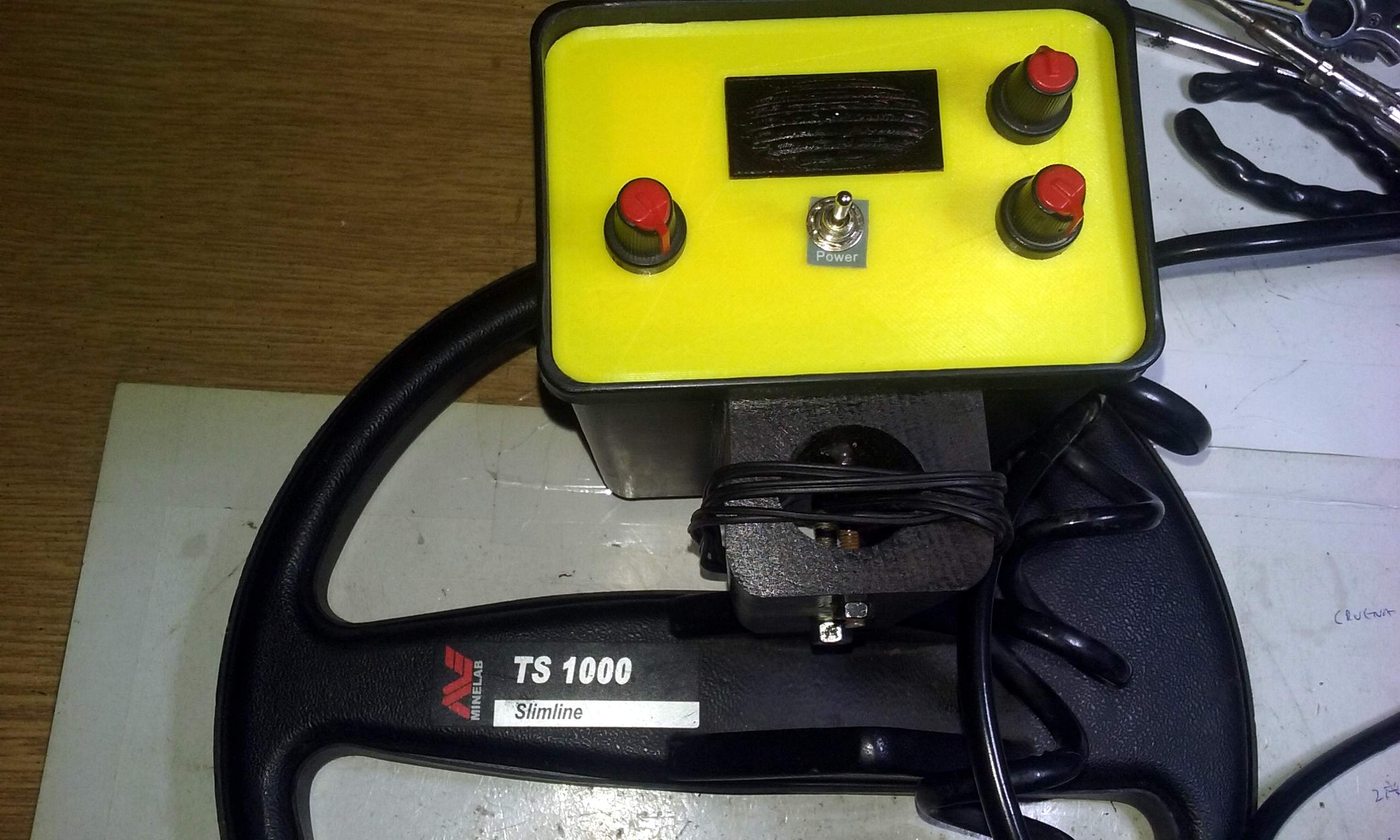

                After so many years i am still making SMW, every once in a while, whenever i have chance to obtain TS coil (rare lately), since i am to lazy to make diy coil anymore. Pretty fed up of that labor.
                So i finished this one last week. It is working "by the book", excellent, indeed deep and sharp!
                I had extra housing, laying in a drawer for long time, so i draw pcb to match that housing.

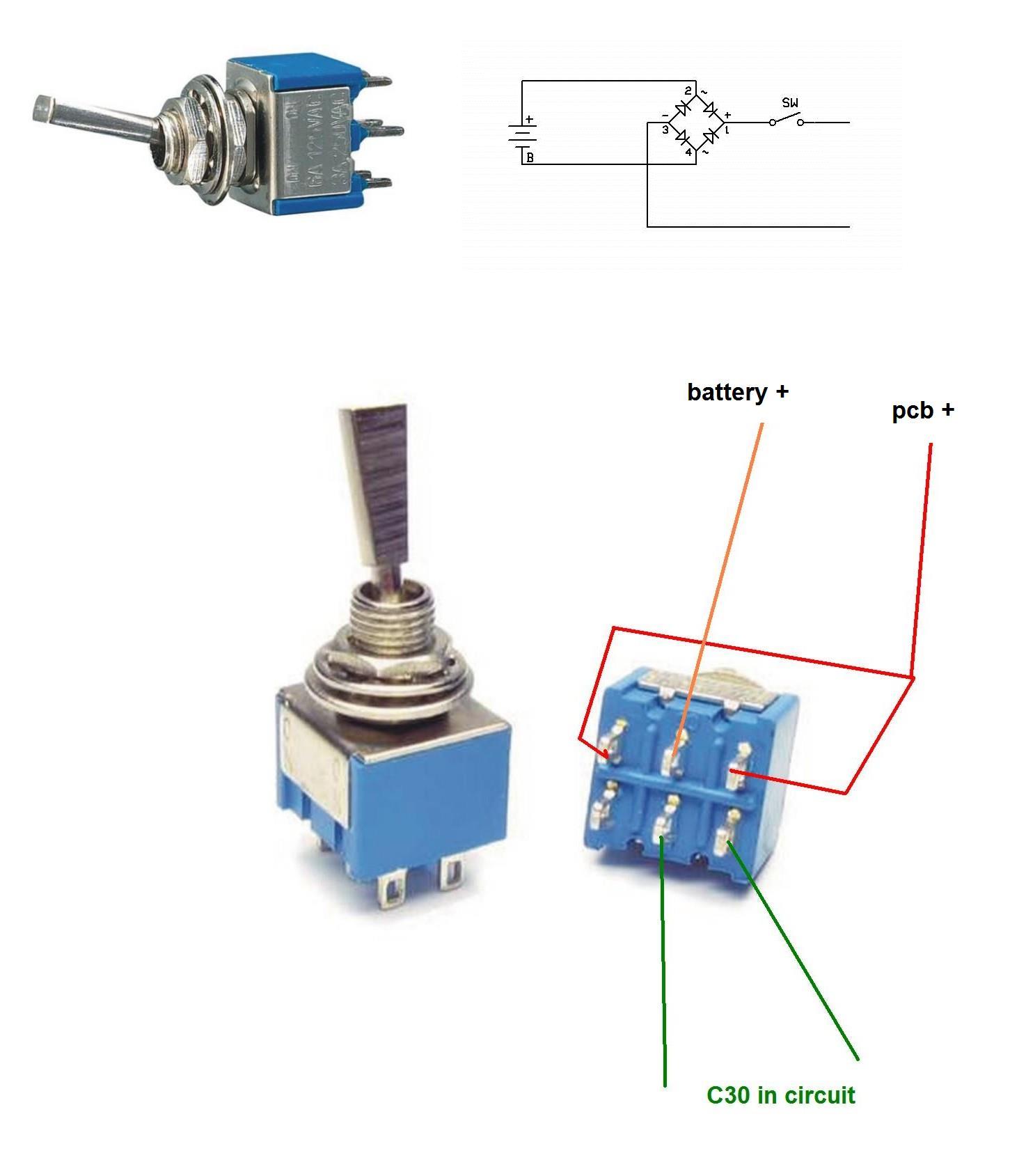

                • #83
                  Additional infos,
                  i used toggle switch 2x3 with center position neutral, to switch ON the detector either with C30 in circuit, either C30 out of circuit.
                  C30 in circuit brings up the "bell tone", similar as at Garret's. Very effective at some type of targets.
                  Saves me from using another switch for tone option.
                  Also there is a diode bridge acting as battery reverse polarity protection.
                  This is particular case, not general, since i made this detector for one friend who is often careless and already burned several detectors with reversing the polarity at 12v/1.3A battery.
                  So i had to figure out how to prevent that.
                  Ok, there is small and insignificant voltage drop at bridge... not presenting any problem and not affecting detector behavior at all.
