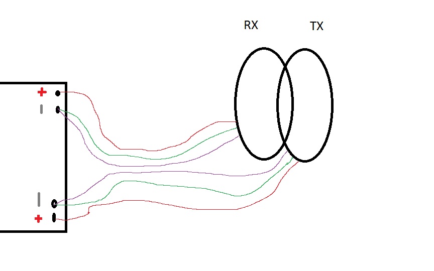

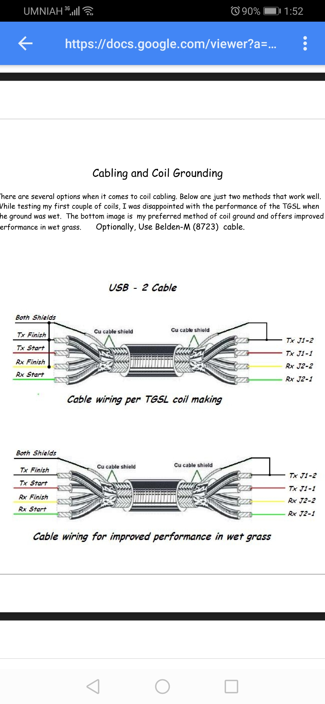

    Please can you explain what's best to connect shield between dd coil and what difference between three images and what suitable for SMW

        Originally posted by Hach View Post
        [ATTACH]49395[/ATTACH][ATTACH]49396[/ATTACH]
        That's for TGSL coil.
        SMW needs different setup.
        Since Minelab TS1000 coil works splendid with SMW; best way to make diy coil is to copy what's done on TS1000.
        It is the two separate coaxial in common pvc (silicone) coating.
        Coil shielding goes to TX coaxial shielding and further to minus rail on pcb.
        It's the best cable for SMW.
        Similar (actually the same) cable is present now days at XP coils.
        So it is "double coaxial". Don't know better term for it.

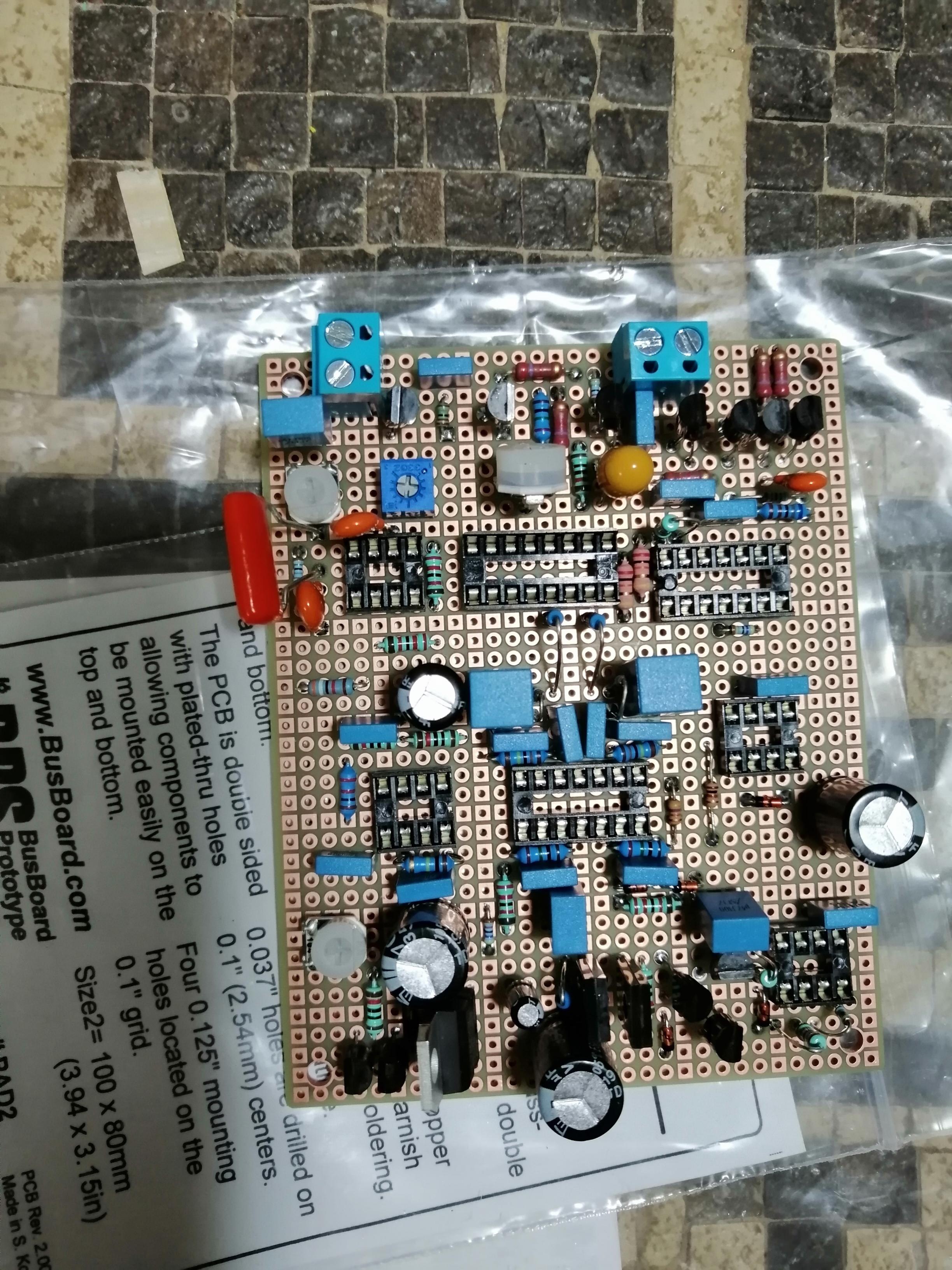

          Hello guys . My pcb is half populated. But I have such a question. The picture above shows the finished PCB, there is 1 extra capacitor 470nf and one 22nf is missing. What is the case with them? Are there any other changes? What is the correct position of the three POT resistor 100 , 10k , 47k ? Thanks for the replies.

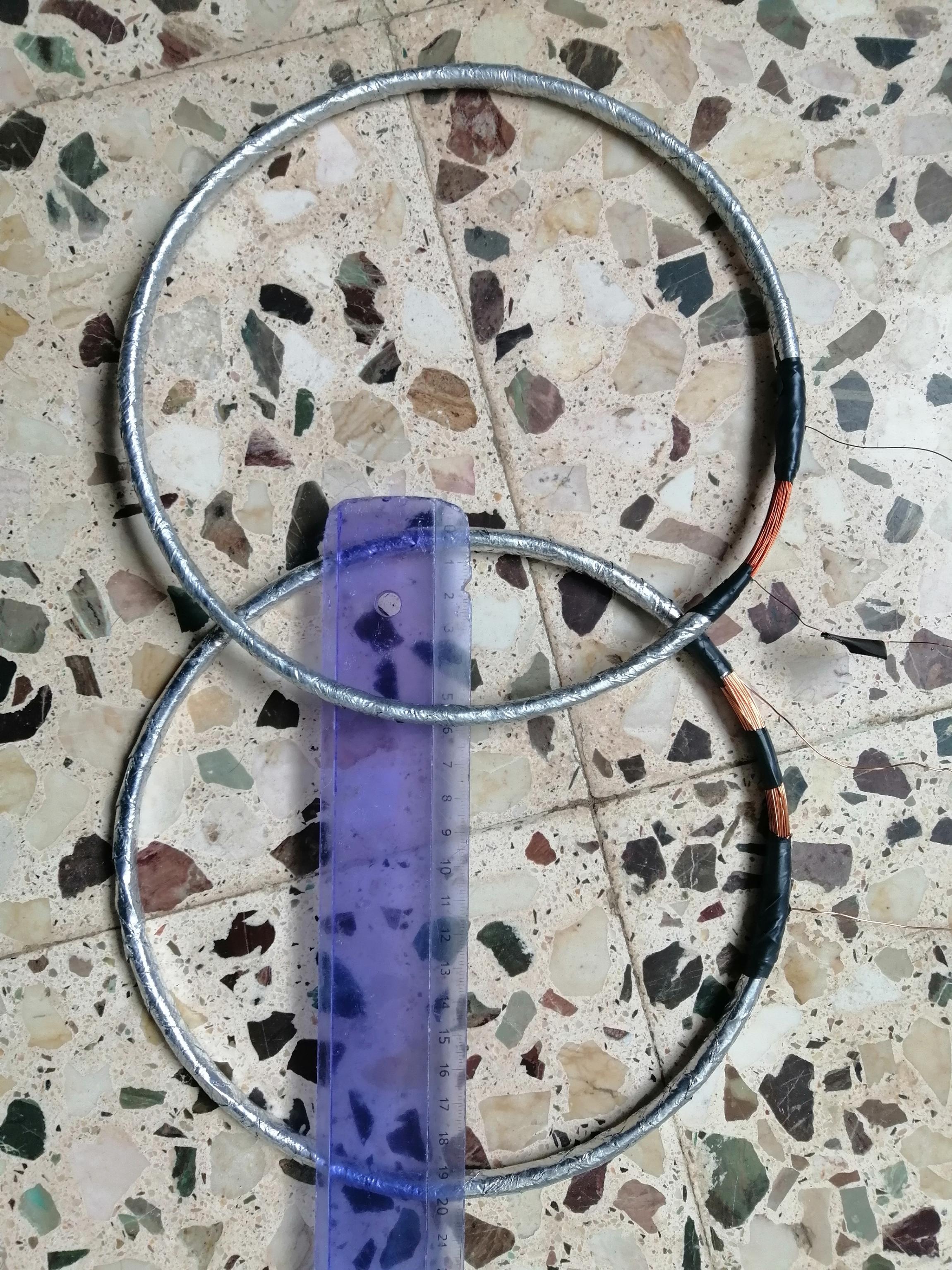

            I made these two coil attached in pic
            TX 75 turn resistance 4.2ohom 20cm wire diameter 0.5mm
            I shield it with aluminum extracted from satellite cable.
            Rx 170 turn resistance 30.5ohom 20cm wire diameter 0.3mm
            Dos it work with Smw? Click image for larger version

            • #96
              Dos it work with Smw? [ATTACH]49402[/ATTACH]
              Inductances?
              On your place i would try to trim TX parallel capacitor to get ~7kHz.
              The rest is just to null the coil.

                • #98
                  Hi
                  Alu-foils can't ouch each other!!! Wrap isolating band all over the coils.

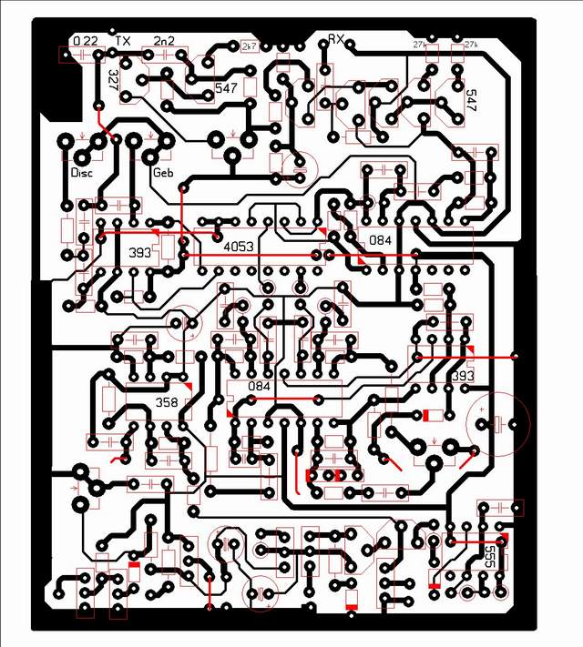

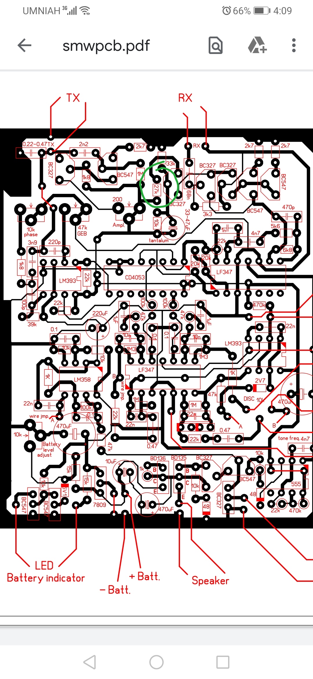

                    Hello the green spot in attached image
                    Is it 27kohom or 2.7kohom?!
                    • Also r20 is it 3.9k or 39k
                      Its not same in schema and pdf pcb!?
                      • Originally posted by Hach View Post
                        Sorry I mean in schema 3.9k in pcb 1.8k!!
                        Which one correct?
                          Which one correct?
                          That's good question.
                          Differences are due possibility to use various coils with it.
                          Both are correct, since you'll have to check both and see which one is giving you better behavior.
                          First obey what you see on pcb, those values.
                          Than when you test detector with coil, checking Disc, GEB ... you'll see if you need to correct that resistor.
                          So, obey the pcb values , from pcb draw you posted.
                            [ATTACH]49422[/ATTACH]
                            It is 27k as noted.

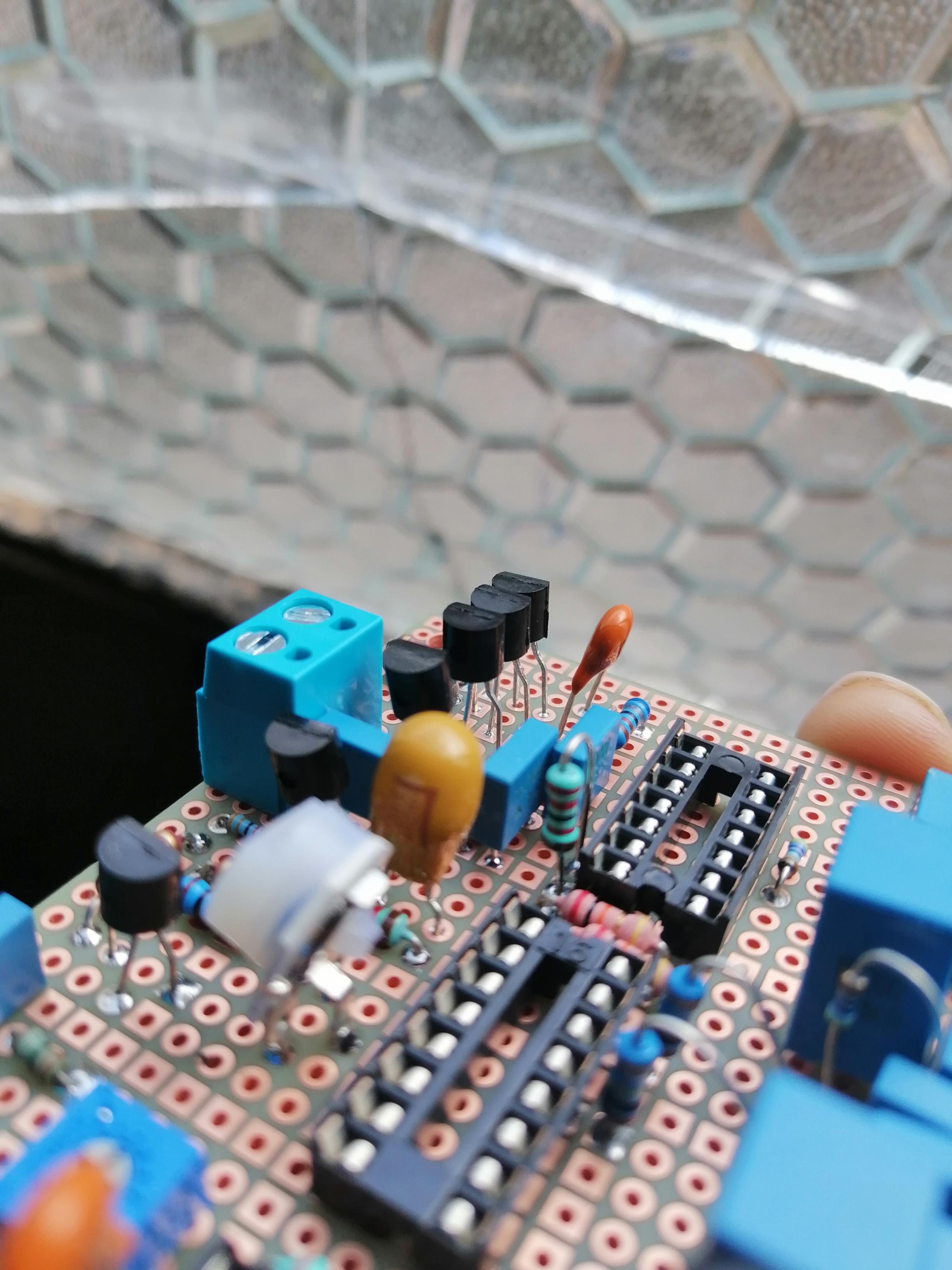

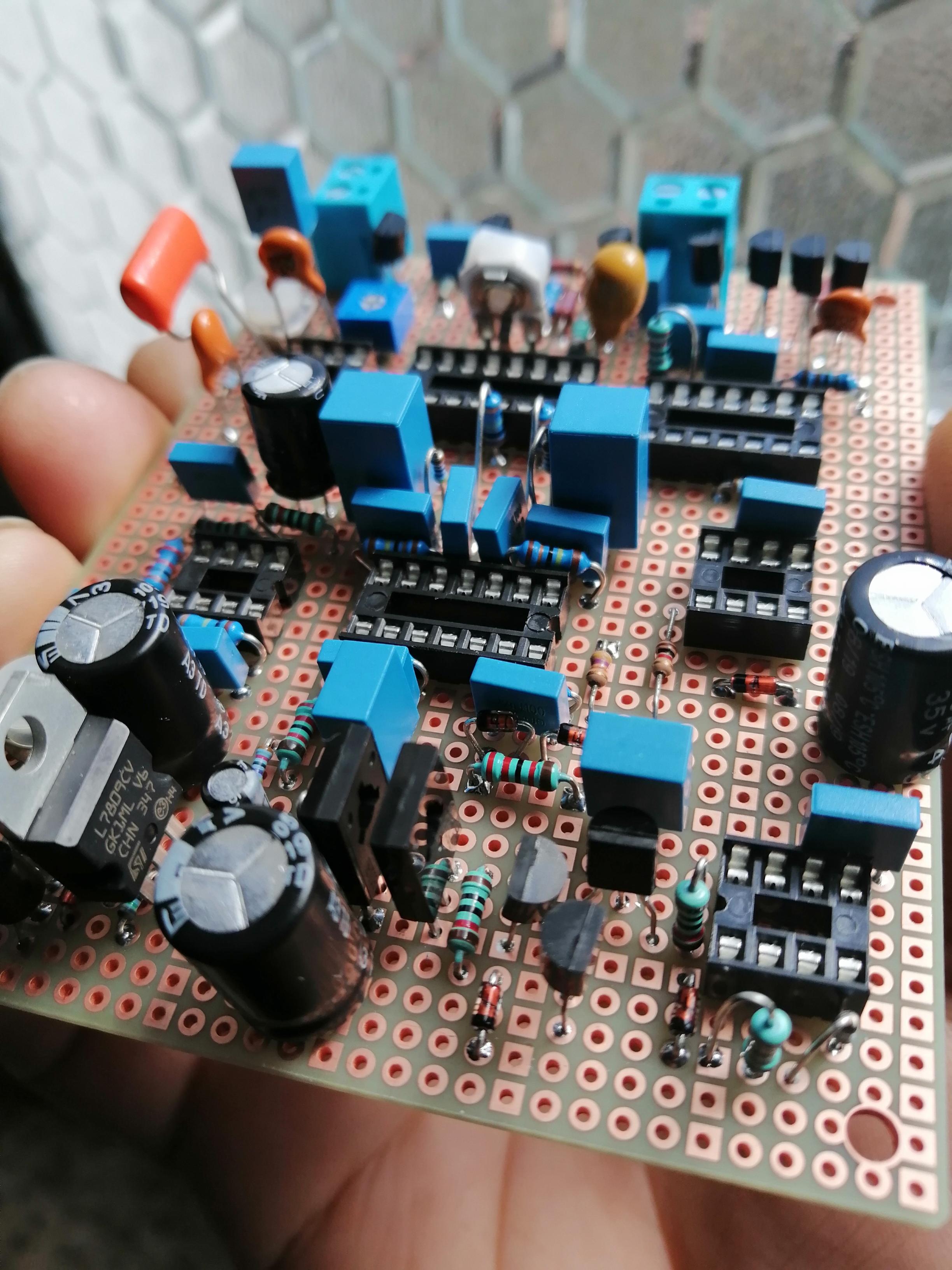

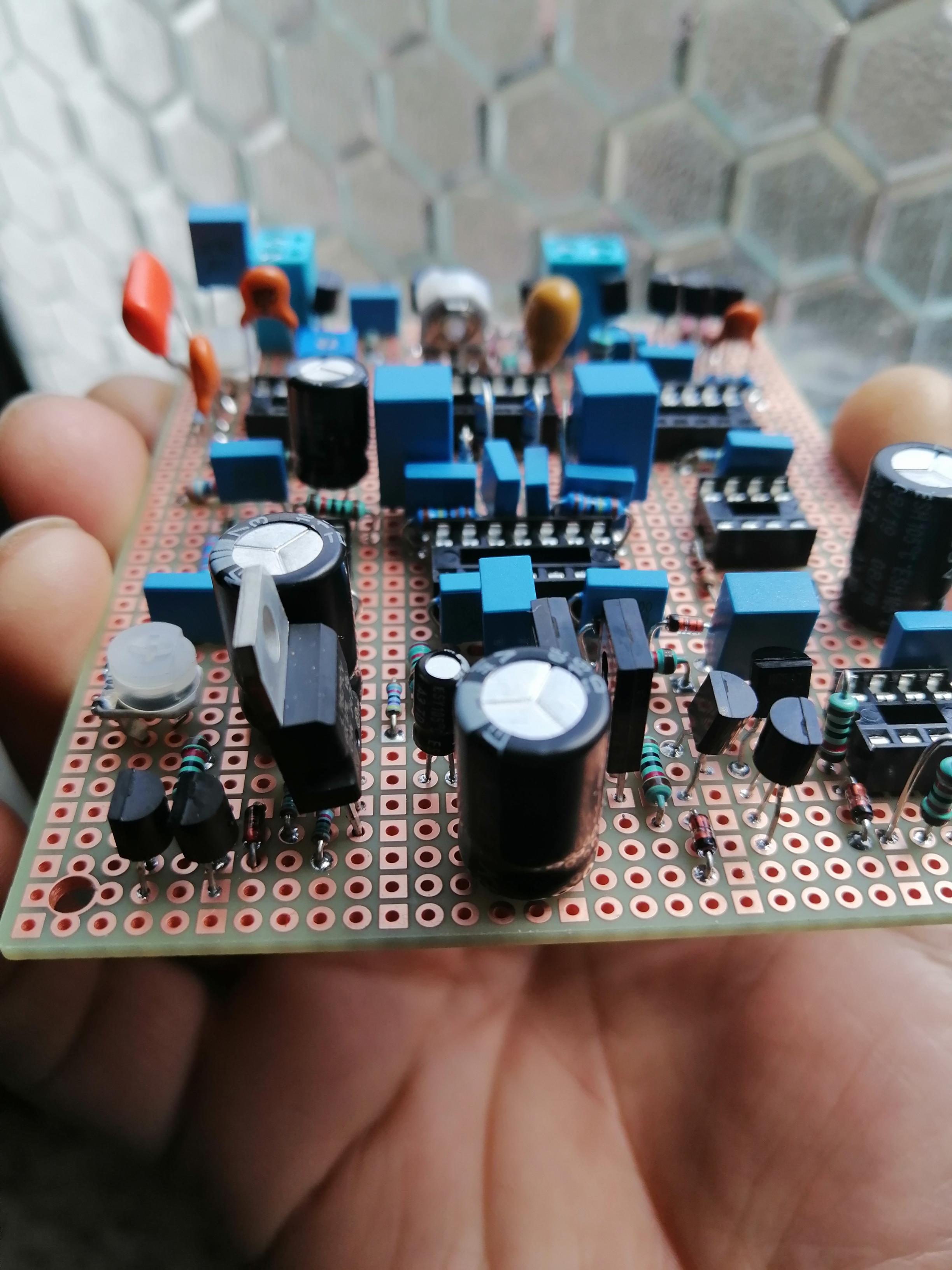

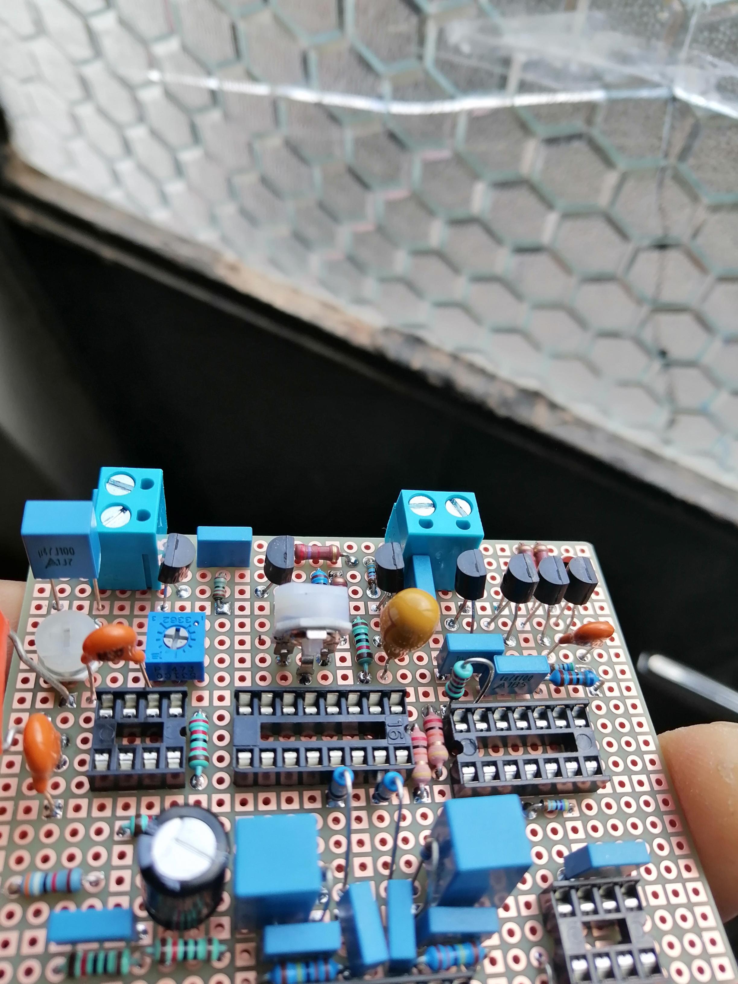

                            • Working in progress
                              Please ivconic check these images
                              And tell me if transistors in there right places
                              Also that big tantalum in its+ Click image for larger version
                              • Ah protoboard!
