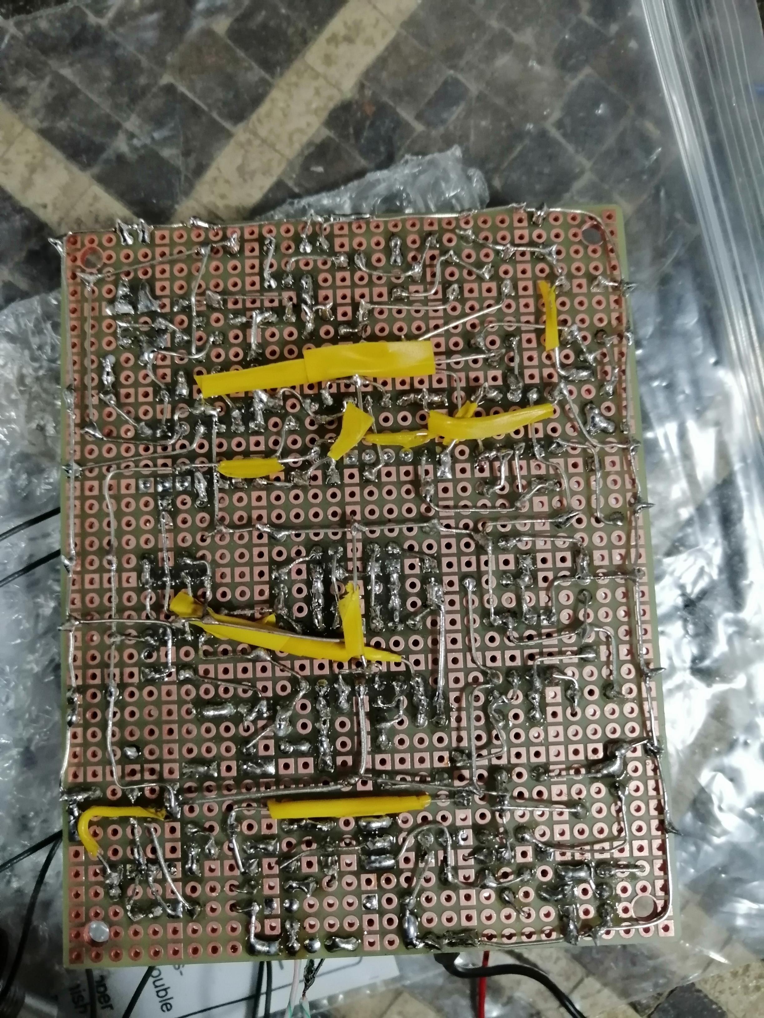

          The board looks terrible I know
          But it's working and I get first beeb tomorrow I think still a lot of something to do with

          • Originally posted by Hach View Post
            If you don't want to use a PCB, then a better alternative than protoboard is to use stripboard (Veroboard). You can design the layout easily with VeeCAD.

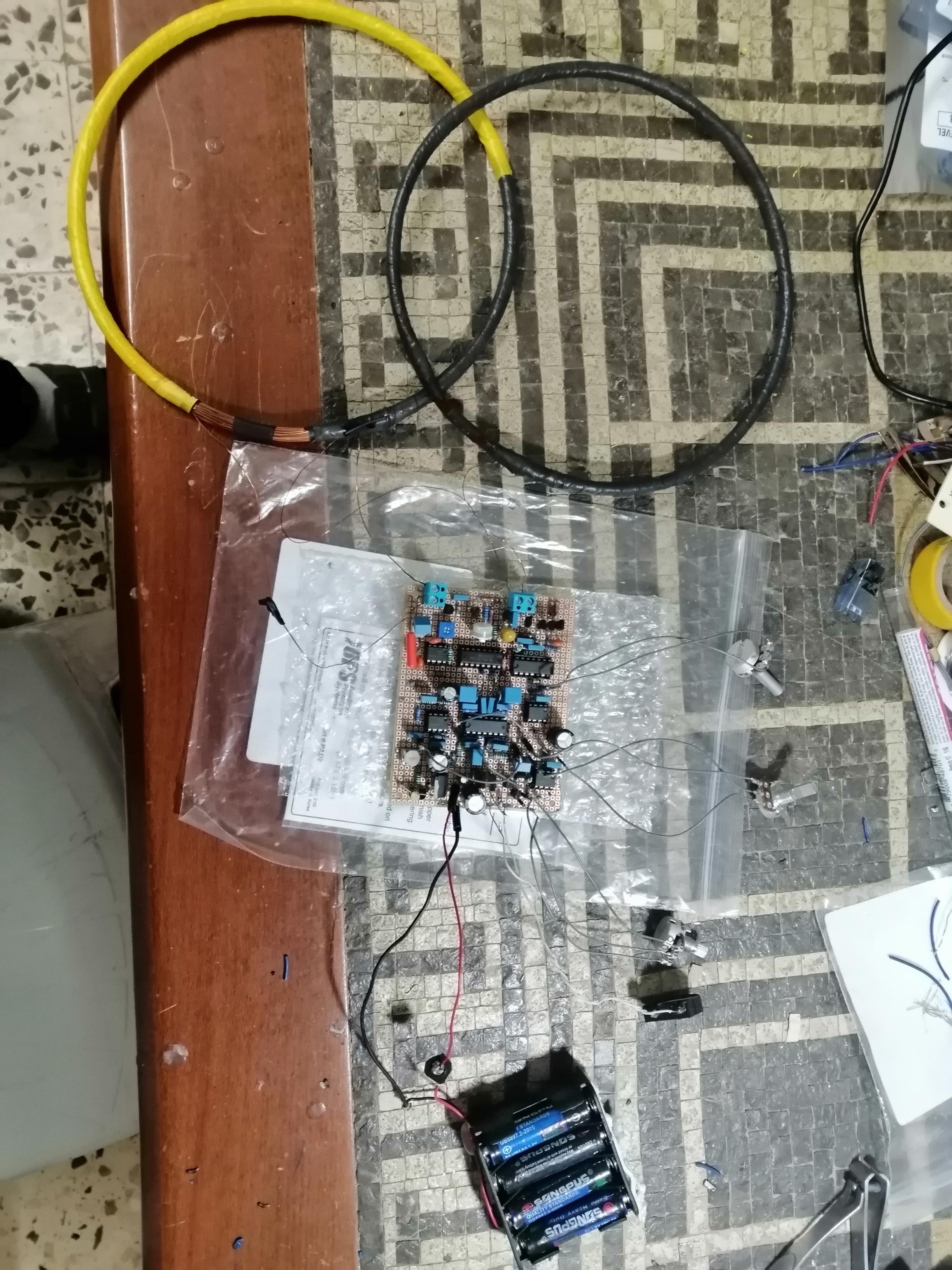

                I test the board and its work and there is a detection to 5cm only but my battery so week it's read on multimeter 6v also I get continuous beeb is it because low voltage?

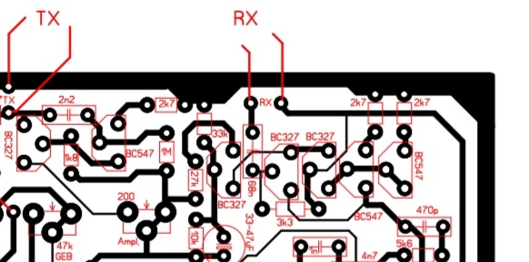

                              • Hello ivconic
                                Its really work perfect in air test I get 50cm cola can
                                Big iron like tea pot more than 50cm
                                Wedding silver ring 20cm
                                Coin 10mm 20cm
                                Gib discriminate only iron coin not all iron
                                TV ferrite can't be discriminate
                                I test it inside room where electronics and wireless also the ground have iron in it but it's not quite at all when I face it on the ground so noise, dos this noise vanish outside?
                                Also I afraid I don't connect coaxial TX and Rx in it's terminal plase look at attached image and tell me where should I connect to.
