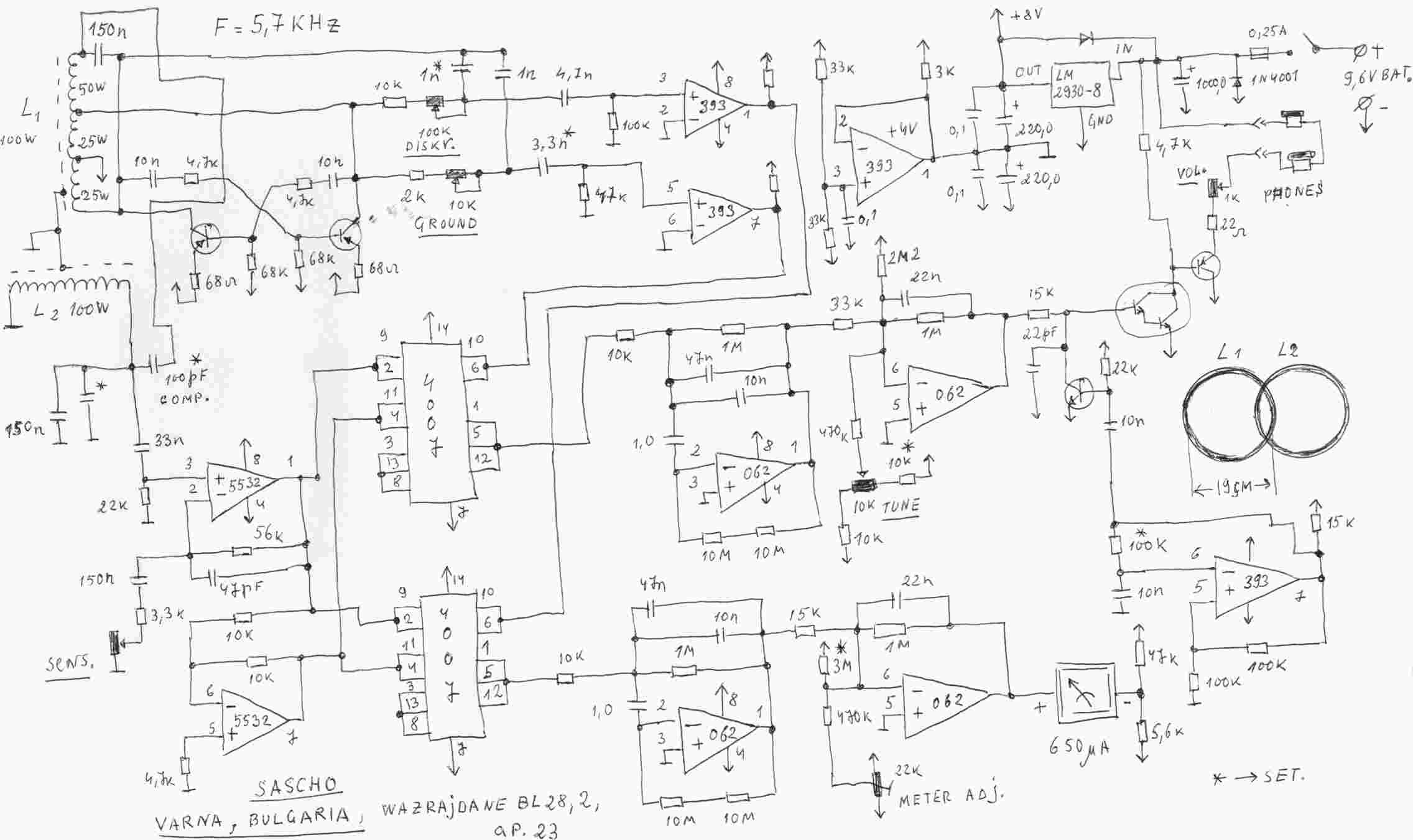

notron do you have a clean and updated schematic? If it is worth replicating I might draw a pcb for it once I test it on a breadboard.

The scheme is very simple and easy to implement, the main thing in it is the generator which has a coiled additional coil which in resonance with the capacitor raises the voltage from 150 to 200 volts. The effect is manifested over 150 volts. The scheme has phenomenal effects. For example, sensitivity has been observed to increase significantly at night. The generator that I later used was according to scheme Fisher 1266x. It is practically the same but without capacitors that introduce an error. Because the signal from the object displaces the generator itself. Natural amplification is obtained as a regenerative receiver.
If I have time, I will apply a developed version of this scheme. Note that all of these metal detectors have limited capabilities under radio communications law. However, this metal detector emits an extremely powerful signal and is against the law.

Is this the schematic you're referring to?Originally posted by bgs View PostThis scheme was created by Stanimir from Varna, Bulgaria and was copied in many places. Now someone is pretending to be greatAttached Files
