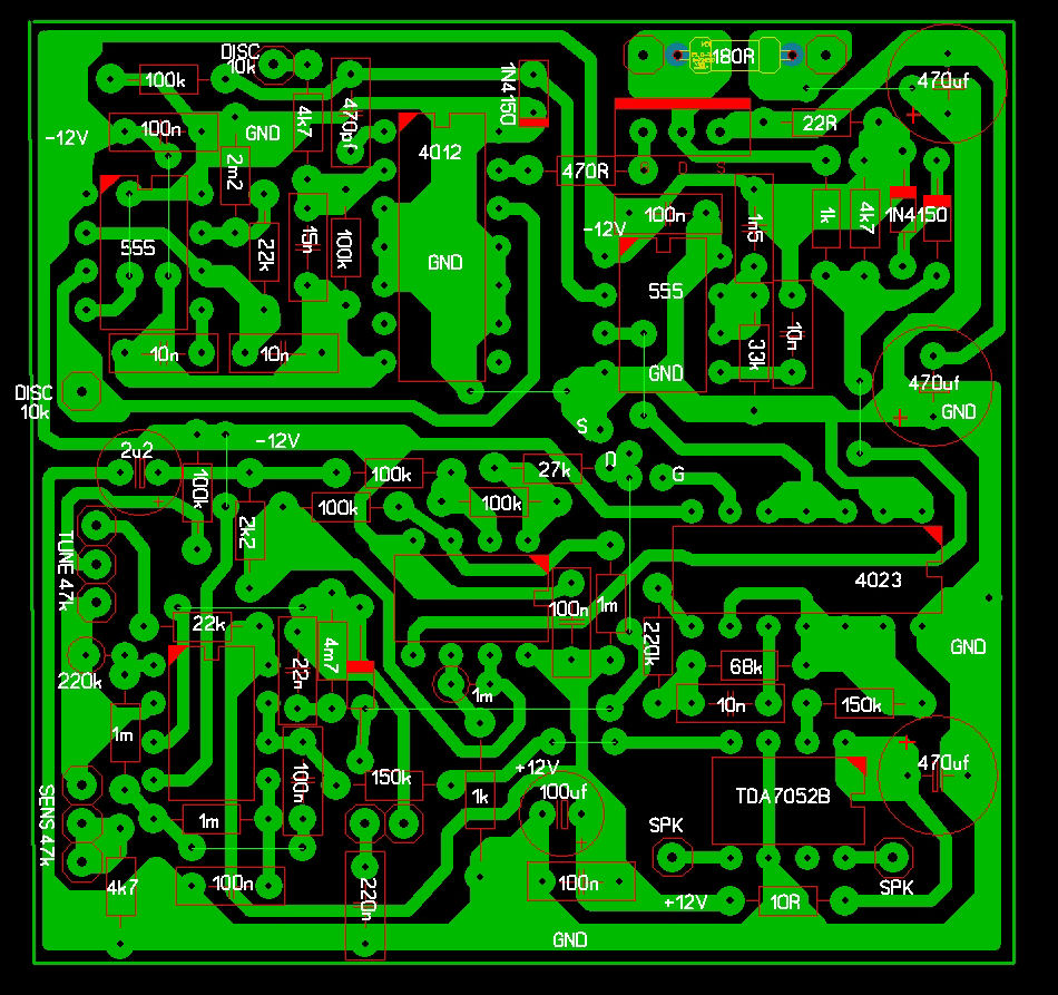

    i started, but main problem is that you can?t buy the main pcb anymore
    so task is to redraw by pictures and shematic
      Maybe I could draw the schematic on EasyEDA and convert it to PCB for orderding through jlcpcb.com with corresponding parts from lcsc.com if anyone is interested.

          sounds like a good idea
          i would would copy layout with sprintlayout, but with easyeda from schematic to pcb generator is more straight forward
          i have only some wish if you do that
          -potis direct to pcb like in original layout so it can be mounted direct to the enclosure frontplate
          -add some testpoints on pcb, so it would be easier to hook up the oszi test probes (in the pdf docu there are shown some timing diagrams)

                            I'm having a hard time locating all the needed parts because some are old and obsolete and I couldn't find a proper replacement.
                            It also does not mention what are the values of the toroidal transformer so this project is most likely obsolete, unless someone finds alternative parts or ways to complete the project.
                            Although I'm almost done on the schematic redrawing it seems pointless to continue at this point.
                            If someone is interested on continuing the schematic, you will find it on EasyEDA.com with project title "Rivista Nuova Elettronica #245".
                              I am drawing the board now the transformer is no biggy just needs plus and minus 12v many ways to generate that i have ordered the TDA7052-B from Aliexpress I asked for the correct one hopefully i get it. LM6218 is only sticking point and i am not sure why they went all exotic with that only works at 67hz according to the text, i will try substitutes the rest is not a problem.
                              was done in a rush not yet checked properly a second opinion would be helpful.
