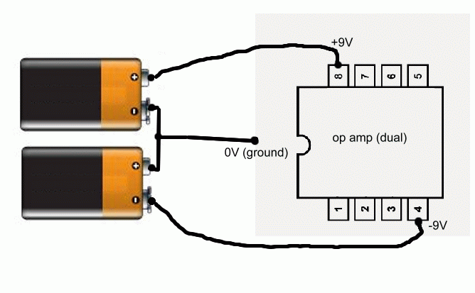

                  So your idea would be to connect +12V and -12V? And what about the GND?
                  Or even if you connect +12V and GND, what about the -12V? You have to leave either one unconnected which would make the circuit useless.
                    Like this.Click image for larger version

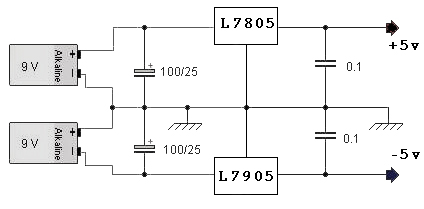

                    And this with regs just adjust the battery voltage, easy peasy.

                    So for a quick +- 12v supply just centre tap 6 18650 cells
                    for regulated +- 12v supply just centre tap 8 cells and add regs

                        or a combination board with
                        7812
                        7912
                        7805
                        7905
                        and some buffer cap
                        so 4x 18650 would do the job (4*4V = 16V and some room for the voltage drop of 2,5V for the 7812)
                        • #43
                          Could work if you can keep the noise down, may need some OS-CON caps on outputs
