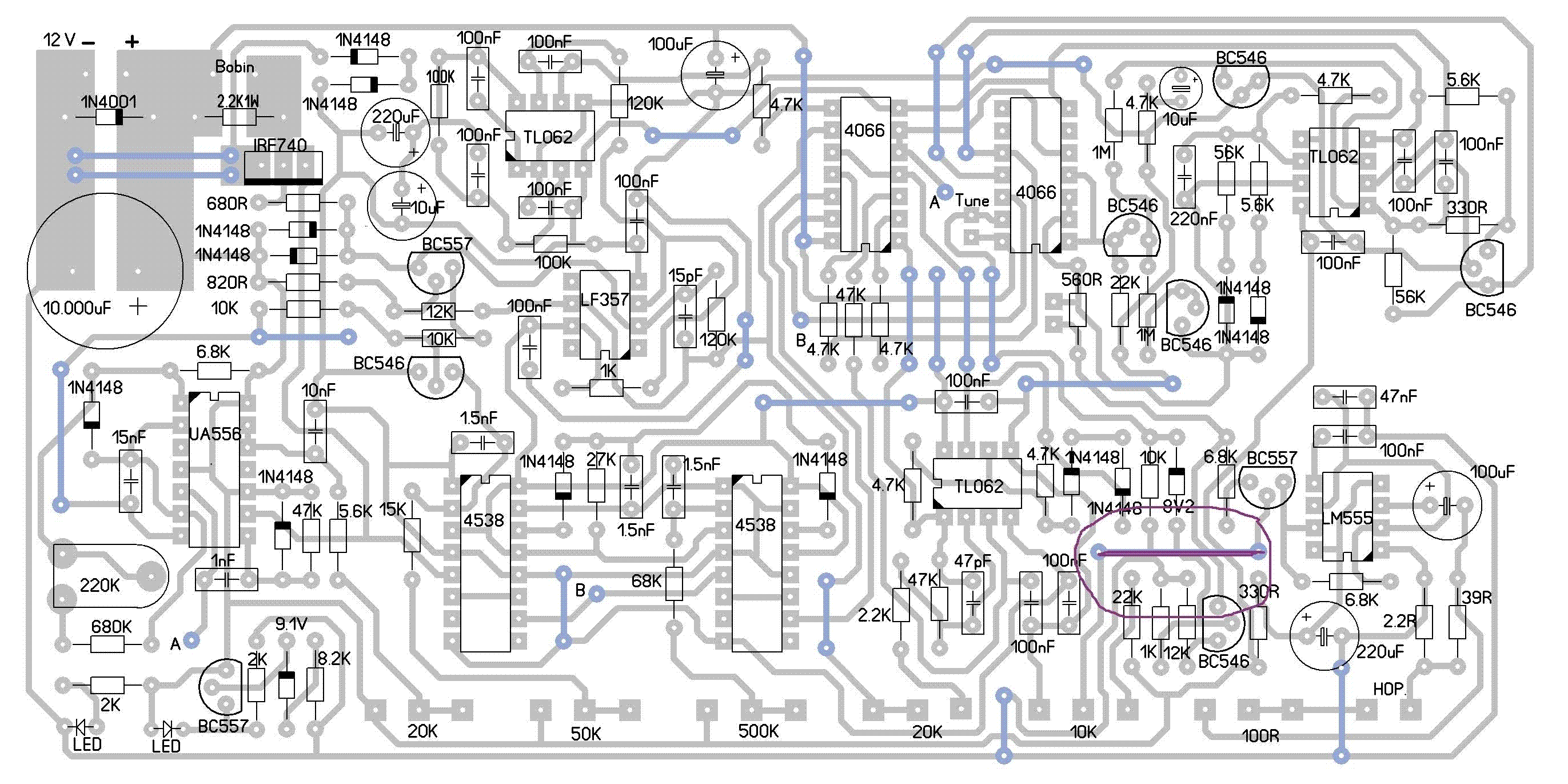

    Hello! I am a new member and do not have much knowledge of electronics. Can anyone tell me if this design is right to convert the sniffer to 24 volts?
    https://postimg.cc/HJqKYvFs
    If anyone has any other schematic to convert to 24 volts, let him put it here if he wants.
    My pcb is: https://www.geotech1.com/forums/atta...3&d=1504014696
    Thank you!
    Trying to operate the device more than 18V will cause damage, so please don't do that.
      It is supposed to only power the 24 volt output mosfet, the rest with 12 volt power circuit. So what's wrong? Thank you!

                  So if I change the irf740 transistor to some other eg 2sk1317, 1500V 12A 100 watt or some other igbt type then will I be better or not? With the same 12 volt battery or should I increase the power supply?

                    this board is the same as mine: https://www.geotech1.com/forums/atta...7&d=1482604559
                      there are much mos-fet's besides IRF740, BTW. 2SK1120 2SK727 are 1000V, for example. 2SK1317 is 1500V.
                      and what? those guys see/notice just the voltage and current, they do not want to see another parameters (blind squirells), excluded all
                      they do not like.
                      for example, 2SK1317 has 12 Ohm Rds, while IRF740 has just 0.55 Ohm.
                      also they forgot that power MOSFET has capacitance on GATE more than on unpower one. it needs a driver.
                      then you must change schematic.
                        So what are the best transistors for the sniffer? Only irf740 and 840 for better performance;

                          NO better perfomance be cause an ideal transistor does not exist. you have to choice mosfet under
                          your schematic. if IRF740 840 works good why i have to set IGBT? BTW IGBT is also having
                          problems in perfomance. there are so much provocative adwertizing, manufacturer must sell
                          more and more of production, such life of capitalistic industry. IGBT is one.
                          you are one from those who wants to do the deeper more deeper.
                          ok, stay in ramka coil inside and do 500us PULSE WIDTH. i want know your feeling now
                          ahaha!!! YOU WILL BURNT LIKE A ROAST CHICKEN!
                          nice... you had got what you want.
