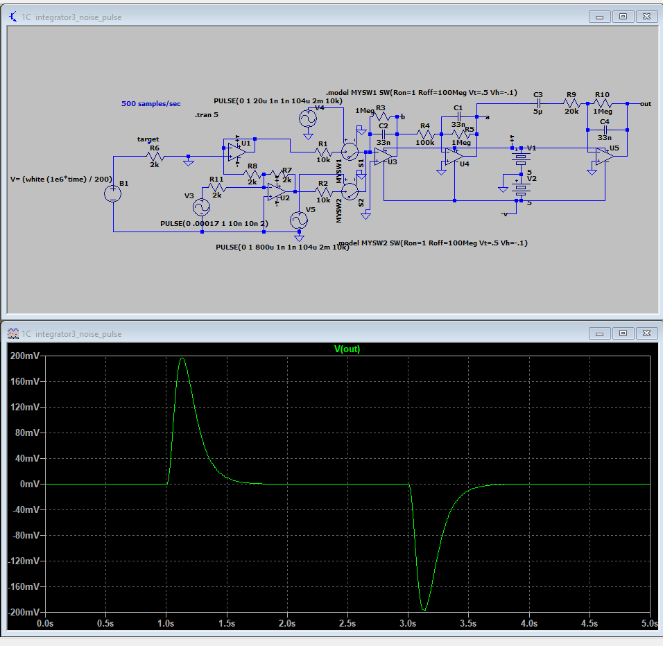

      With spice EF simulation. 1C integrator_ 5% mismatch of input resistors causes output to be about 5% of the input. Zero output if input resistors are matched. 2C integrator_ cancels at one second delay time only. 5% mismatch moves the second delay time that cancels. Signal out less than 5% of input at other second delay times?
      Could someone explain EF. Connected a 8inch mono coil to Rx input to see what we are trying to cancel. Don't see a change at amplifier out when moving coil back and forth. Rocking coil causes a signal. What amplitude should I expect for EF signal at coil out(amplifier out/amplifier gain). Should I expect to see EF if coil remains flat while sweeping?

          As far as I can ascertain there is nothing wrong with the simulation. If you set the switches to permanently on and set the target signal to 10mV dc, then the circuit outputs a signal that is "near as dammit" zero volts.
          Going back to a sine wave input and sampling the switches with main and EF pulses, if you move the 10k input resistors to the output side of the switches (instead of the input) then you can probe the switch outputs to see what is happening. Comparing the two outputs shows clearly that the differential opamp cannot possibly subtract the non-inverting input from the inverting and achieve a zero volt output as the two signals are in constant fluctuation.
          The strange thing is that Hammerhead uses a similar configuration and I know for a fact that it can cancel the Earth field. The circuit used in the Minipulse is different in that the feedback resistors are connected to the switch inputs.
          We will all need to think about this problem a bit more.
          • #65
            Changed the input to pulse. The +input has a sawtooth waveform(R11, C5). If the second sample is taken at the right time of the sawtooth the output is zero. Change the 589us sample time to 800us and see what happens. Think I see the problem now?
            2C integrator does reduce signal and cancels if sample delays are correct. Maybe good enough or just lucky.
              If you change the input signal to 10mV dc, and do the sampling, it doesn't completely cancel.
              There is a dc level at B of about 2mV. Since the inverting gain of the opamp is 100x there is clearly some cancellation going on. It's just not that good.
              I suspect you may have the EF amplitude set too high in the simulation anyway. I've never measured the EF signal level in practice but it's probably much lower than 10mV. Which would explain why some simple designs like PI-4 do not appear to have an issue with the Earth field due to their much lower gain.

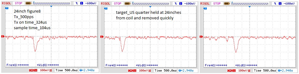

                  Tried to calculate the minimum value I can detect with my detector. Maybe correct maybe not. Think 200uV maybe 100uV at integrator in if coil pickup noise is low enough(.2uV to .4uV at amplifier Rx in). 2C integrator reduces input by at least 30 so I would need at least 3mV EF to detect. Not sure I did it correctly. Interested in what other members get.

                          Like waltr, my initial thought was that the circuit was sampling on different parts of the sine wave and this was the cause of the problem, but I was sidetracked into thinking there may be something wrong with either the simulation or the circuit itself.
                          The whole premise for EFE is that the early and late samples will contain the same amount of EF signal, and therefore a simple subtraction process can be used to remove the EF. You can prove that the cancellation process works in a simulation by using a dc voltage as the EF signal. However, in the real world the EF signal is not exactly the same during the early and late samples, and the EFE can become compromised. I suspect some circuits are better than others at providing good EFE, and green's use of a 1Hz sine wave seems good at exposing these limitations.
                          The question is: "How good does it have to be?".

                            1C integrator cancels 1Hz sine or dc voltage at different delay times(it samples the sine wave at different parts of the sine wave). 2C integrator doesn't cancel 1Hz sine or dc voltage at different delay times. The capacitors, feedback and +in to common effect error amplitude. The question is: "How good does it have to be?". Good question, how do we find the answer? ZED reply #55 seems to have a problem with EF.
                              https://www.geotech1.com/forums/atta...6&d=1599429210 A scope picture of detecting a US quarter. Modified one of my spice simulations to match my detector circuit used to detect the quarter. 170uV in gives same signal as quarter. Should be able to detect 100mV signal at output, 85uV in. Similar to the 100uV in suggested with my first try.
