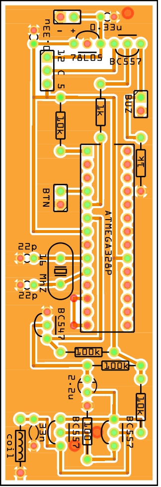

                              • PCB 1.2 rev 2.rar
Name:	CAT-1.2 rev 2_pcb.png
                                PCB rev2
                                -added 3pin header for select 12v (intended as battery voltage 9v -12v) or 5v buzzer
                                -other small improvements
