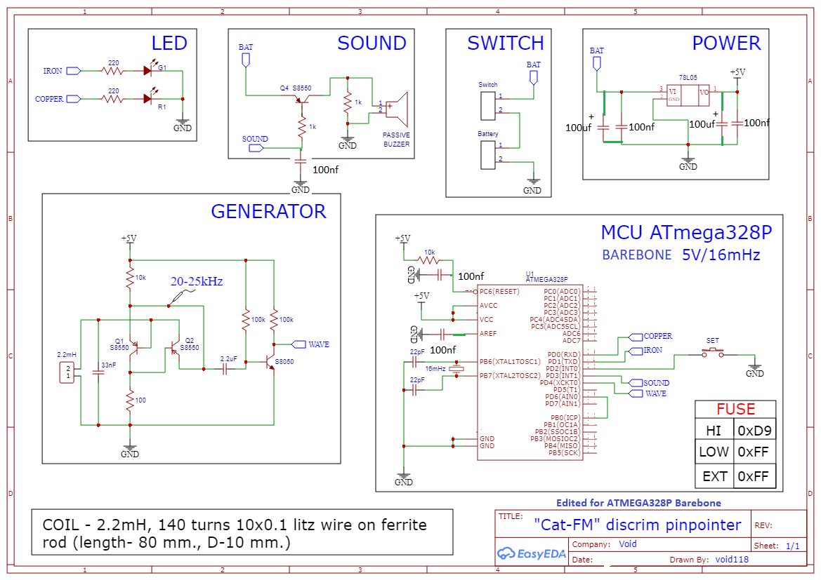

Pinpointer with discrimination "Cat-FM" on ATMega328P
  • follow this pattern otherwise you may have the same problems I had
    it remains to understand which 33nf capacitor to use, the one I use at the moment is the most stable with temperature changes but I have to find a better one, I have no idea which model to use

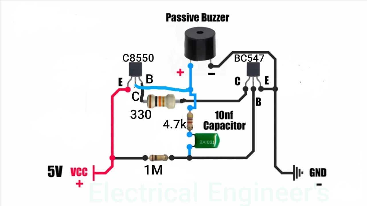

    • Hi Useus. Have you tried this little circuit? It is a Passive piezo driver circuit. The C8550 Can be substituted for BC557. Regards, Marty
        You don't need this circuit on cat fm
        • Ok, but I bought the same passive piezo as the one used and linked by Void118 and I can't get it to work? There are 3 terminals on it. GND, VCC AND I/O. When I connect the GND and VCC to the Cat fm,,,,nothing? Where shoud the I/O be connected please? Regards, Marty.
            Vcc on bat+
            I/o you need connect this to atmega328 sound pin
            • Thanks Useus. I am not certain which pin of the ATmega328P-PU is the sound pin? Thanks, Marty.
                See schematic or my pcbs in previous posts

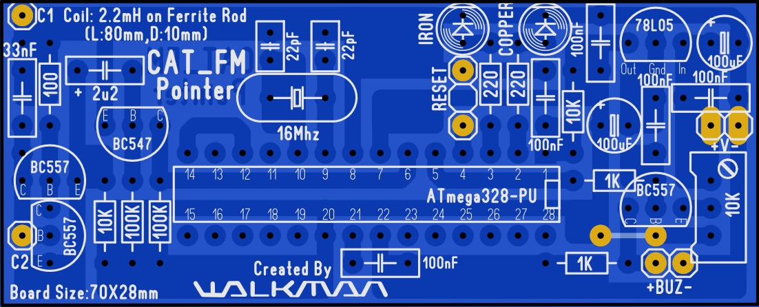

                      • Special Thanks
                        Thanks to void118 for bringing the project to the forum.

                        • Originally posted by walkman View Post
                          [ATTACH]55326[/ATTACH]
                          My test videos. Have a good time.
                          https://www.youtube.com/watch?v=DCyV...X8fJzhN4AaABAg
                          Thank you my friend, very nice design and great coil!

                            • hi all
                              whats the fuse bit for programing atmega328p-pu?
                              best regard
                              zakari
                              • Originally posted by zakari View Post
                                hi all
                                best regard
                                zakari
                                Hi, you can find fuse bits settings on the schematic page.
