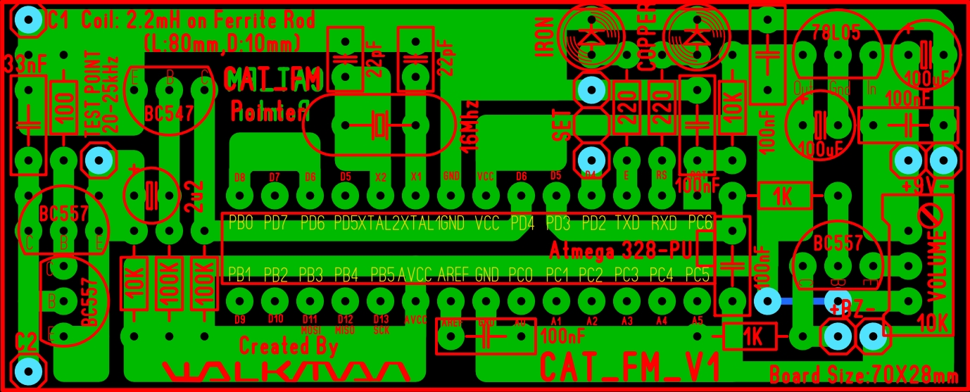

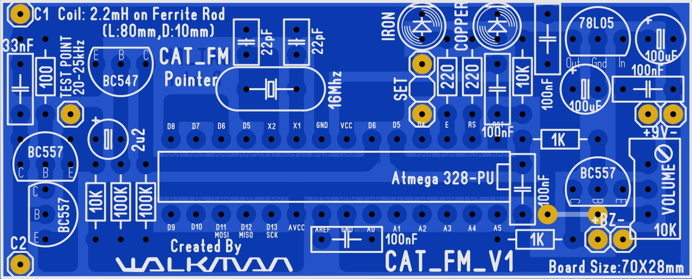

The pcb walkman works fine i make it it staible and good deept .

Hi friend sorry to late for answer.Originally posted by MartyJ1963 View Post@Void118,,,Thanks for the help,,,I will try to decrease the capacitor. @Walkman,,I made your pcb and placed everything correctly but I still cannot get it to work. Do I remove the 100nf capacitor? And is there anything else I need to do? Thanks, Marty.
cat_fm_v1 for only 100nf removed.
Rebuilt Cat_FM_V1 for pcb.Tested and work.
