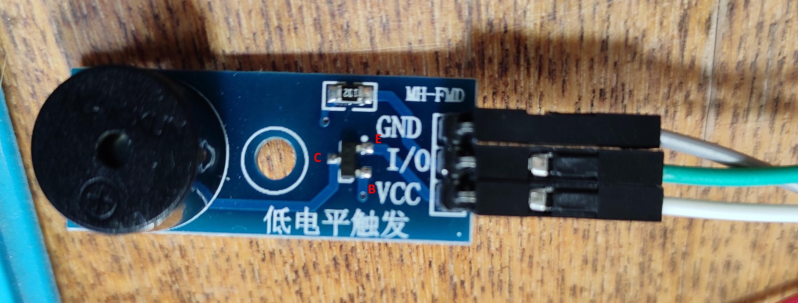

    i don't understand how you connected it, gnd ok, i/o ok, while vcc and the soldered wire?
    It's not soldered wire It's thermocouple to show you transistor temperature....
    • Originally posted by void118 View Post
      Emitter to VCC, Collector trough buzzer to GND, In parallel to buzzer 1K resistor, sound to base through 1K resistor

          • Just now I tried to connect electromagnetic 16 Ohm buzzer and It's much louder than piezo buzzer....
                ok then it's as I thought. I already own it electromagnetic but it is 45 ohm so the noise is lower. the strange thing is that with a normal passive piezo it doesn't sound at all
                i will buy a 16 ohm one
                        Hmm, It's realy strange....
