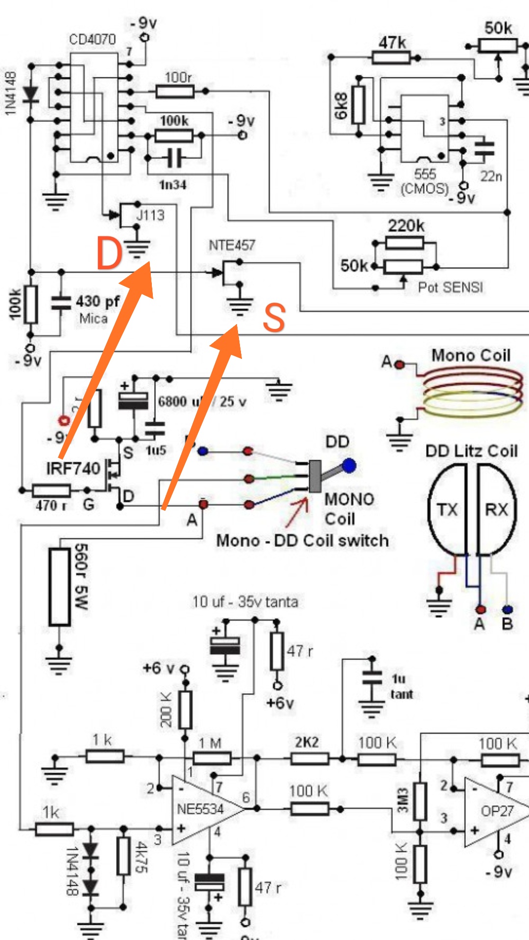

    Hello... I want to connect a normal coil with two outputs. Where to connect the two ends of the coil... As it is clear in the diagram, one end is connected to the ground and the other end is connected to A... In this case, what is the use of pin number 3 of the IC 5534

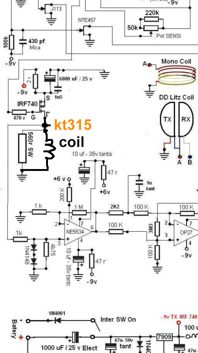

        Thank you very much, dear sir. Please allow me to ask another question... Is this explanation in this picture correct?

          I want to know if the scheme is correct or there are errors?
            Those are JFETs and usually drain & source are interchangeable.
            Overall it's a poorly drawn schematic and I would need to completely redraw it to make sense of it. But what little I figured out on it looks correct.
              Thank you mr carl-nc. . i am waiting for you
                It will be a long wait, I don't have the time to do any more with this.

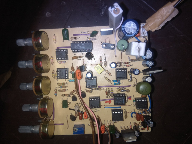

                  i was made this metal detector but i think pcb has error
                    hi a7mdrat can you answer iwas make deeper x5 and deeper
                    10 DD BUT without enney work. whey. can you help with right pcb.

                      I'm having a problem with the sound not coming out

                        Yes, it is true, but I want to solve these errors and fix them if I can

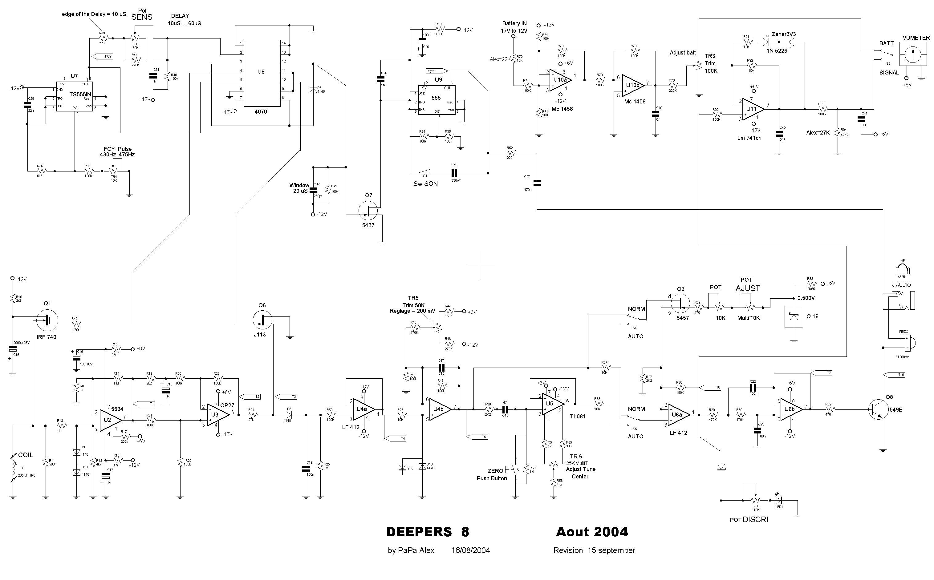

                            I want upload the schematic for Deeper 8 but link do not work
                              hi friends i ask why MFC says deeper 8At what is the diference between deeper 8 and 8At
