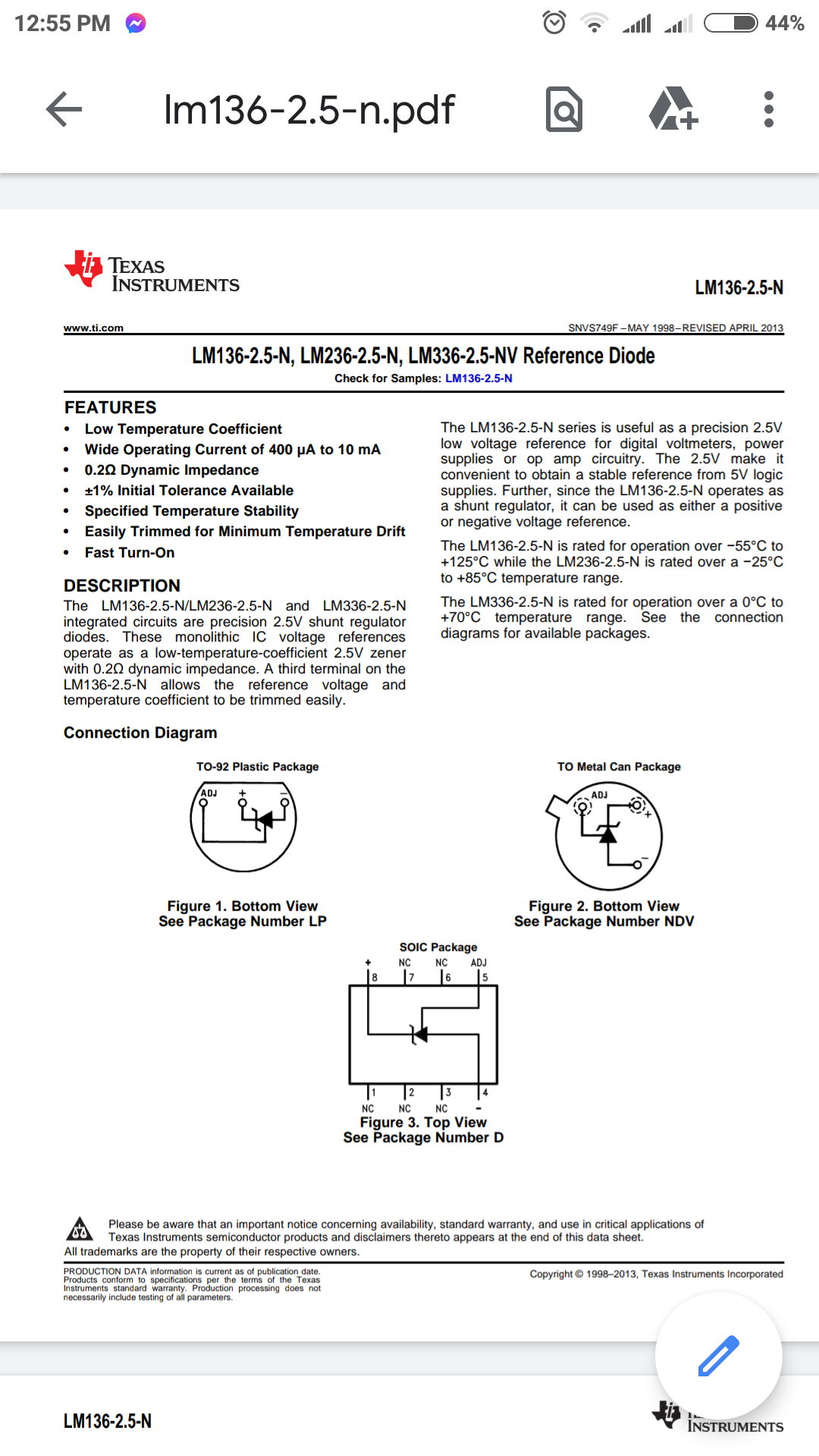

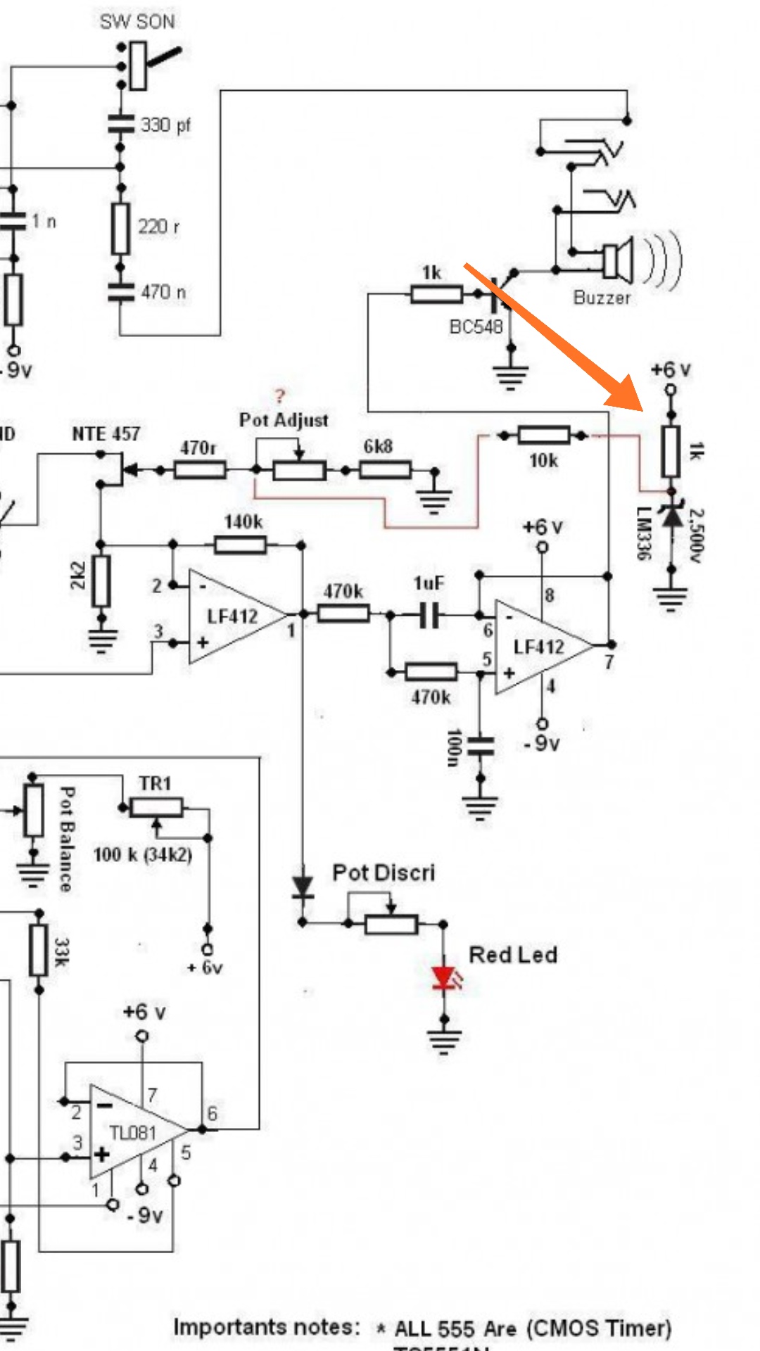

            in schematic deepers 10 dd
            LM336

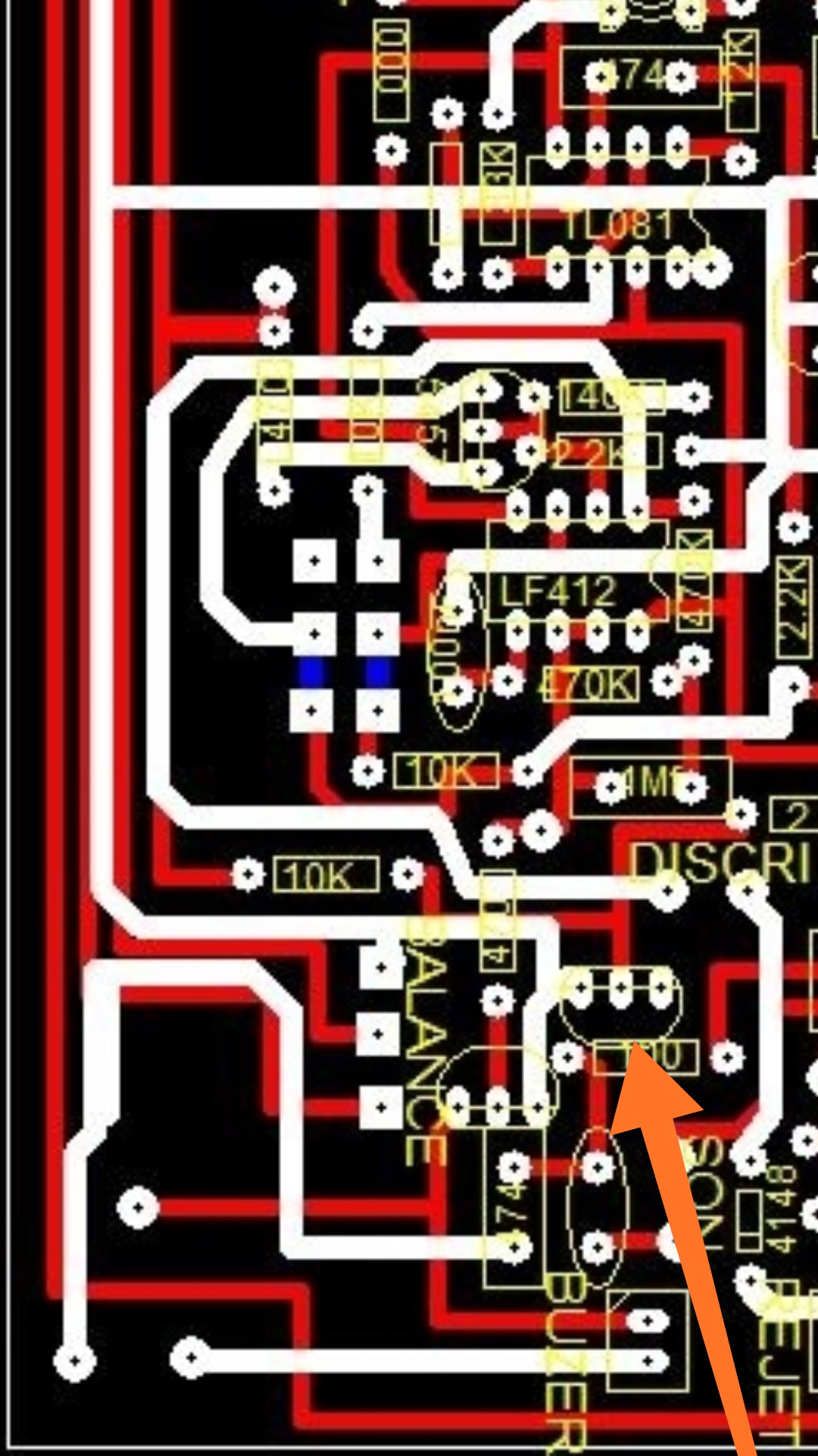

            How is it installed.. In the schematic and on the board, only two pin are installed...Is this correct?
            Please explain how to install it

                the LM336 in the ciruit is used only as a "fix" 2.5V precision zener diode. Looking at the partial PCB layout from the image you can expect more funny errors in the PCB. The routing is everything else than professionally made. The the parcial posted schematic also does not match the PCB layout as you can see in the case of the LM336. My advice is take the Deepers schematic as a "design idea" only and make your own schematic with a propper PCB layout design program and cross check all circuit parts with the official manufacturers data sheet and/or application notes.
                  Thank you... I actually did that and re-designed it again... and the device worked fine for me except for the part related to this component 336 where a variable resistor is connected to it and it does not work without installing this component correctly, so I came here to ask
