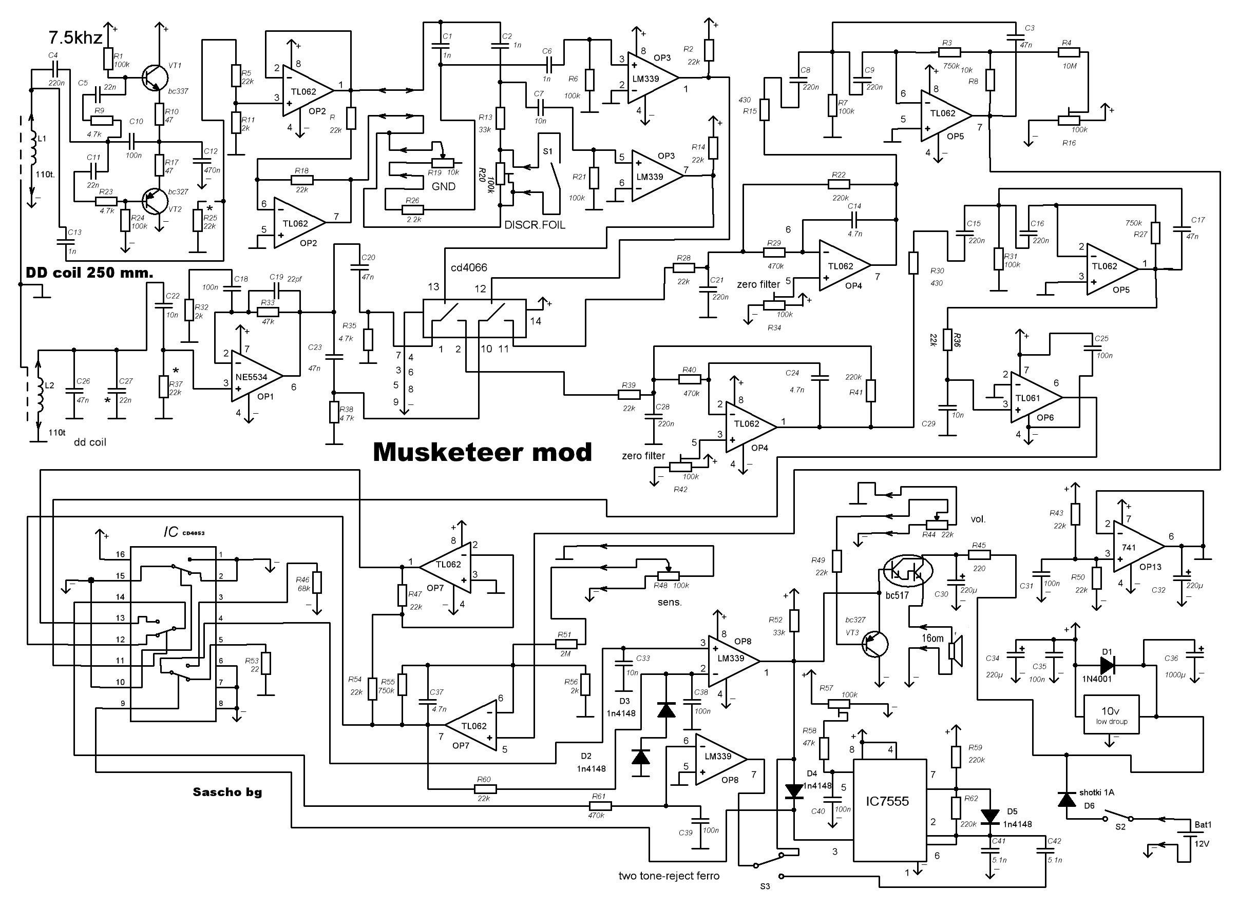

      The comparators are two lm 393 , not lm339. I apologize for the mistake
        Originally posted by bgs View Post
        Schematic work perfectly.I have no intention of corresponding with fools.
        It doesn't change the fact that the schematic drawing is atrocious.
        Normally I don't comment on such things, but your drawing is so emphatically horrific, that it is shocking to the eyesight.
        I'm sure the circuit performance is excellent as you stated.
        You see, even if I were trying to mangle a schematic on purpose, it would be hard to replicate yours. It's truly marvelous.
        You should take it as a compliment. In good spirits.

                  The low tone indicates iron and the high tone indicates non-iron. If anyone doesn't like my schemes, don't look at them.

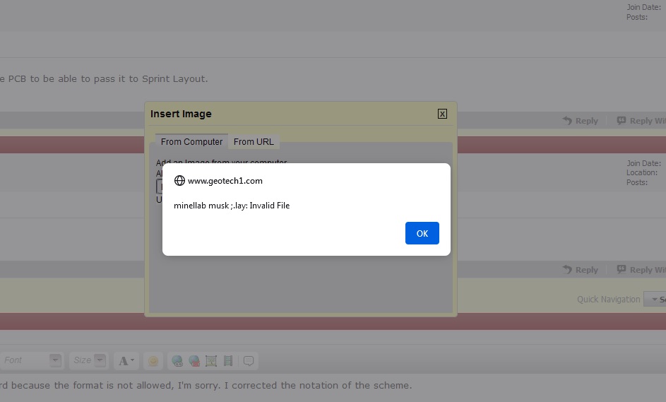

                    Do you have an image of the PCB to be able to pass it to Sprint Layout.
                      No
                        I can't send you the board because the format is not allowed, I'm sorry. I corrected the notation of the scheme.Click image for larger version
                          I can't send you the board because the format is not allowed, I'm sorry. I corrected the notation of the scheme.[ATTACH]56909[/ATTACH][ATTACH]56910[/ATTACH]
                          You just have to compress it in Rar or Zip file.
                            Try making it a zip file.

                              The design is excellent.
                              The schematic diagram could be redrawn for a nice readable schematic. As it sits, it is a nightmare to follow.
                              So l did redraw schematic to make a nice readable one.
                              Now it becomes easy to follow the circuit, especially for construction and troubleshooting.
                              Thanks bgs for sharing.
                                The TX circuit is very good. Generates nice sinus waveform.
                                I have used ltSpice for simulation of the TX circuit all the way to the output of the phase shifters. It is working. All seems very good.
