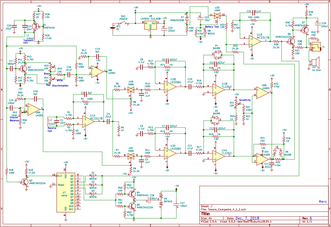

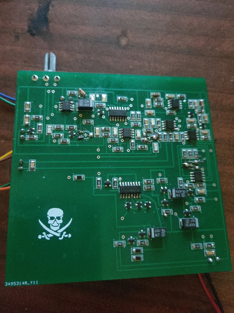

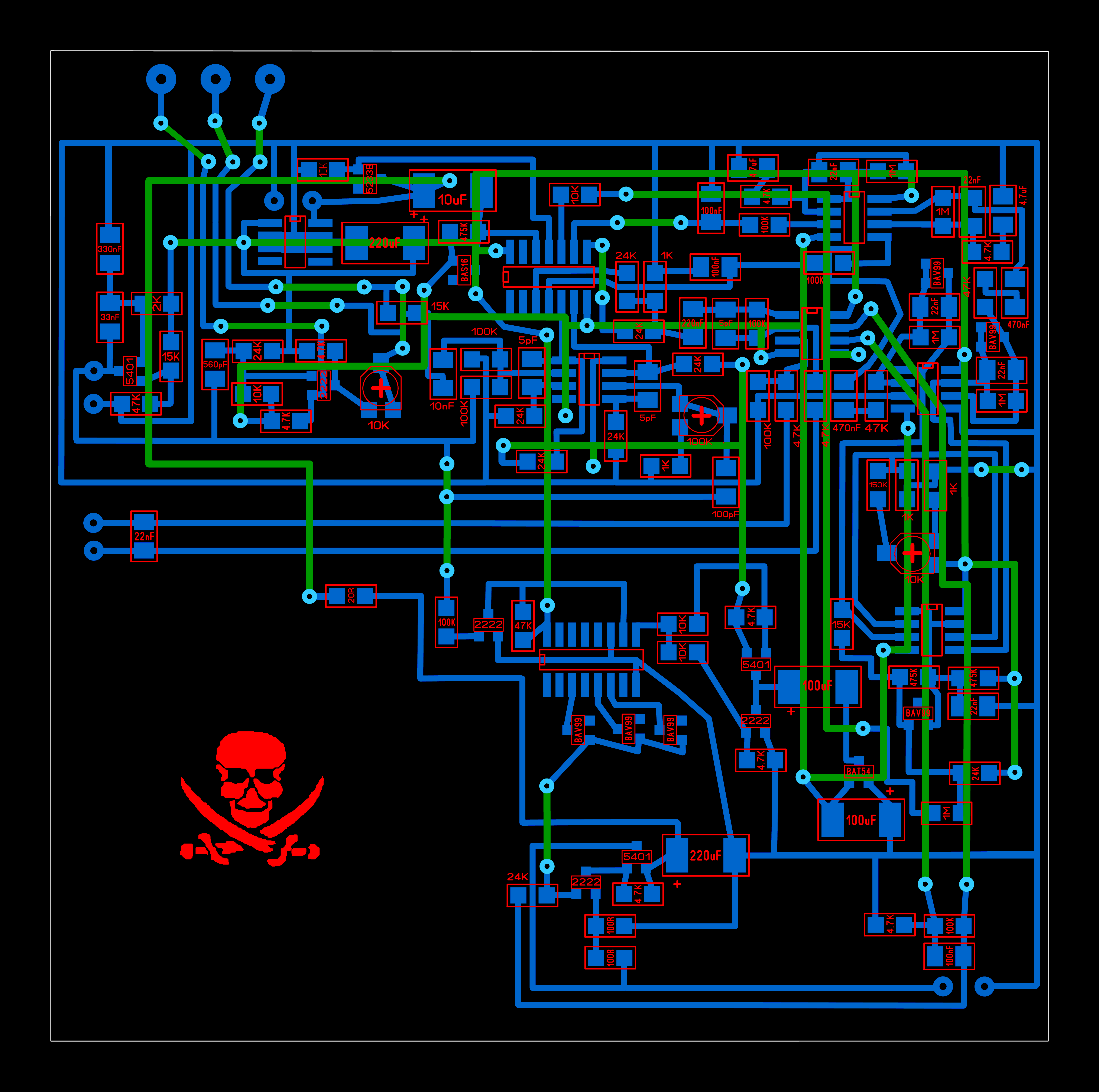

Thank you Hinkri for sharing your work.Originally posted by Hinkri View PostHi all. Sharing my final printed circuit for Tesoro Compadre assembly. I assembled it myself and my friend too, this is a completely serviceable circuit! Catches 5 kopecks of the USSR - 20-22 centimeters in the air.
[ATTACH]57040[/ATTACH]
[ATTACH]57041[/ATTACH]
[ATTACH]57042[/ATTACH]
This could well be my next build project.
Alan
