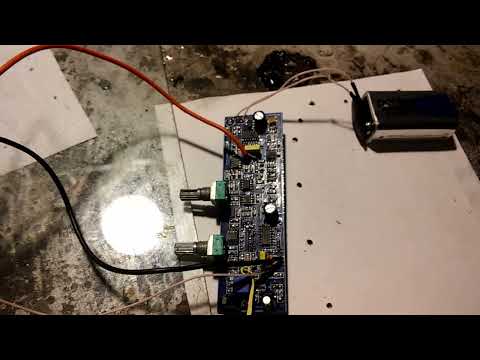

    wanted to ask based on my electronic drawing board
    based on schematic that i found on this website
      Are you using my PCB drawing?))
        Are you upset ?
        maybe I cannot understand the conversation... maybe we have some cultural barrier working against us...
        If you don't want me to use this schematic say it.
          Are you upset ?
          I’m writing to you not about a circuit, but a printed circuit board in lay6 format. Do you intend to use it in production or a purely circuit separately from the file in lay format
            this is the story..
            I was looking to buy a compadre but cannot find one.. so I found this post on this forum and i was thinking to build one.
            I'm not a SMT lover and have only a few of that components so I was thinking to use the schematic you post here, redraw it in eagle and make a THT board for me.
            Because I'm not a miserly, and beacuse I'm using someone other job, i was thinking to give back the THT board that i'm willing to make, because I think (maybe I'm wrong?)
            that the majority of electronics enthusiast around the world are THT friendly.
            this is all
              this is the story..
              this is all
              Is TNT SMD? SMD popularity is calling in my opinion
              why draw your board? use mine. besides, it has already been tested and works completely!
                ok I will try your board, thanks
                  It seems to me that SMD designs require tools and skills that are out of reach or too daunting for those hobbyists that only possess the simplest of tools ie. a soldering iron.
                  For that reason alone I would prefer a through hole PCB design that is within my assembly skills and budget.
                  Gerber files are preferred so that I can just send it off to Jlcpcb ;-)
                  Thanks for sharing this project.
                    your pcb is huge for me. GMT King Cobra pcb size is 123x91, while your board 99x99. it is abnormal.
                    GMT King Cobra is NOT SMD layout and in two times more difficult in circuit.
                    size of Compadre pcb must be 50x50.

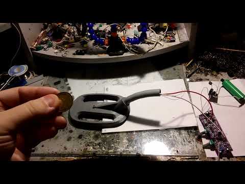

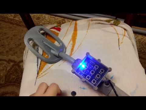

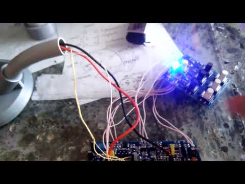

                      Поднял чуйку Tesoro Compadre до небес !!!
                      Источник:
                      В общем 3 дня подбирал компоненты, менял ОУ, искал золотую середину и нашел! Чуйка для линейки Compadre запредельная. Монета 5коп за 30 см на катушку 15 на 22 см. Позже как соберу попробую снять более точный тест и на золото тоже.​
                      DD 15 см x 22cm - 30 cm AIR
                        Tesoro Compadre underwater
