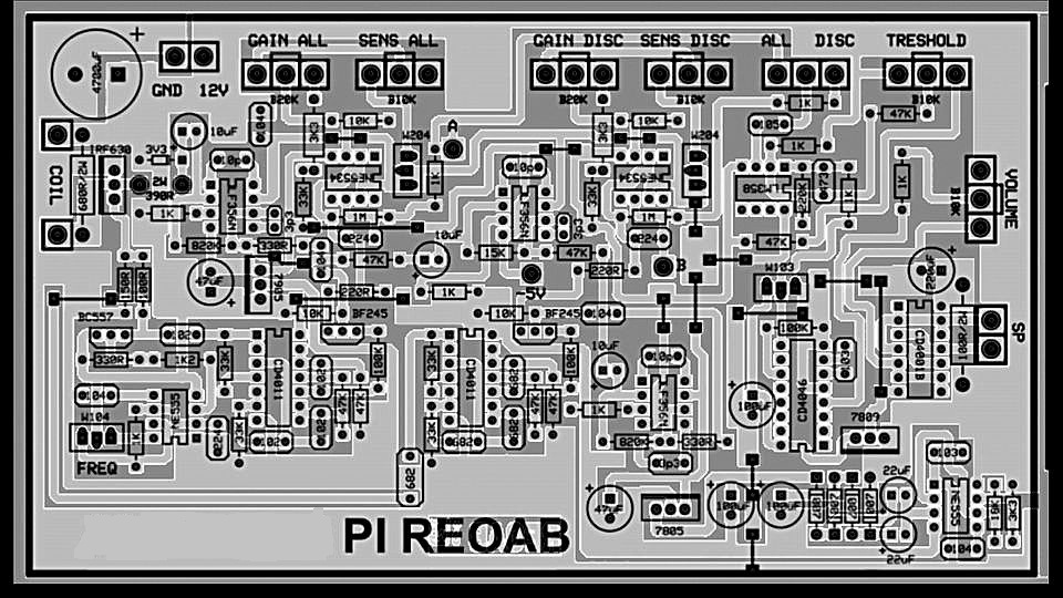

    hello, could someone tell me what this detector is and give me the diagram and the data

    Looks like Polones with VCO
      It's missing a small PCB.
        pi polones with disc, can you find better pictures from layout or pcb file?

                    for modification with ground balance you should look for moroccan version of pi polones

                          Can anyone explain why two single operational amplifiers are replaced by a 4x operational amplifier. I don't understand.
                          In my opinion, the board is made rough. The ZONE function is not used. Instead, the tracks are thickened by stacking several next to each other or on top of each other.
                          I allowed myself to make a small edit to the board without changing the links on it. You can also make changes if you don't like something.
