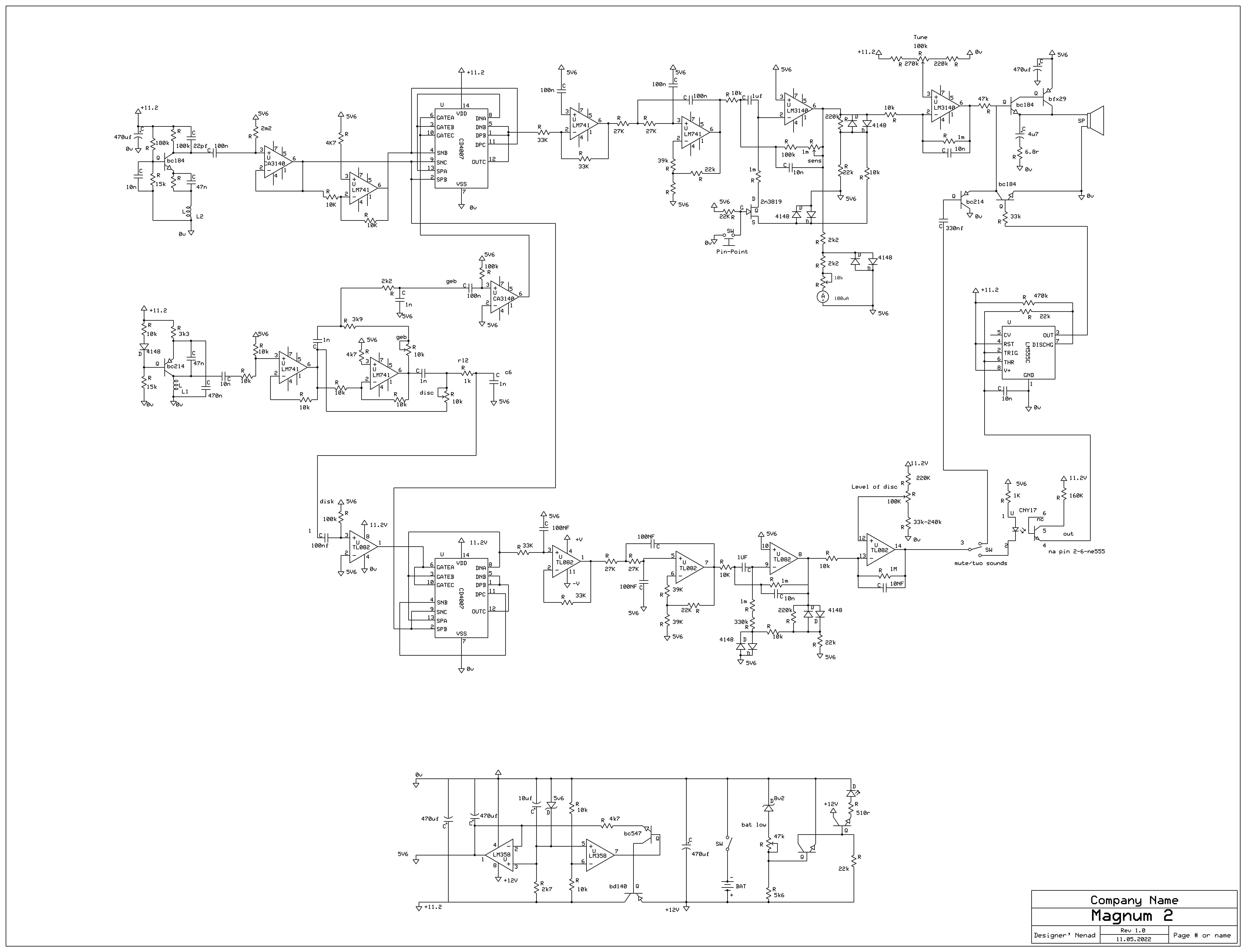

    This is my first VLF detector I have worked on many years ago, the other day I found pcb and I decided to draw a scheme and to share it .
    This detector is a modified Magnum does not require complicated switches to switch from the geb potentiometer to the disc it has excellent discrimination and two tone sound selection or selecting mute sound switches for the iron..A pcb is never drawn on a single pcb if someone wants to draw a scheme it is correct.

    Thanks for sharing Orbit! What is the resistor value in parallel with 47n going to the RX coil?
      Hi Altra ! however I dropped the resistor just like on the original Magnum 15k here's the fix good observation thank you.Click image for larger version
Name:	Magnum 2 moj prvi vlf sa skalom(1).jpg
ID:	362896 By the way, the coil for him was 27cm DD..
          Dropped another 39k resistor on ch 1 now everything is regular !Click image for larger version

                    Hello. You have not indicated the frequency of the device and the data of the coils. If not difficult, add information. Also, tell us what you liked about discrimination and what is better than other detectors?

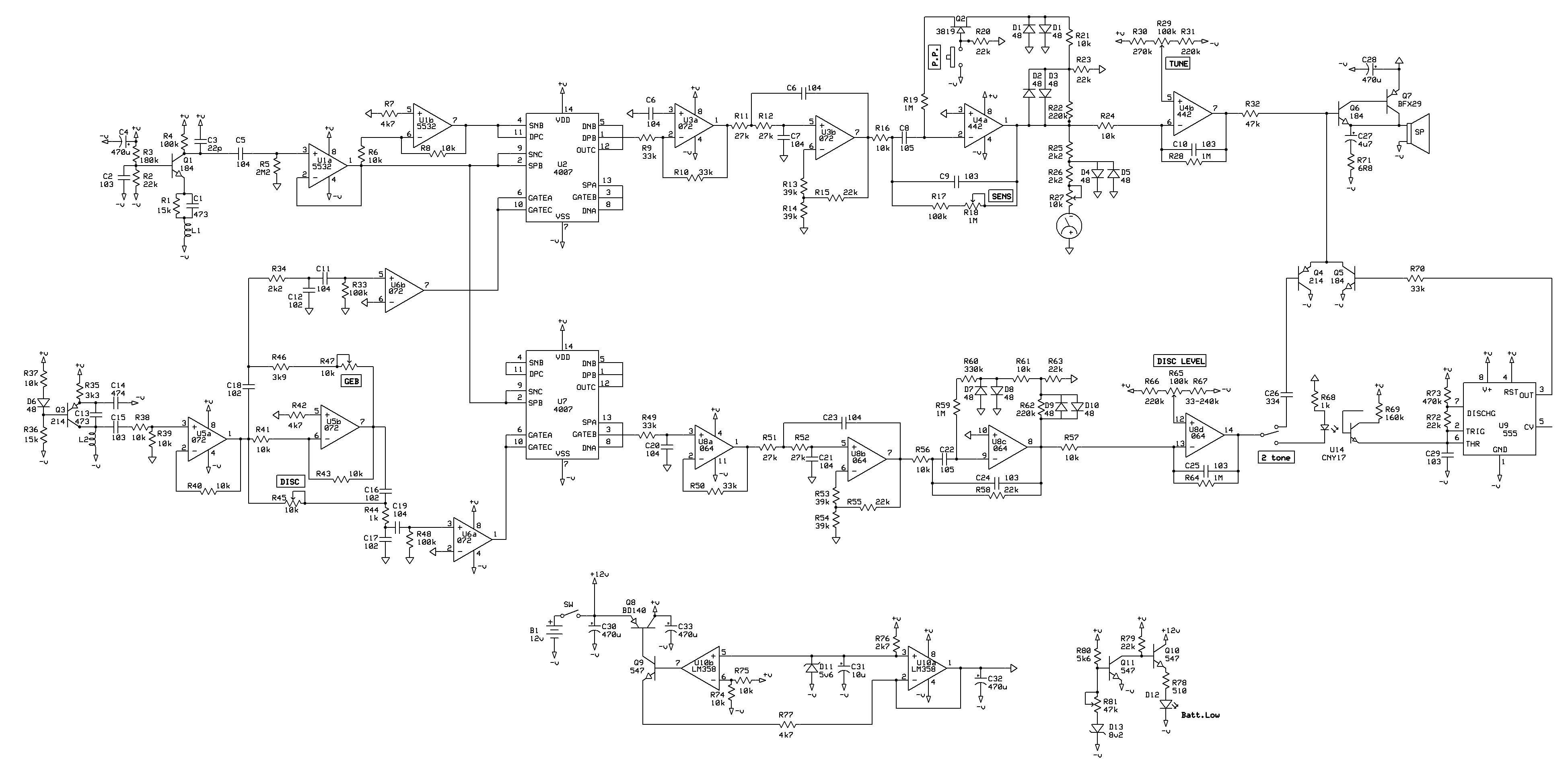

                        First things goes first; let's adapt schematic for easier view and let's put labels and designators in order.
                        This need to be checked for mistakes yet.
                          60turns tx and 60 rx coil the wire in the transmitter and receiver is 0.25mm frequency 15khz

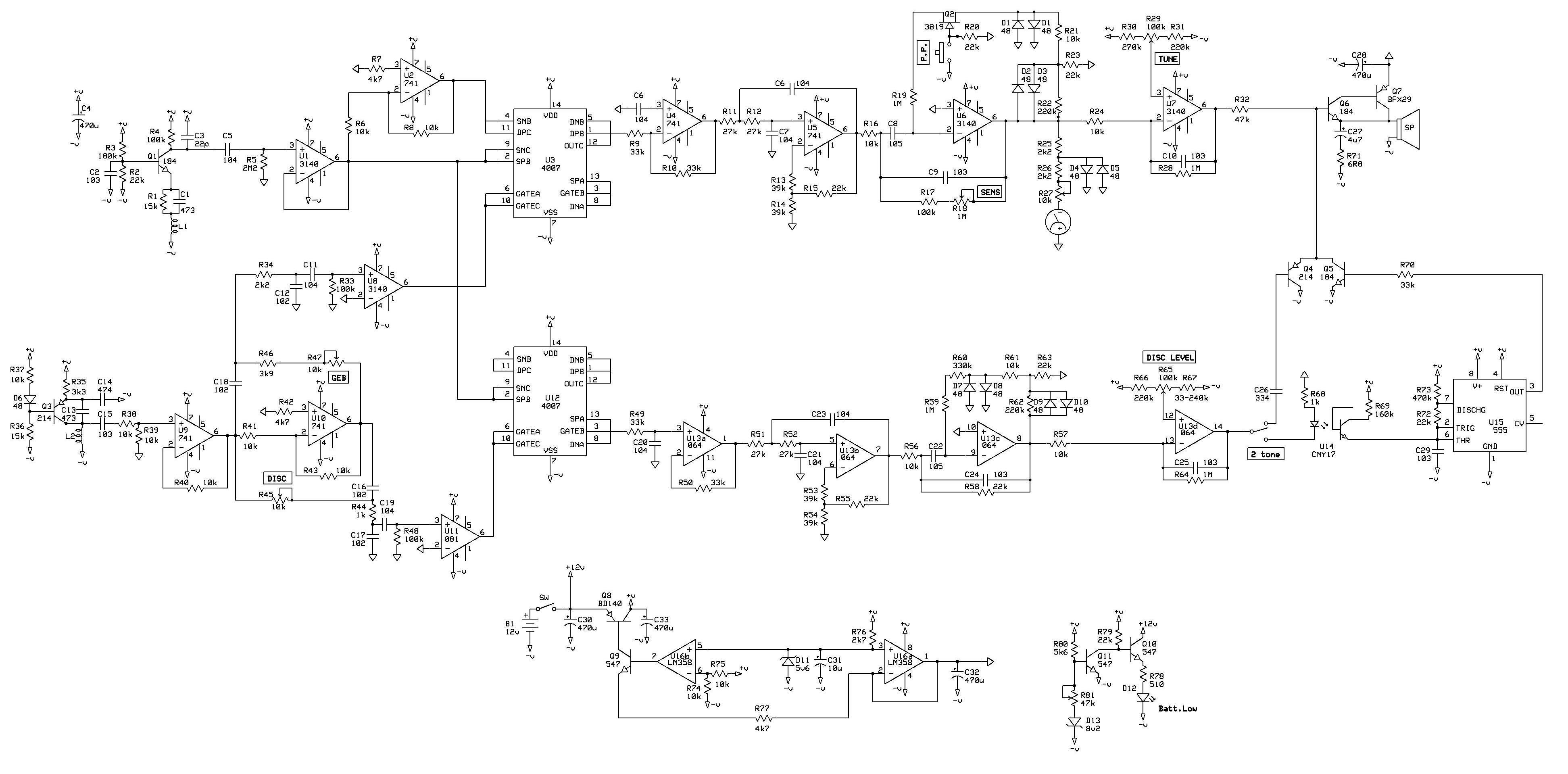

                            However... i would like to "modernize" some opamps and make it more compact at the same time.
                            Instead single i propose duals. And here is my proposition; open for corrections and more better suggestions.
                            That's why i also attach pakced file, which is editable lay format file, done in ExpressSch (part of the free ExpressPCB package).
                            So to anybody can open it, edit and add suggestions:
