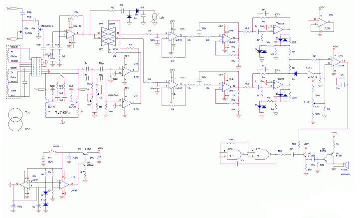

... and first "fatal" mistake spotted!
C and E at Q3 were shorted!
Corrected:Attached Files

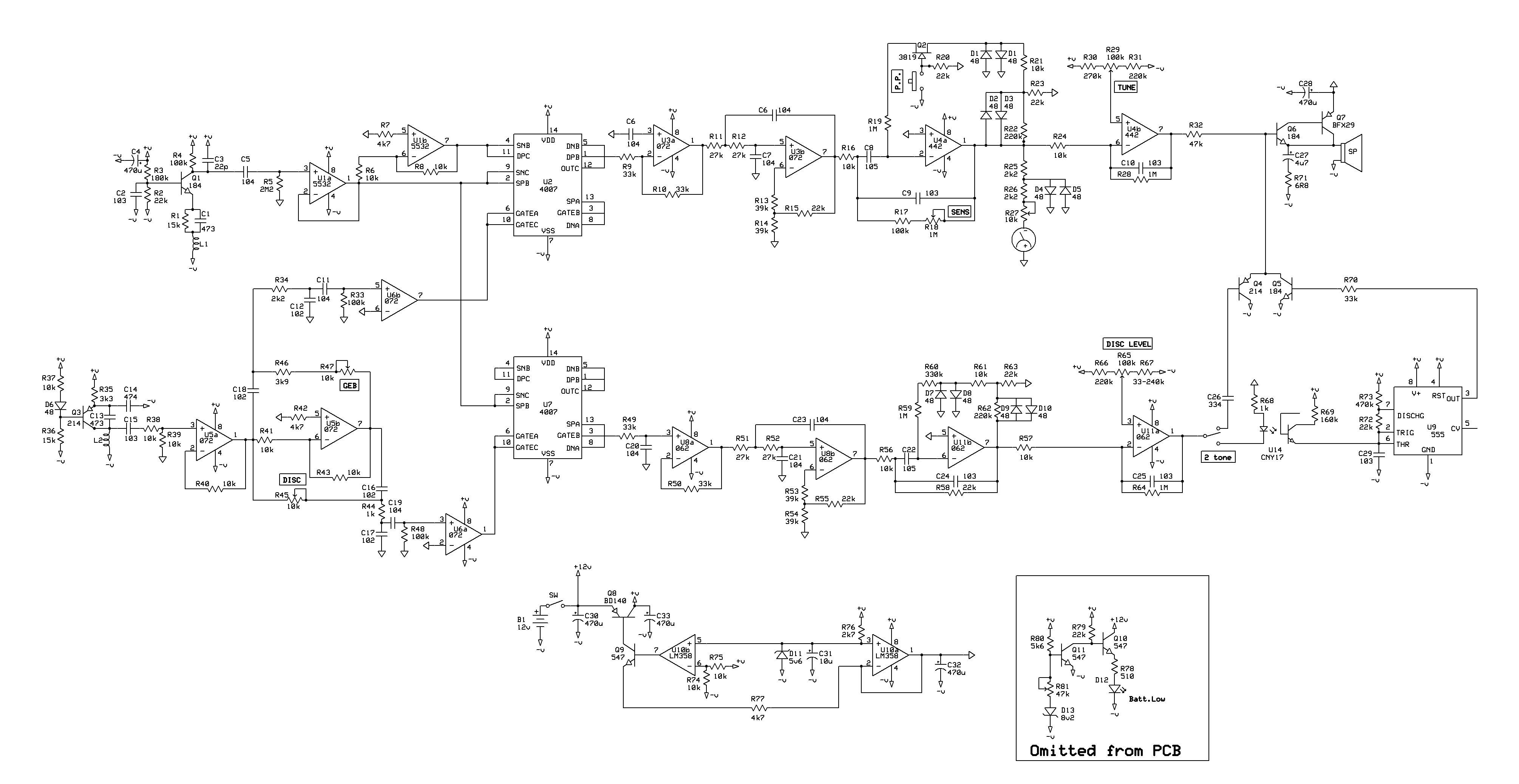

They say that this vlf detector in Bulgaria is called a violin or Gadulka but I'm not sure, sure colleagues from Bulgaria can say more about it...Back in 2006, when I visited Vladimir Lilov, the manufacturer of the Golden Mask detector he gave me a scheme that is similar to the exception of the receiver and transmitter.When I was repairing the Nexsus first model I remember that George used if I remember the same receiver and IC 4007.The scheme that Lilov gave me at the time was a scheme called Varna-Gadulka..
Hi,Originally posted by ivconic View Post... and first "fatal" mistake spotted!
Corrected:

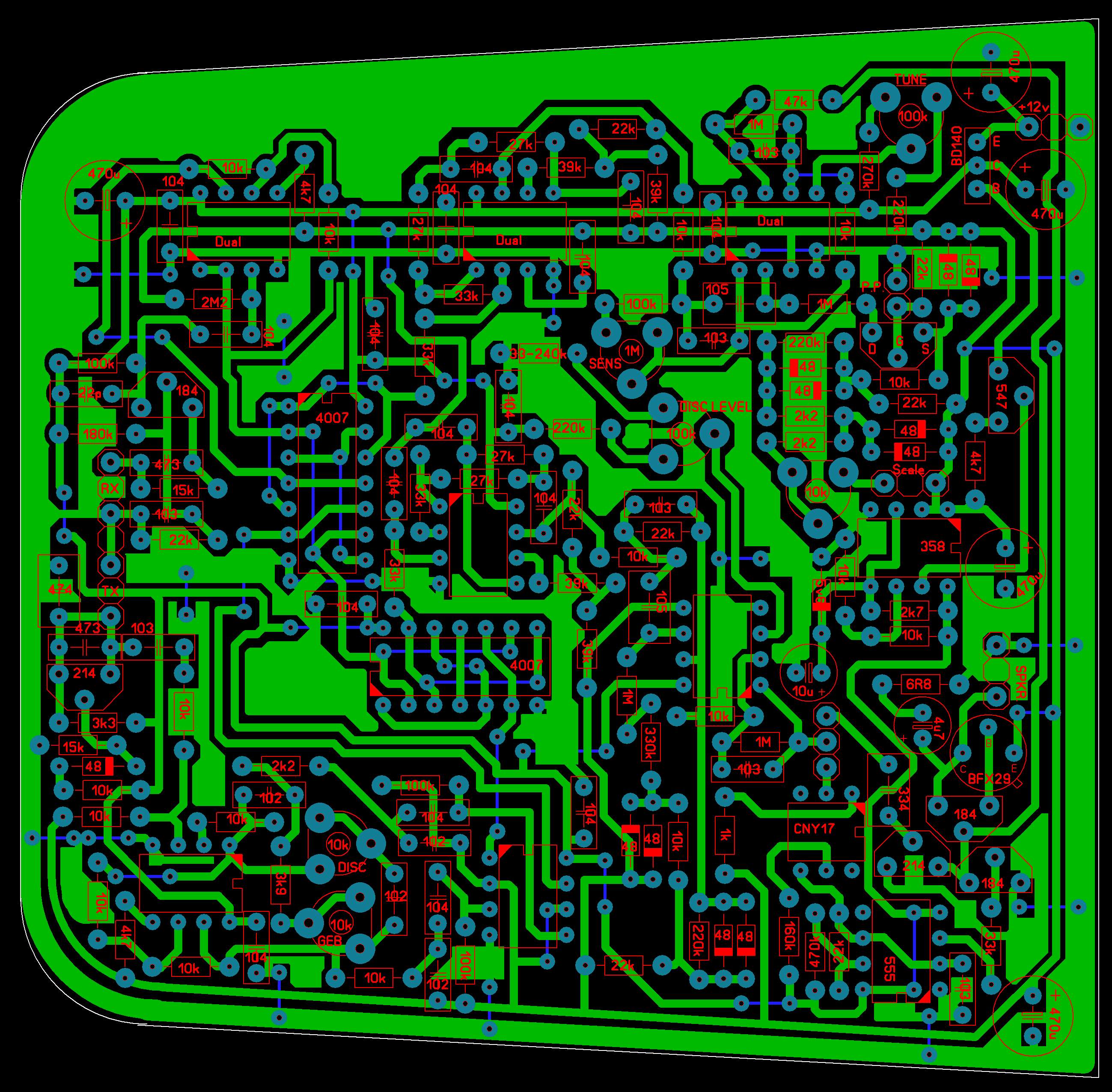

Ivica and my Orbit master,
If errors in the drawing have been corrected.
I want to make pcb.
My ivica master, according to which box did you draw the pcb?

I don't know if there are more mistakes, i assume there must be some mistakes more... or not, not sure.Originally posted by gurdal View PostHi,
I want to make pcb.
Kind regards
Gurdal
The purpose of the forum is to gather people and unite in joint work on an idea.
I quickly drew the pcb, it's not ideal, it can always be better.
But I am not able to find mistakes now, at least until a certain period of time has passed.
That's why you others are here, so do your best and check the draft.
Don't wait for someone else to do it.
The PCB is for my favorite box, it's a box similar to the Fisher 12xx series box.
Such boxes are made in Bulgaria. I have no detailed information.
