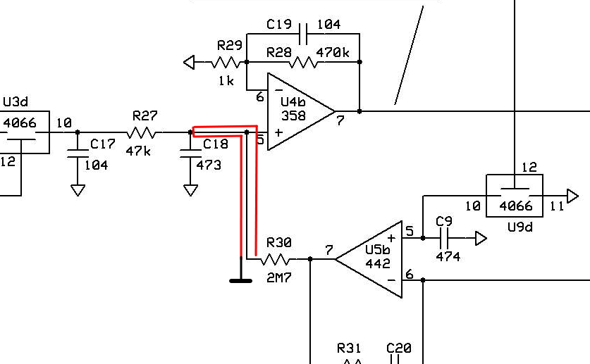

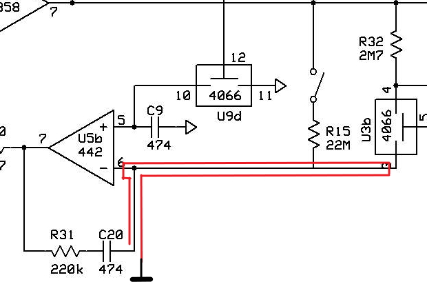

          • #65
            I dont think the drift depends on the TX.
            It depends of the guality of C7, C20... (C8,C9)
            • #66
              That too.
              Low leakage caps will certainly improve stability.
              But TX influence on the drifting is present too.
              I mentioned square wave signal and direct driving, that's the area i would like to explore more here.
              Not because of the present design as it is now, but because of some future upgrades that i am planning.
              Step at the time...

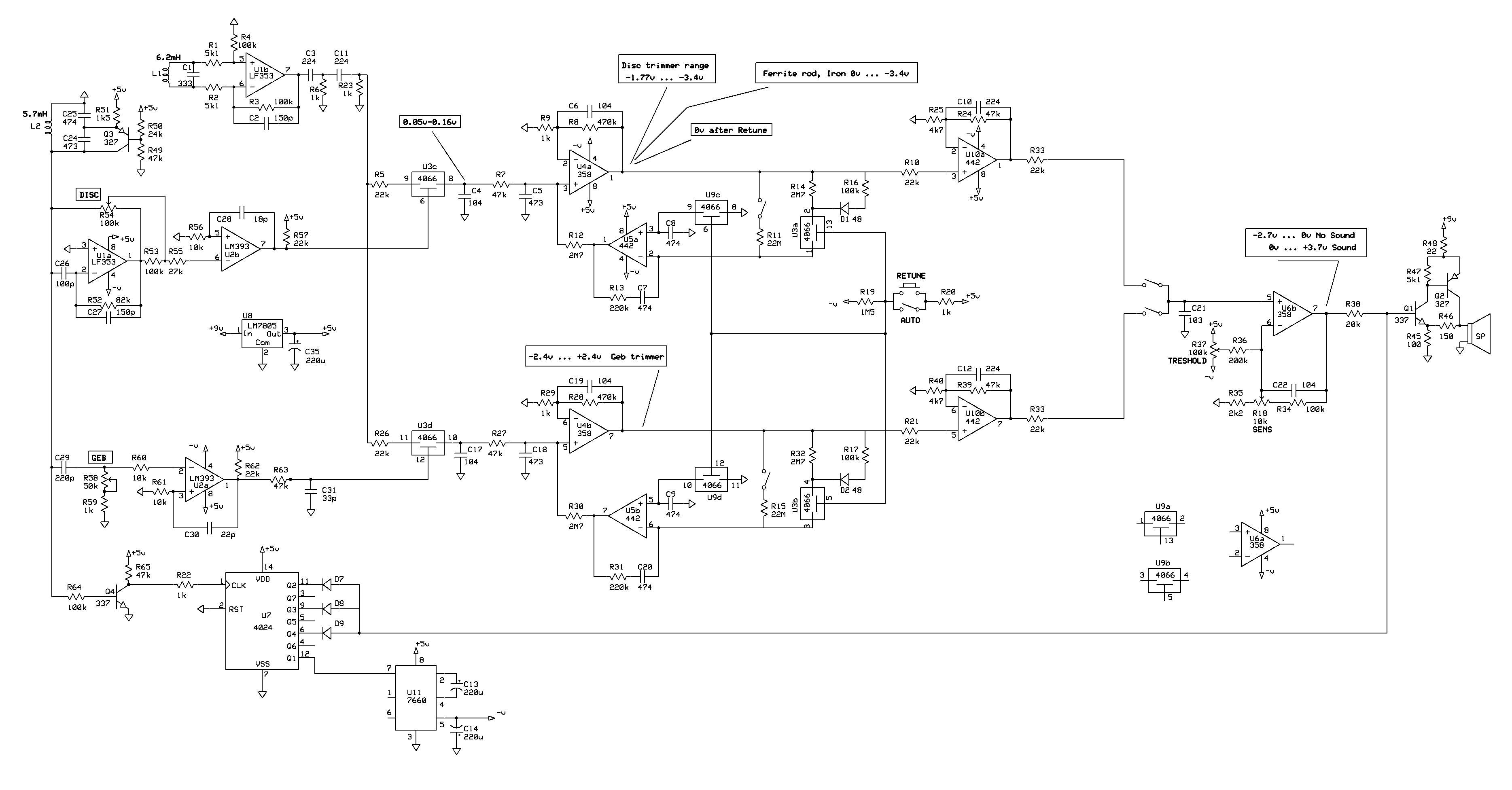

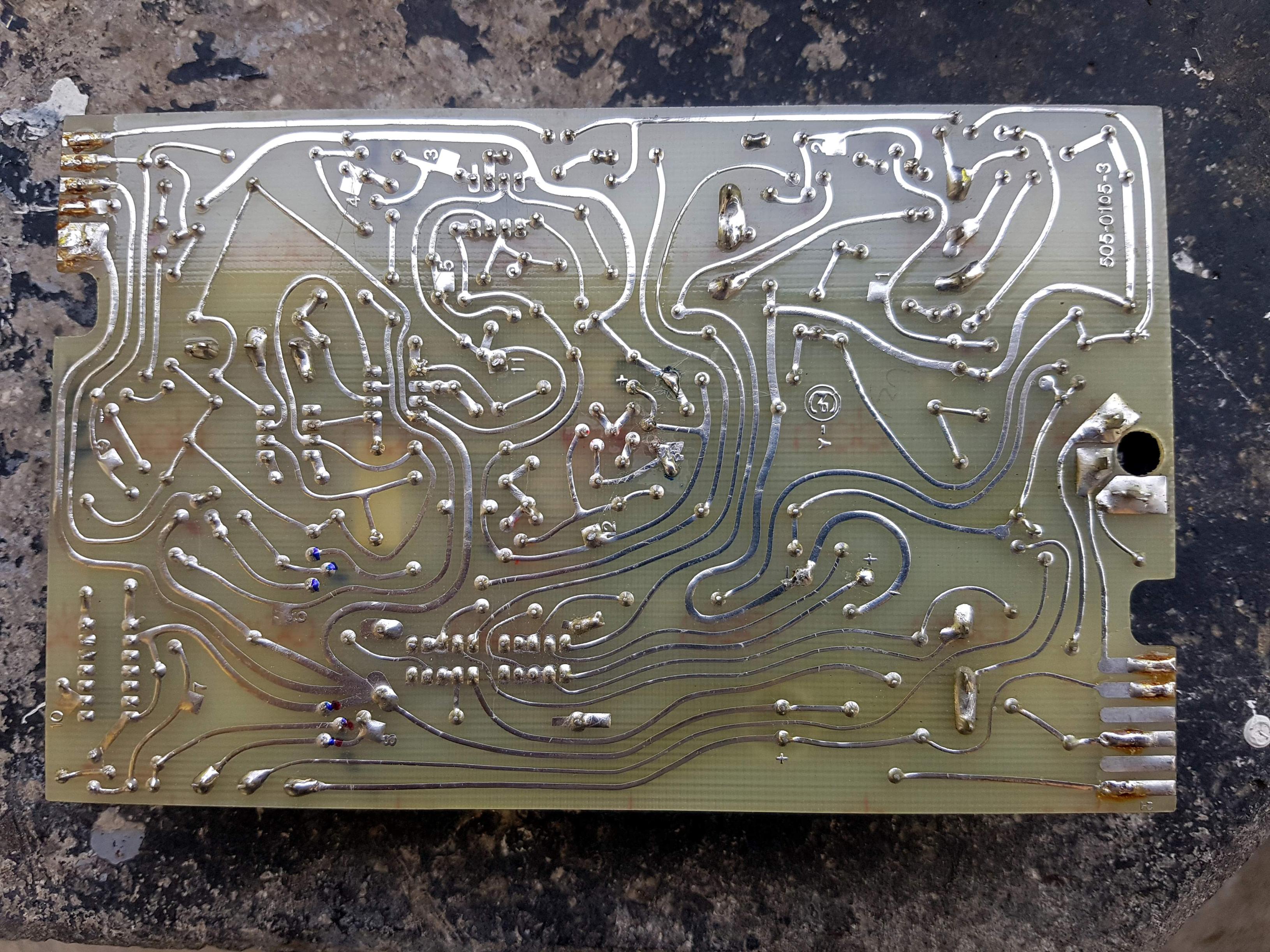

              • #67
                Negative voltage generation improved:
                • #68
                  That too.
                  Low leakage caps will certainly improve stability...
                  C7, C20, C8, C9 can be replaced, each by 2x1uF wired parallel.
                  That will improve the problem of the leakage.
                  Also use of film or foil type of capacitors will do.
                  (Plastic film capacitors (Metallized polyester film capacitors)).

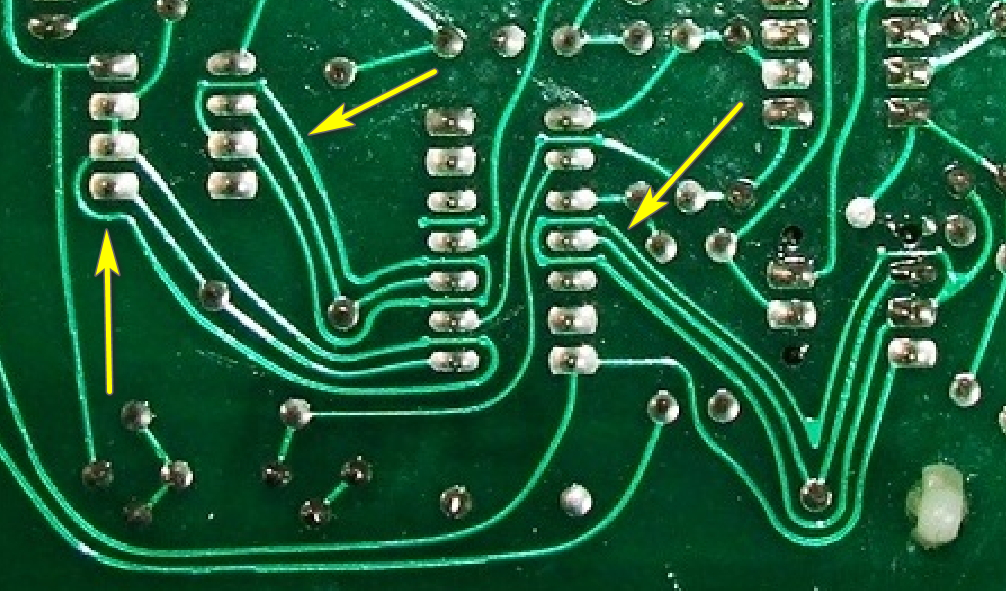

                  • #69
                    Maybe you need to apply * guard rings * on the PCB (in high resistance areas) , as done in Whites 6000? Then the leakage can be reduced
                    • #70
                      True!

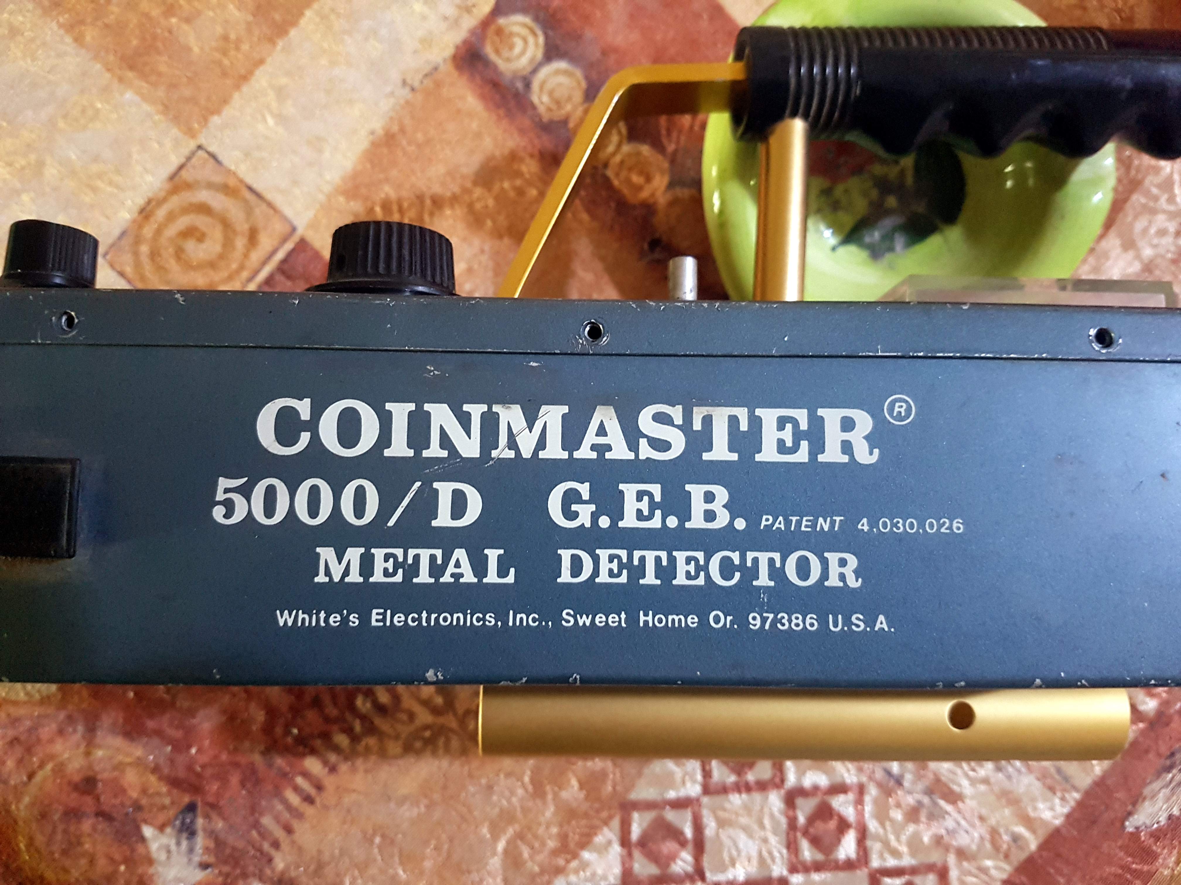

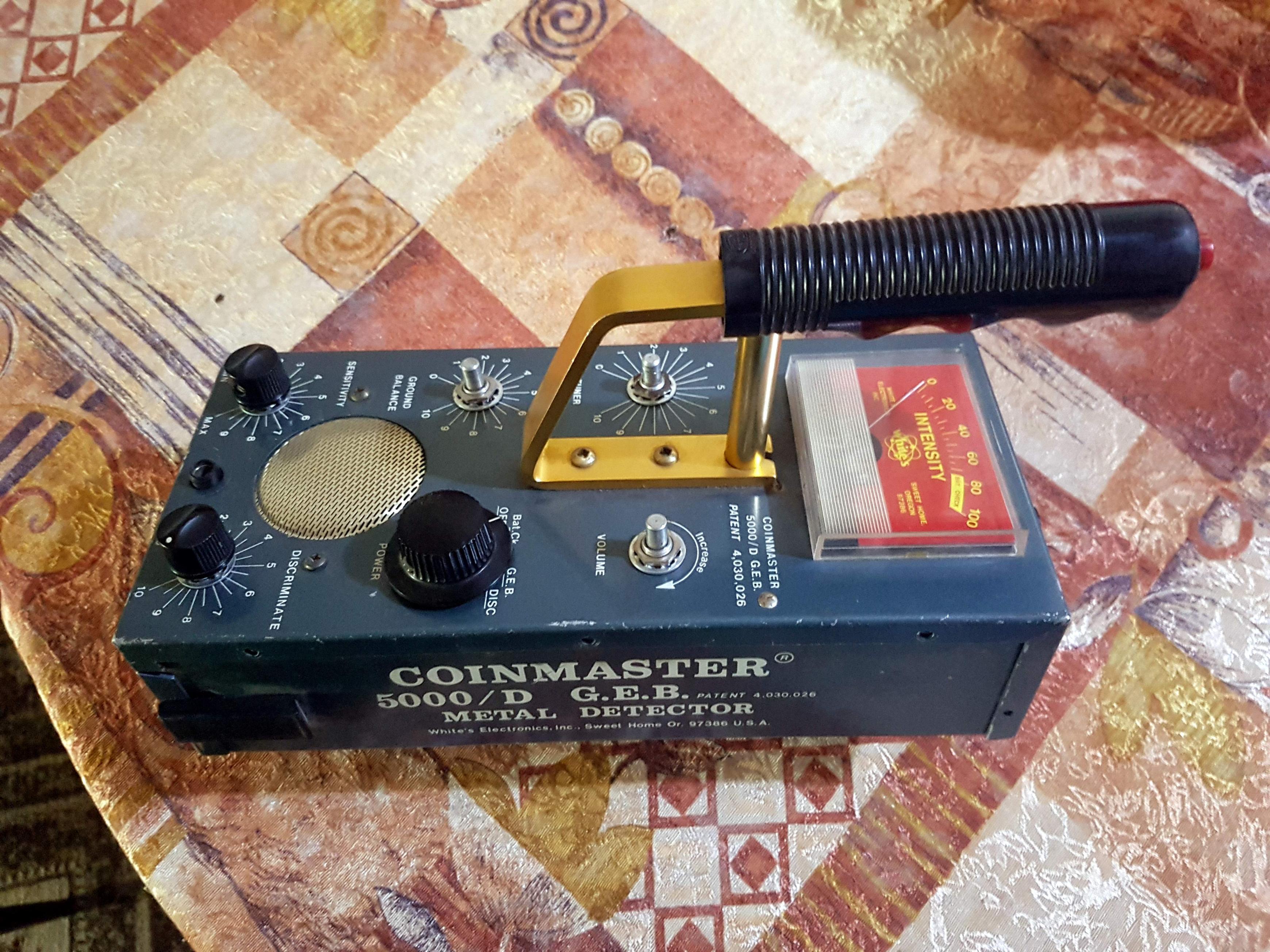

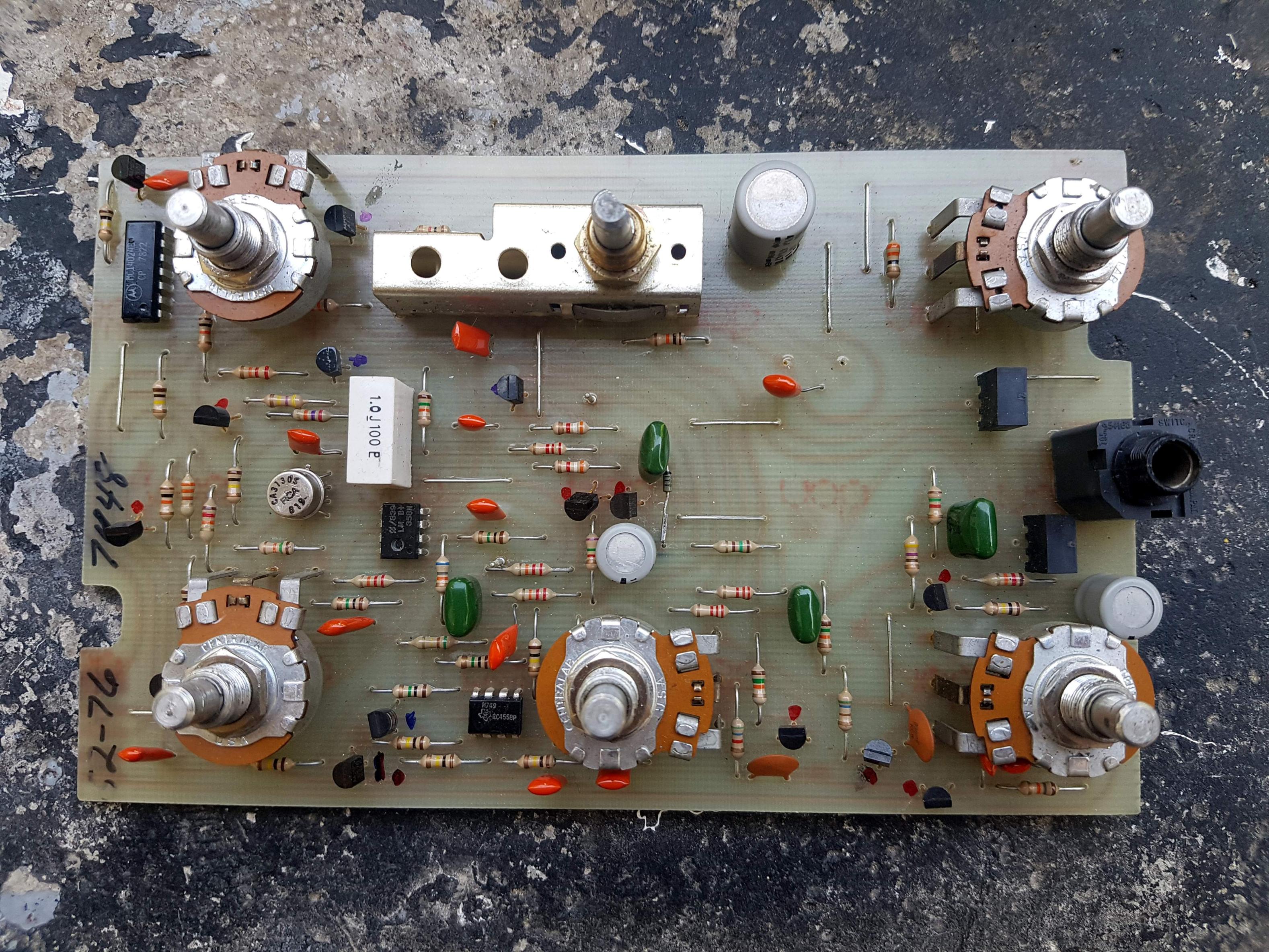

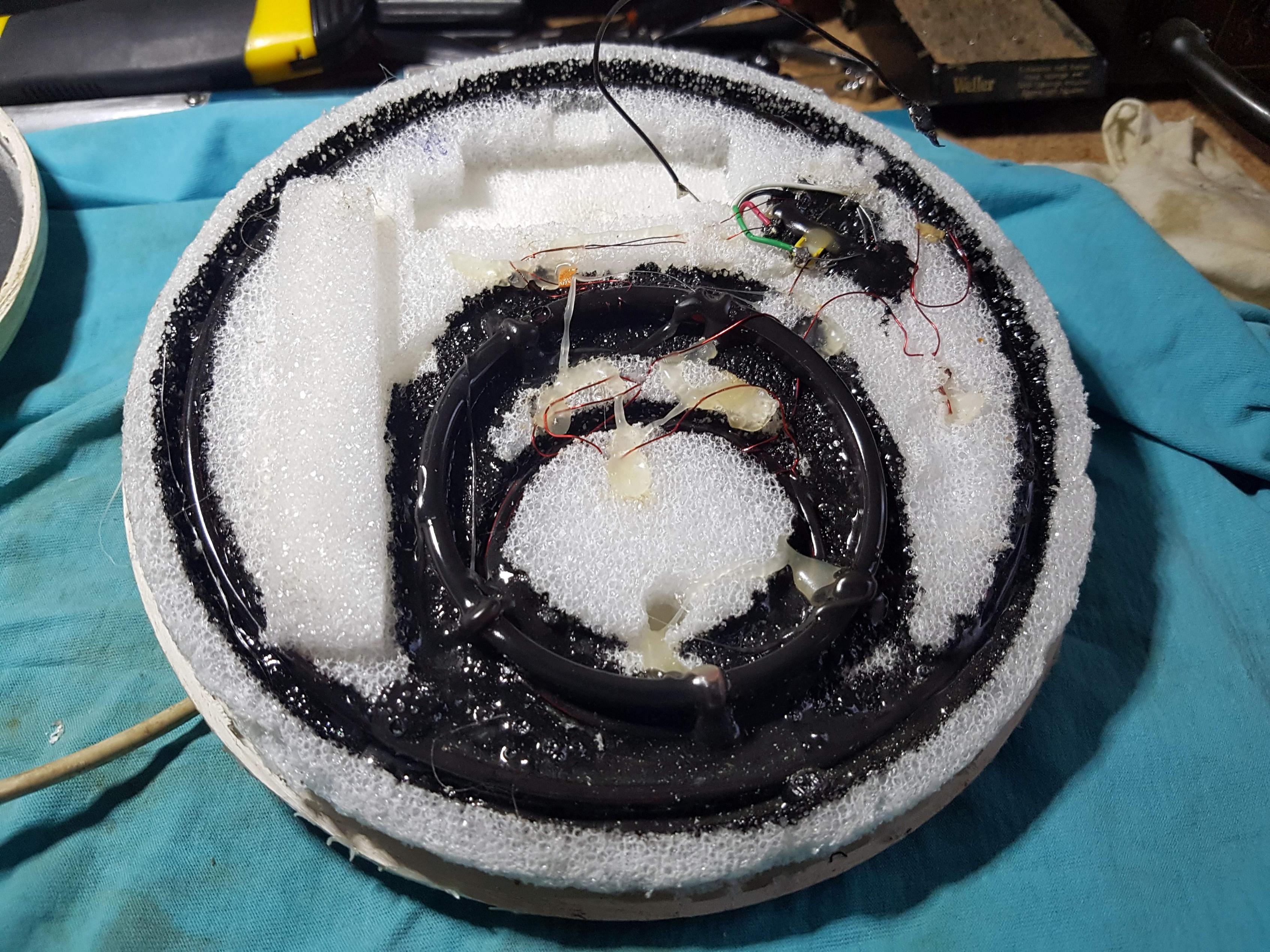

                              Crazy enough, as I've mentioned many times lately; some "higher power" rules our lives ... or maybe it's still true that
                              if you "fix" something strong enough in your head; that will happen to you.
                              So, yesterday, without any prior planning, I stumbled upon White's Coinmaster 5000 ... which is defective, but it will be a pleasure and an easy job to fix.
                              Someone opened the coil before me, but I don't notice any traces of damage. It seems to me that all the wires are intact.
                              There are some components that are covered with a dark and strong mass.
                              Maybe it's some "pre-flood" epoxy! I didn't dare "dig" further, so as not to damage anything. First I will fix the machine and then I will see if the coil is correct.

                              • #75
                                I tried to measure the coil on the connector side. But I only get resistance values ​​but not inductances ...
                                Either something is wrong with the coils, or some internal component prevents the inductance from being measured.
                                So I could use the help of someone who has information about details at this coil.
