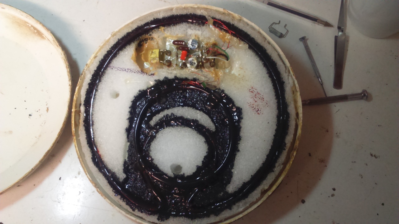

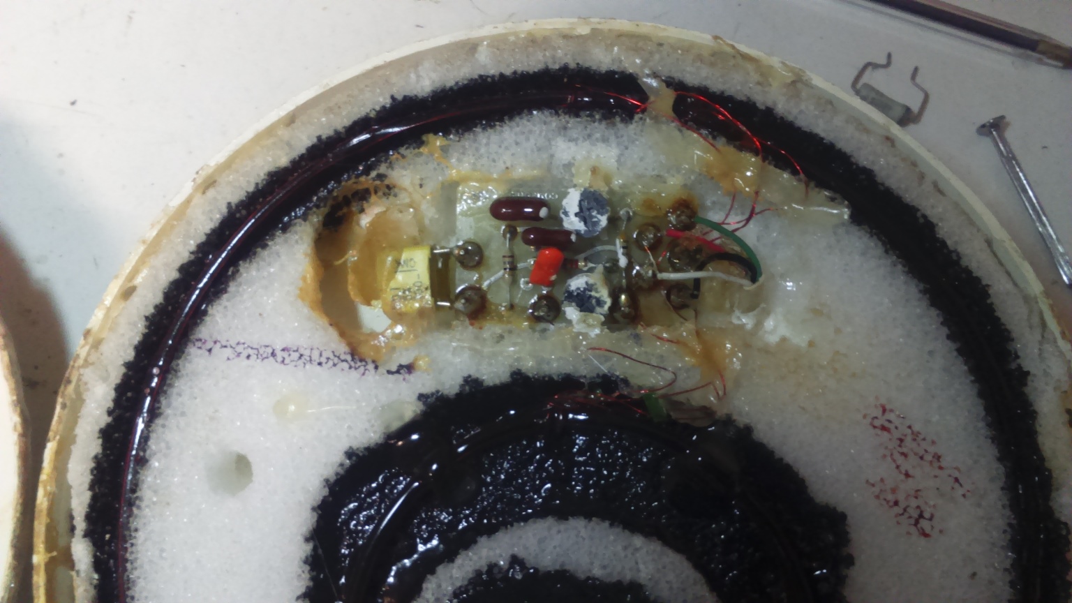

    I have such a photos... There is a board with elements inside. Unfortunately no other information
    • #77
      Originally posted by ArchibaldSTM View Post
      I have such a photo... There is a board with elements inside. Unfortunately no other information
      That's what I am talking about. Unfortunately the "mass" is so strong and hard; I am almost sure that tiny wires will be broken if I try anything.
      I have bad experiences and lot of bad results in numerous attempts to "decipher" inner composition and wirements in coils.
      Usually I don't mind. But this time it is about very old and (in my case) rare and hard to obtain coil.

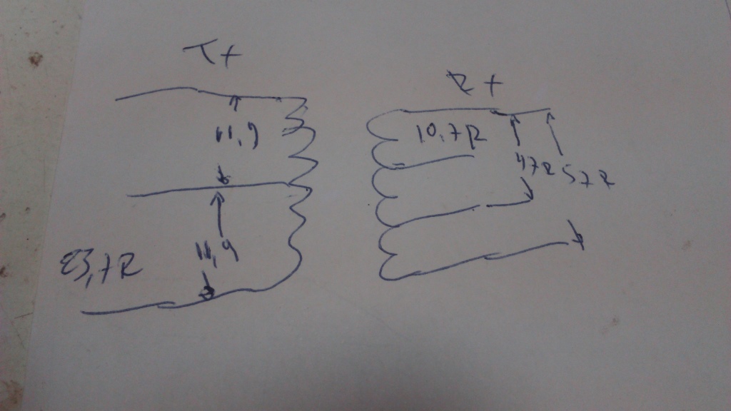

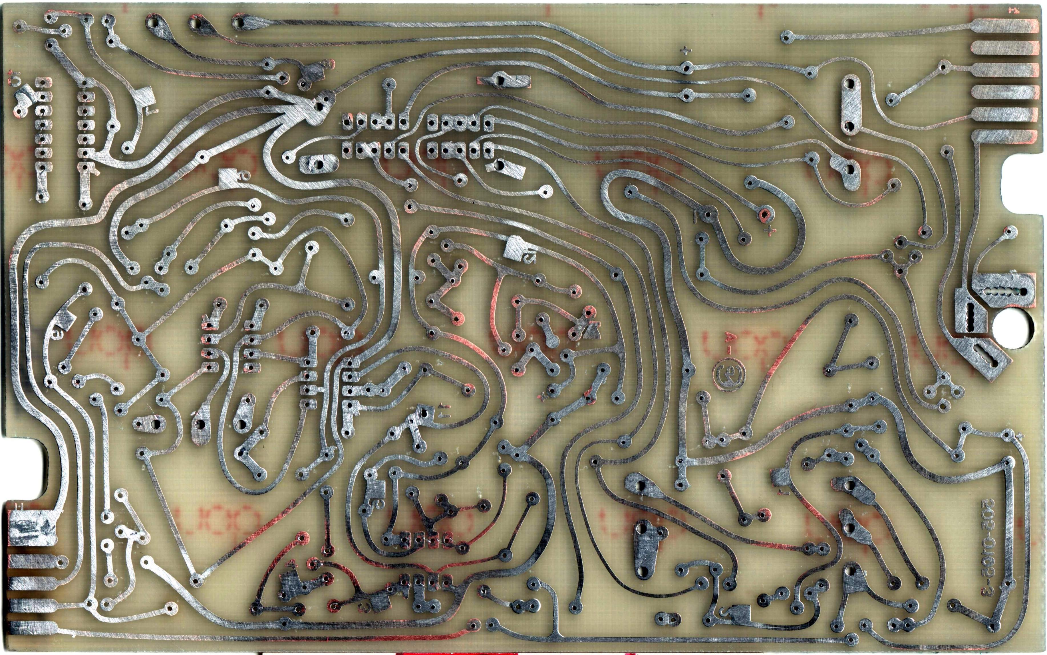

        And such a scheme clear things up?Although it's a little different... Hmm
        • #79
          Wouldn't such a scheme clear things up?
          Thanks!
          I had it.
          Most probably this coil is alright and I wouldn't need to do anything about it.
          But I wanted to know inductances... maybe I would want to try to make DD coil for it.
          Or larger one.
          Never mind. First to fix the machine and later i will see.
          Thanks gain; previous 3 pics are valuable for me.
