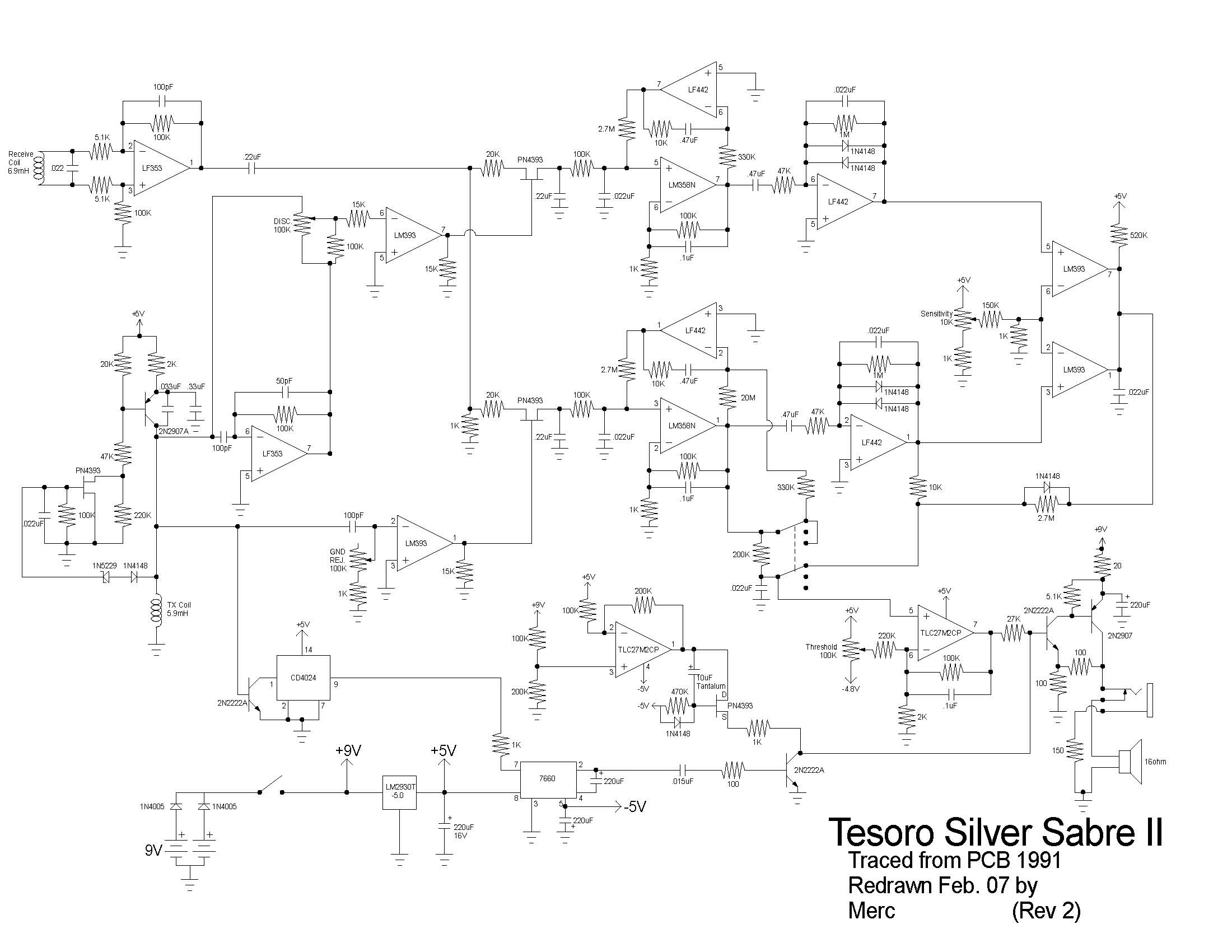

        I have a hand drawn Silver Sabre II schematic that I need to double check and redraw in CAD. I still have my SSII if you need voltage checks.
        Merc
          I have one shematic that i don't know if it is SabreI or II:confused: . I attache it here

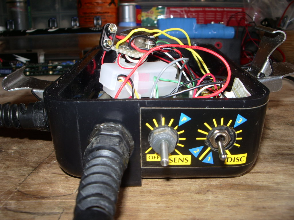

              I've an old tesoto siver sabre II with a very low depth power, about 10cm for a coin only.... normal?
              Alain (France)
                No. I would say that is not normal. I have a Silver Sabre II also. There is a schematic posted on this site and I can make some comparison measurements if needed.
                Merc

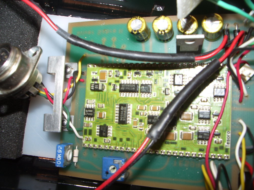

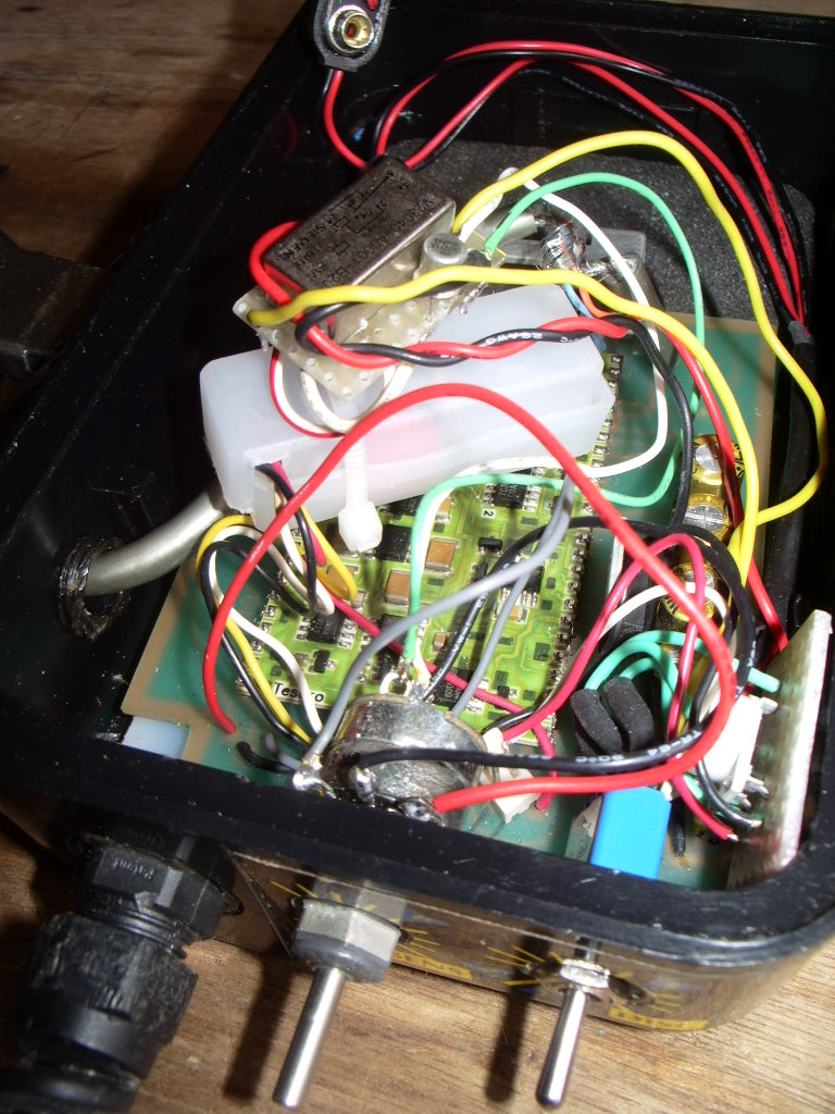

                  hi Alain. can you share pics of your board inside from both sides at sunny day hi-dif? can you measure inductivity of your coil? silver sabre II schematic is not. there are SS plus and SS schematics. I will be able to tell you more if you give the pics.
                    Here's one that Merc created earlier ->
                      thanks for yours answers, I will photograph the electronic circuit and verify inductances... and I'll post it...
                        My Silver Sabre 2 in his surf master box....
ID:	336872Click image for larger version
ID:	336873Click image for larger version

                              The PCB in your pictures is from a later "hybrid" version. It has that large surface mount PCB in the center. The Silver Sabre II I drew the schematic from has no surface mount components. The schematic is probably very close to correct even with the layout differences.
