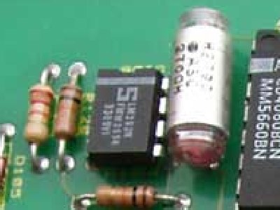

        BTW I think that the IC dip8 near the 2700pF cap is an LM311.
        I say that cause I know it's possible to make a good/stable osc. circuit with that comparator and few esternal components.
        The 4060 is probably used to div the osc. frequency to trigger other parts of the circuit (ripple counter).

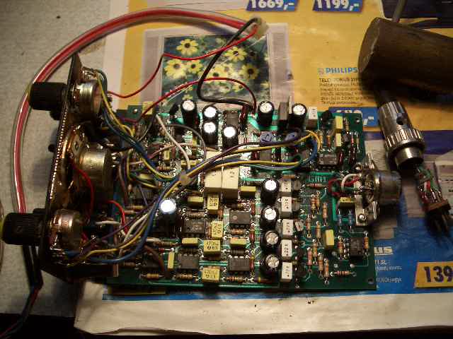

          hi Max Out Of Service.
          the Cobra (great drone at photo I believe) PCB is not such I sent earlier here. I see absoliutely another schematic layout than I did wait of. it is good working... although I did buy and hope to see a broken detector.

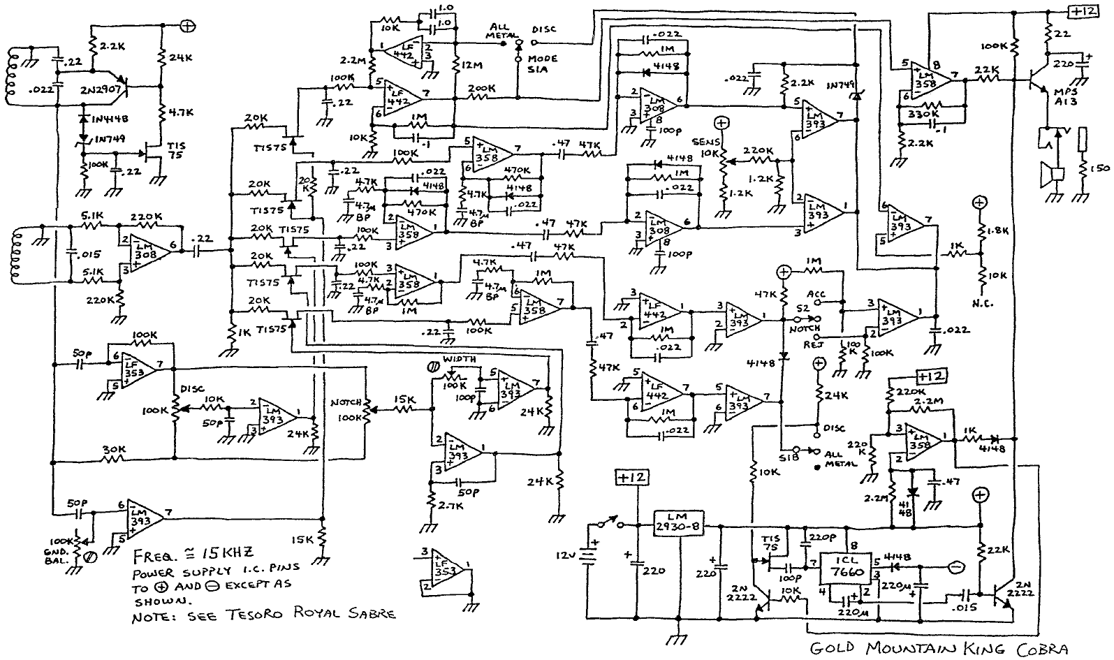

                    hello, Cobra is again. some problem I meet of. a schematic has not designations as the PCB also. can anyone offer better way to mark all details to its accordance? or, may be anyone have the schematic with the designations?
                    trully
                      And THAT drawing was done by William Lahr. I recognise his style and handwriting. This guy reverse engineered ALL the old Tesoros.
                      Who is he? I thought he was a MD designer for Whites, or Garrett. Where is he these days, anyone know?
                        Bill Lahr is the wonderful guy. He designed for Whites - Surfmaster PI and Classic series detectors. The majority of schematics are available thanks to Bill. Always I'm very admiring him. At present Bill has very serious problems with sight. Despite it is keeping the jollity. For many years, every day I'm receiving the new portion of jokes . Currently he is living in California and its restoring your Jeep from 1966 of year.

                                so I am passing on the lamp... here are photos of PCB of CobraII I got from Mark aka Altra. thanks Mark again.
