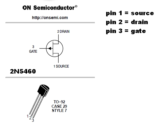

    Yes i can buy 2N5460 but i'm not sure if wiring i've designed is correct (with 2n5460)
    pins of 2N5460 and KP103 i think are different.
      Hi Cordius.
      Are different.
      C = collector= drain
      3 = base = gate
      N reversed = emitter= source
      in the original:
      1 - S
      2 - G
      3 - D
      Best regards Chris.
        Hi Cordius.
        Terms of the original PCB converted 2 of 3 feet with 2N5460.
        Source goes to 555.
        Best regards Chris.
          Ok chris. I invert pin 2 and 3 of 2n5460
          thank's
