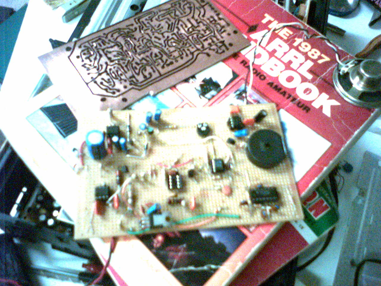

        Hi Esteban. I found the LM-709 so after 10...15 days i will be ready to try it. Today i found the PCB. I moved in new house and exists big untidiness. (the other pcb at photo is for Delta Pulse)

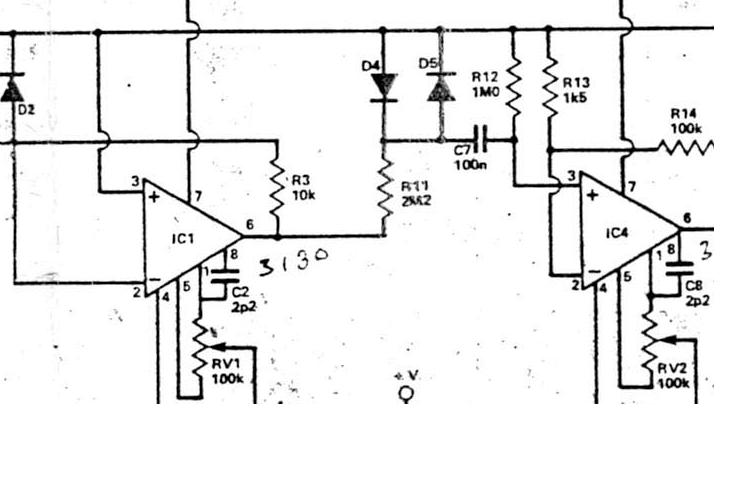

          I have some 709 in metallic and plastic enclosure. I found near 10, I'll buy all. The 3130 metallic version found 20 and I buy 10. The Diana PI uses 3130 as you can see in this part of the schematic. Diana PI was published by Hobby Electronics, September 1981 magazine. This project don't have audio, only microammeter, and runs via a VN67AF N-Channel Enhancement mosfet transistor. Think will be easy change by another power mosfet.
            Hi Esteban. Can you send me the Diana schematic to see the transmitter. By the way something dont like to me with the 3130 (R11,D4,D5).Geo

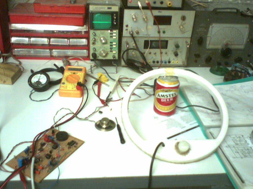

              Hi Esteban. Yesterday i tried the project. Because i had a problem with the audio i checked the sensitivity with the meter . It had a medium sens. So with a coil 25 cm it detect a coin 25mm (2EURO) at 23..25 cm , a can of beer (330 ml) at 60 .. 65 cm and a PCB 13x7 cm at 60 cm. Today i will try to modify it for better results.

                    Hi Esteban.
                    Yesterday it detected the coin (2Euro) at 28 cm. I will inform you again when i will detect the same coin at 30cm at least.

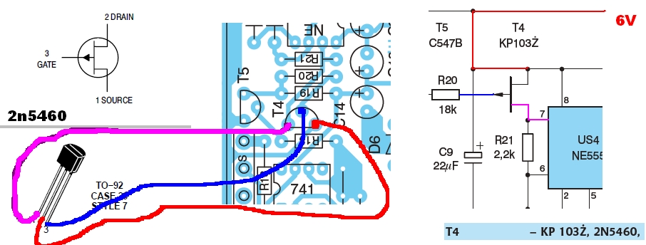

                      excuse me if i resume this old thread.
                      I want to try to build this PI for home experiment and study.
                      I can buy all original components like LM709, BDX53A, LM741 but i don't find KP103Z well i can buy 2N5460, it is present in the component list.
                      It's correct new connection?
                      excuse my bad english.

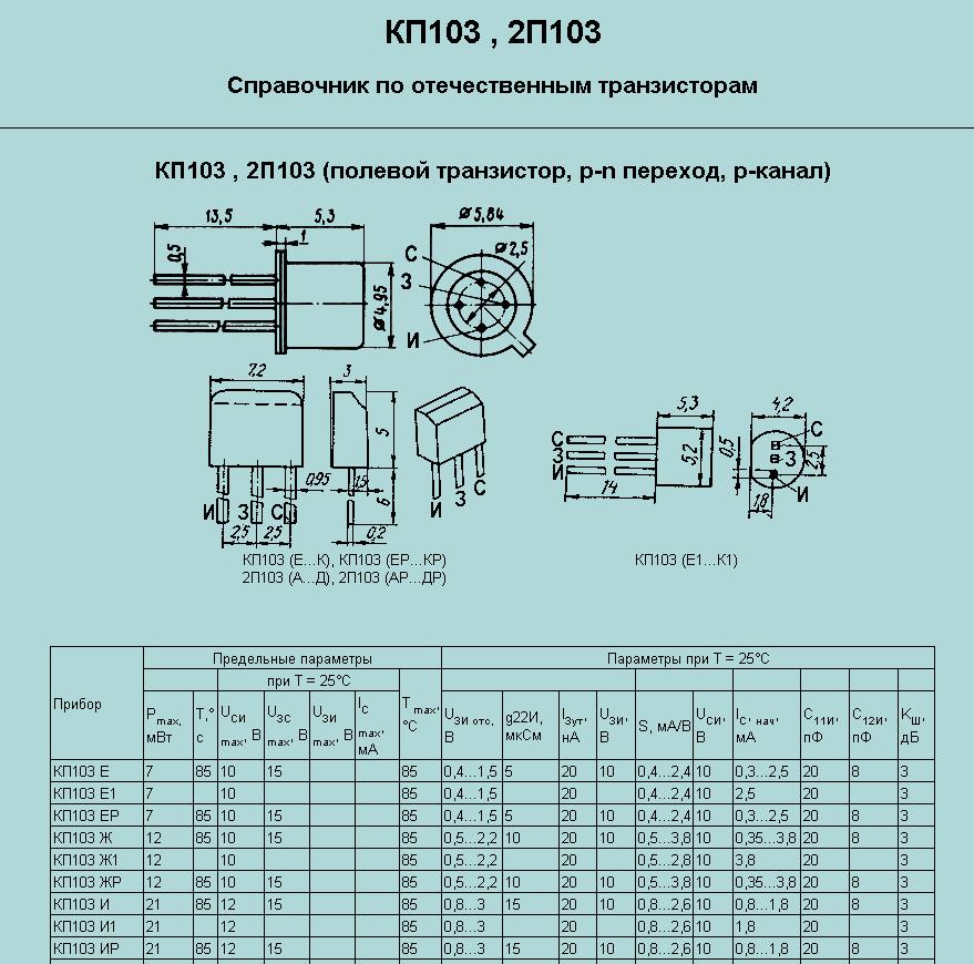

                        KP103 is soviet made FET... what western displacement... I am not in course...
                        http://www.5v.ru/ds/trnz/kp103.htm
                            tank's KT315.
                            I think that original mounting plains is with KP103.
                            I dont' understand the russian datasheet.
                            I think pin C in the drain, pin 3 is the gate and pin reverse N is the source.
                              Hi Cordius.
                              In the table of the elements are given alternatives: 2N5460, 2N5461, 2N5462.
                              Best regards Chris.
