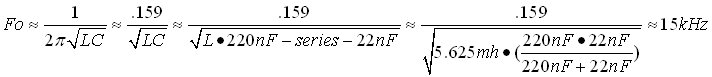

            I believe I wrote the correct formula last night BUT when I calculated the parallel combination of 220nF and 22nF I used the series combination formula (for whatever reason) and got an incorrect answer. (doh)
            I think the correct answer should be closer to 14.5kHz. That is about what the oscillator does in LTspice.
            Unfortunately I can't seem to punch the right numbers into my calculator this morning and keep getting a very different result from what I got last night.
            I hope that's not an presage of how the rest of my day might go. I don't want to cancel a Saturday!
            • #66
              mistake in formula
              Now, that was stupid. I arrived at a more or less correct answer because even though I wrote parallel, I used the series combination of the 220nF and 22nF capacitors. The coil sees the 220nF and 22nF capacitors in series and the output frequency is approximately as shown below.
              LTspice outputs about 14.4kHz with a 5.625 mH coil and 21Ω series resistance, 1234pF parallel capacitance. I add parallel capicatance in the coil to try and duplicate interwinding capacitance - but I have no idea of the real value. 1234 might be the wrong number but zero would also be wrong.
              Besides interwinding capacitance we would also need to include cable capacitance in the calculation. So I just make a guess and call it 1234pF.
              While I am on the subject, the receive coil and tank circuit would also affect output frequency to a small degree but I'm not going there!
              Two parallel bars ( '||') depict a parallel combination. Does anybody know shorthand for a series combination?

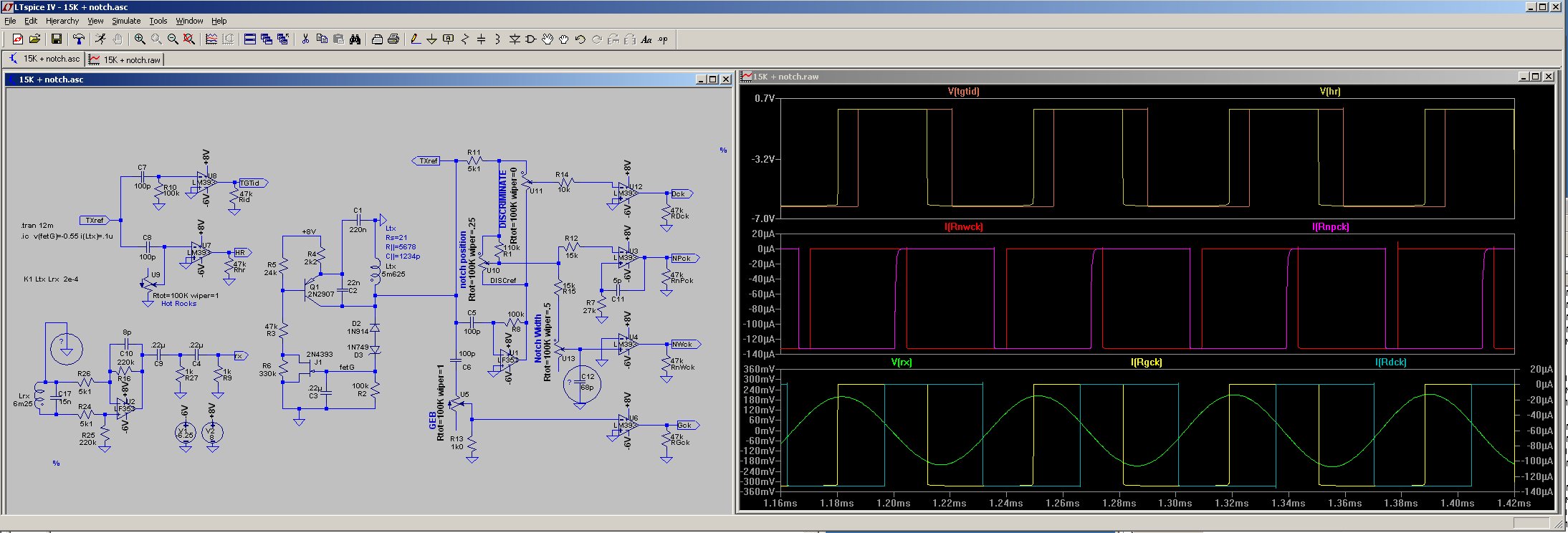

                Phase simulation file (LTspice)
                Comparing the Golden Sabre and Toltek, I see very little difference in the notch, discrimination and ground balance circuits but I already said that.
                The filter circuits are different and of course the Toltek 100 adds target ID. I'm not touching that today.
                This is the basic tx/rx and phase reference circuits as best as I can duplicate them. There are two different pot symbols in my simulation file and the only difference
                is the way I drew them. Either an arrow points to clockwise, or else a little o indicates counter-clockwise. I can not be certain they are installed with
                the proper orientation because I don't have a Toltek or Golden Sabre to look at for verification... so I connected them the way I think they are supposed
                to work. If somebody knows otherwise I surely would appreciate a heads-up.
                There are two things I need to point out.
                1. The Toltek drawing does not show a connection to ground in the transmit coil although I believe that there is a ground connection in the coil connector. The
                receive signal lags by about 20 degrees without the ground, which would probably be a malfunction.
                2. I added a 68pF capacitor in the notch width circuit. Without a capacitor the width control has no effect. I got the 68pF value from the
                Golden Sabre schematic.
                5.7kΩ parallel resistance is added to the transmit coil - which would equate to loss in the circuit. I arrived at that value through trial and error.
                Everybody who runs this simulation should remove the parallel resistance and watch the transmit signal for about 10ms and see what happens.
                I think that all the necessary symbols and models are included. If something missing - let me know. Some of the extra
                opamp models in opamp.sub and comparators.sub might not work. Nothing I can do about that.
                One more thing: I modified my JFET symbol and maybe some of the others. When your copy of LTspice reassembles the simulation
                file there may be some skewed components and missed connections that you will need to correct.
