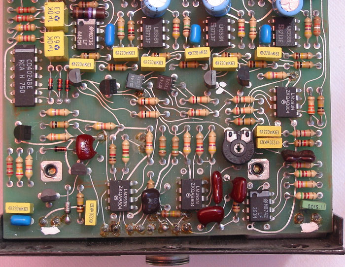

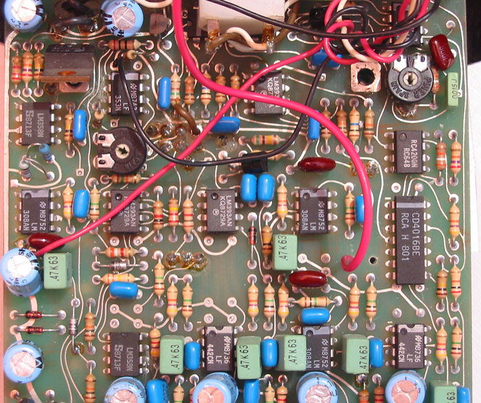

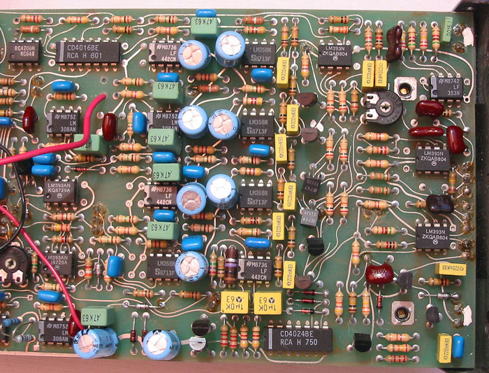

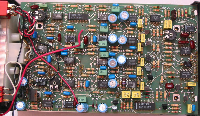

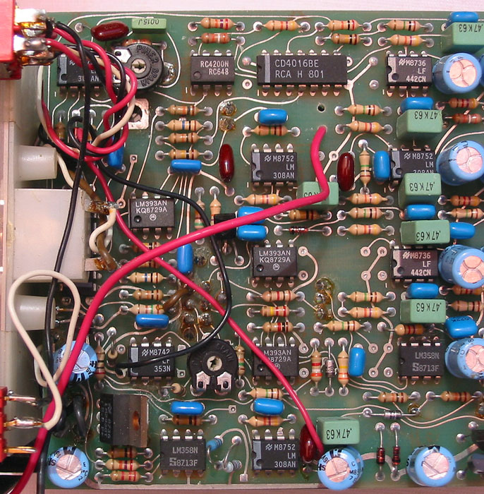

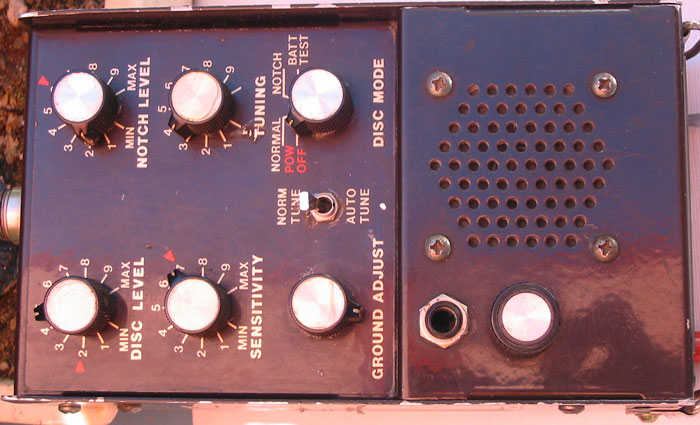

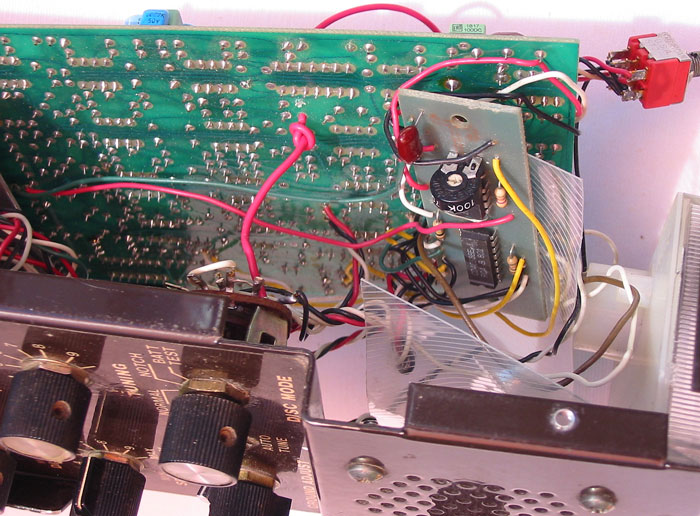

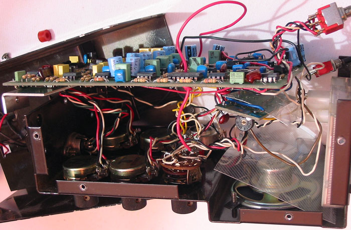

          • #51
            Looks like the one in the pics has been modified. Is that some type of volume control next to the speaker?
            • #52
              more pictures
              Hi Alexismex
              Thank you ,pictures very useful ,can you upload
              More pictures ?
              Best regards.
              • #53
                Ello forum,
                yes is a volume control For the photos i think i show all because to take pictures of the pcb under you must disconnect a bunch of wires and in this moment i can not ok -In the photos you can see the capacidor for the receive coil and for the transmit coil you see a small white mark ... and a 0015 i near LF353 in the last photo, ok
                • #54
                  helpme
                  Please post it anyway.
