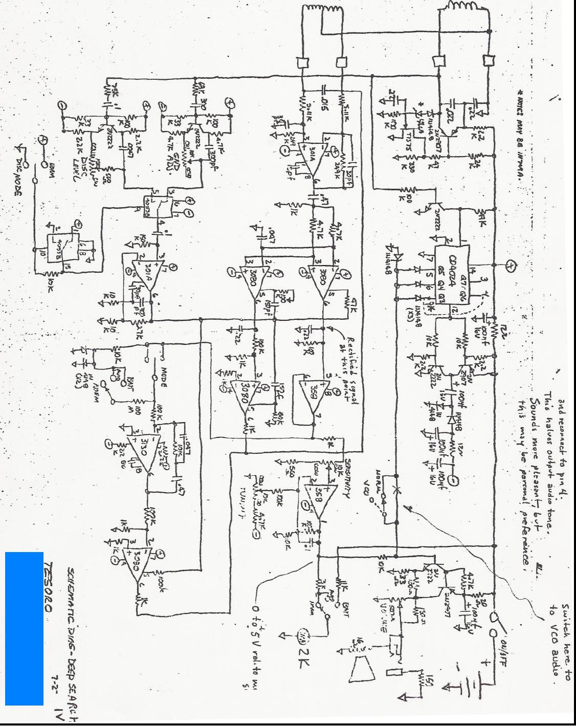

                  Well I think I'm done. Here is Rev1 of my Toltec 100 schematic. Please remember that I started from nothing so the IC numbers(and transistor numbers) on the drawing were assigned by me and may or may not agree with other schematics for this machine. Please feel free to point out any mistakes and I will correct and repost. Also, I have the original manual which I will try to get scanned in and post.
                  Enjoy,
                  Merc

                      Hi Merc,
                      nice to see it completed. Thanks.
                      I found an error: cap at RX coil is 0.015uF = 15nF not 0.015pF as in drawing.
                      I suppose cap at RX preamp is 5pF but maybe on Toltec100 it's 8pF : have you measured it out of circuit ?
                      Best regards,
                      Max

                        Hi! Merc
                        That's a big work!
                        Thanks! a lot!
                        On your Rev1 drawing, check at the control wires of U18A and U18D.They are not connected.If you look at pin 2 of U18A,the first wire connected is the one who should be conneted to the control wires of U18A/U18D.(in according of your previous drawing).
                        Best regard.
                        JF

                          Thanks guys
                          Thanks Max for pointing that out. I have corrected this. I double checked and the bypass capacitor across the feedback resistor in the receive circuit is an 8pF.
                          Northerntrowel you are also correct. I have corrected and here is rev2.
                          Keep'em coming!

                            Hello Merc.
                            Thanks for the circuit ! Can you check the 47k resistors in the volt.conv. think it must be 4k7 ?
                            I have send you a mail, it came beck, is your mailadres correct ?
