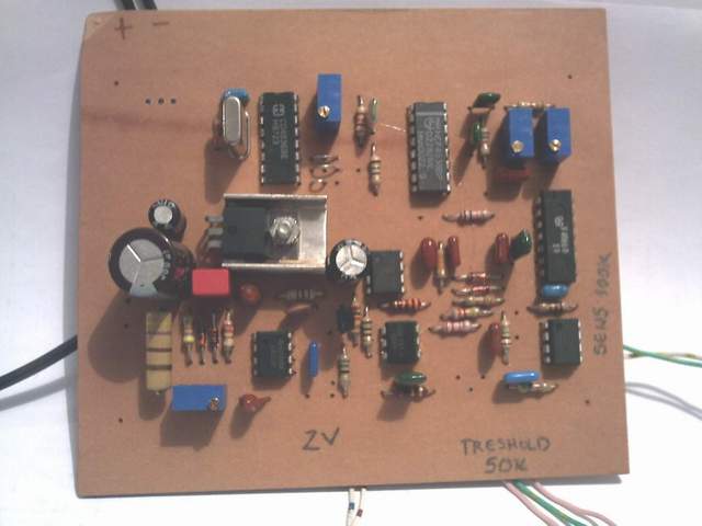

When finishing i'll post some reports here...

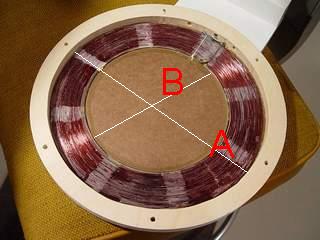

I must be getting SEE-NILE!!! I took the coil apart and measured the winding again, and the inside diameter is 6.5 inches! I had been measuring my coil winder inner form, but I forgot that I did remove some of the inner turns because I ended up with too much inductance. Sorry, sorry, sorry....about that. I have corrected the measurements on the website. Thanks to you for being persistant about it. I measured the diameter of the wire with my dial caliper which came out to .043 inch.
