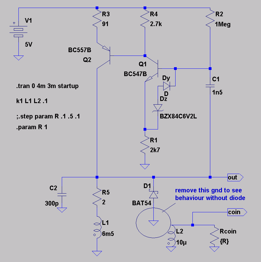

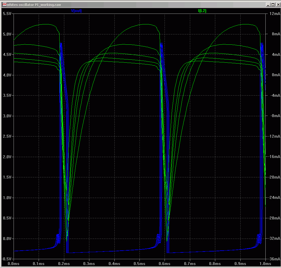

I gave this a critical look and found that something is missing in the picture: a diode in Tx coil. Now it works as a dream, at least in LTspice.
Don't get me wrong, I'm completely new to this , but I'm becoming warmed up.
In my solution you'll find values as per ivcomic diagram, and I added a kind of equivalent of coin with coupling and load. If you like to see how exactly PI performs its magic, just remove a semicolon at ";.step param ..." and place one in front of ".param R 1"
Don't get alarmed by diodes Dy and Dz, they just stand for Vbe breakdown voltage, a feature that is absent in LTspice. They'll kick in only if you remove a diode D1 (or just remove its gnd).
I've done a bit of research to confirm if my choice of coin representation in a spice model is at least near to correct, and amazingly - it is
Of course the 10uH of inductance is a bogus value, but it works with LTspice, and i can play with a resistor instead of the material resistivity, and k-factors for coupling.
What I found is that I can model a 20mm diameter coin as a flat spiral with 1mm thickness and arbitrary number of windings to get me a nice round valued inductance, say 10uH (~40 windings tightly packed) and when I'm happy with the obtained inductance I calculate the equivalent wire length and resistance, which is actually very easy because I know the "coin" area (radius squared times pi), and the wire gauge, which is coin radius/number of windings in mm^2 (coin is 1 mm thick).
To cut the crap short - with 20mm diameter coin of 1 mm thickness, made of copper, and choosing 10uH for further spice models, I get 0.08 ohm resistance.
Now, in the above model I've put step param .1 as a starting value, which would be a perfect approximation for pure gold
Of course, all other equivalent resistances can be scaled by means of thickness and material conductance. Equivalent inductance can be scaled according to the material µ.

For argument's sake, if you increase the size of a coin, and maintain the approach mentioned above, you'll end up with inductance rising by square radius, and at the same time you'll observe resistance rise, also by square radius of coin. 1" coin would be 20uH and 0.16ohm. If you remember that the inductance is just an arbitrary thing, you may scale this 1" coin back to 29mm and simply say that any copper thing with 1mm thickness is modeled the same: 10uH in series with 0.08ohm. Hence material discrimination.
