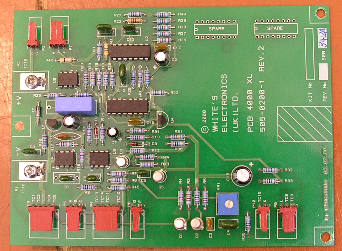

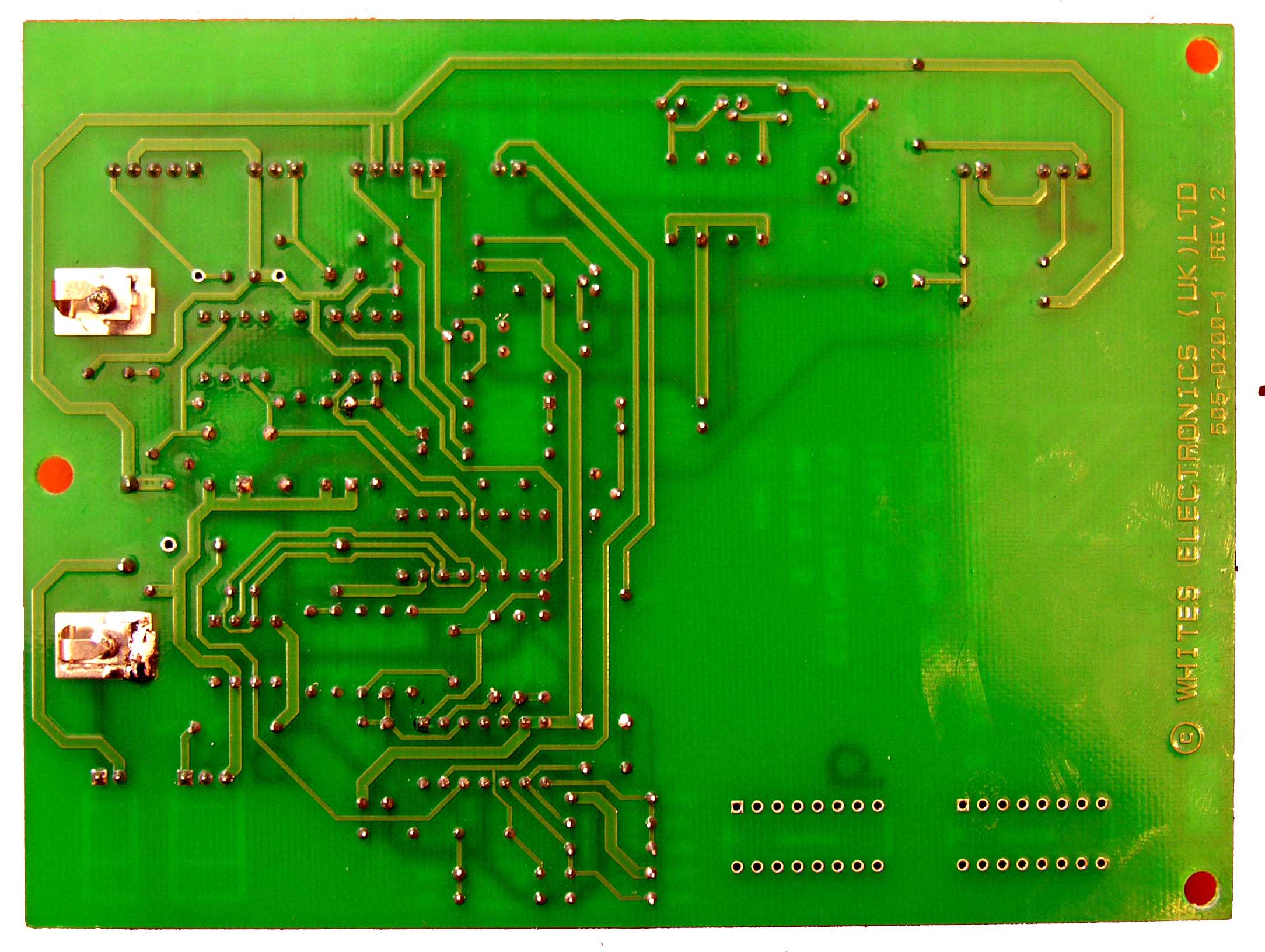

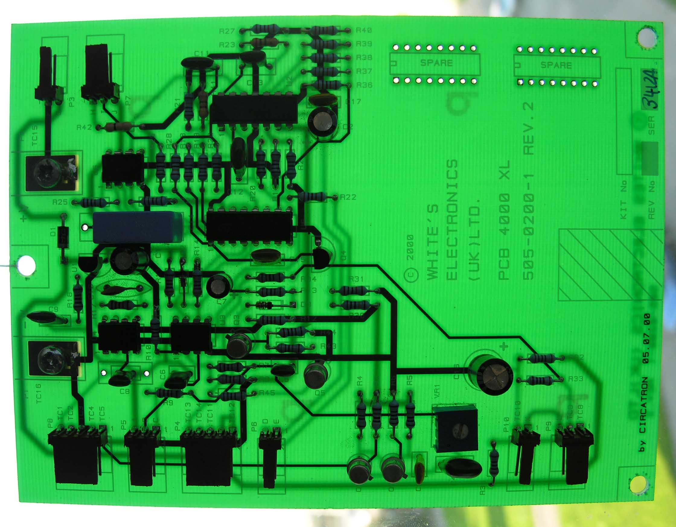

From white's website there are manuals for three versions:Originally posted by ivconic View PostSame as my pcb.
Actually; i think all versions supposed to be the same, sharing same pcb.
Coinmaster 3900 D Pro
Coinmaster 3900 D Pro Plus
Coinmaster 3900 DX Pro

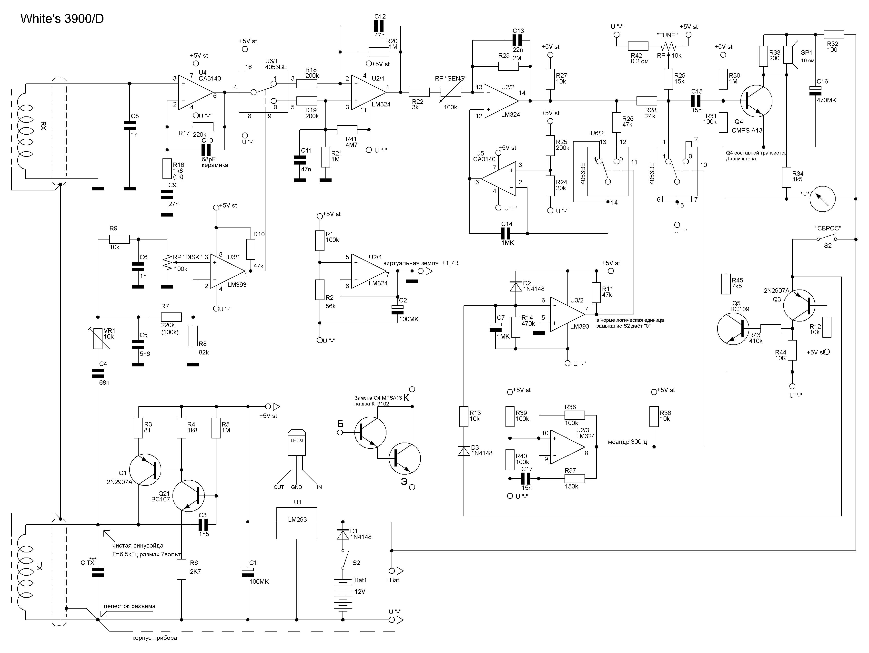

My guess is the basic model does not have the meter and perhaps another model has VR2 trimmer installed to offer some further discrimination adjustment? Could you show how VR2 is wired on the PCB?
BTW turkish guy did not know how to read resistors. Beginners can make mistakes!
I can. I will do that until evening. Than i will inform you here..Originally posted by technos View PostOk, great job. I bet the circuit VR1/R9 etc form a filter circuit. VR2 could replace R9 for more accurate resistance.
Could you measure trimmer VR1 as it was adjusted when you pulled it out of the board? One side is shorted on the board.

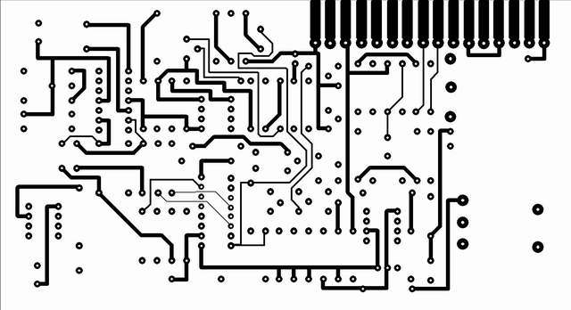

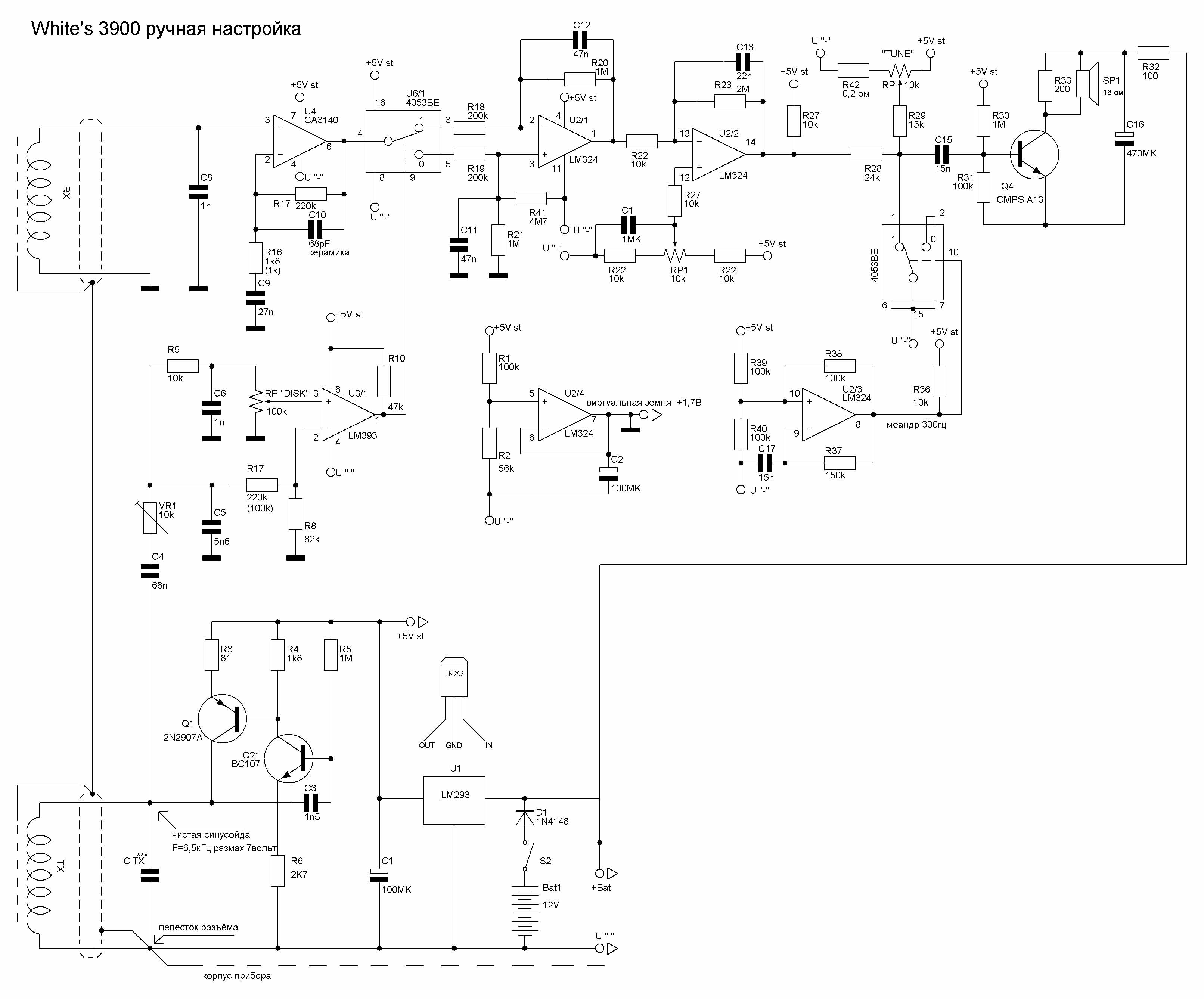

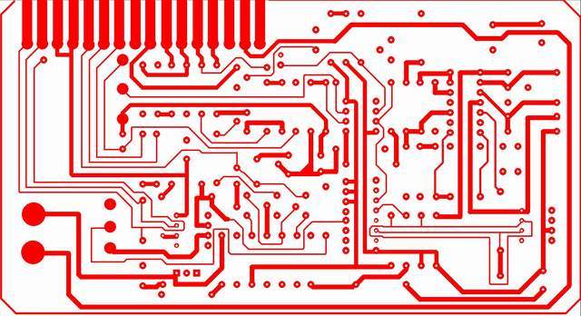

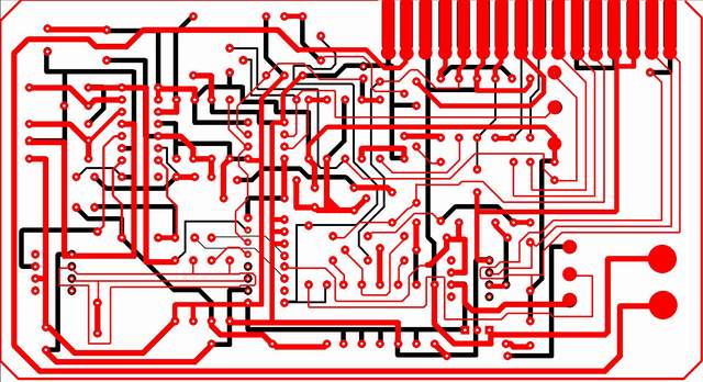

I made two similar units several ears ago and saved some materials about it. May be it will be useful for somebody.Attached Files
