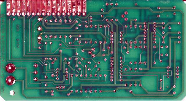

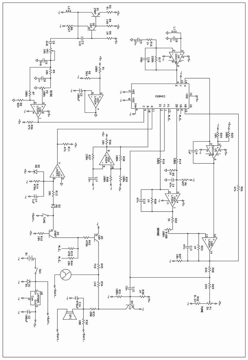

                • #98
                  I am still interesting in accurate 3900 schematic.
                  Because all that have been posted so far is not accuate.
                  I already founded several mistakes at previous posted datas.
                  I will trace it now. When finished i will post here schematic..
                  Here are the scans of original pcb..

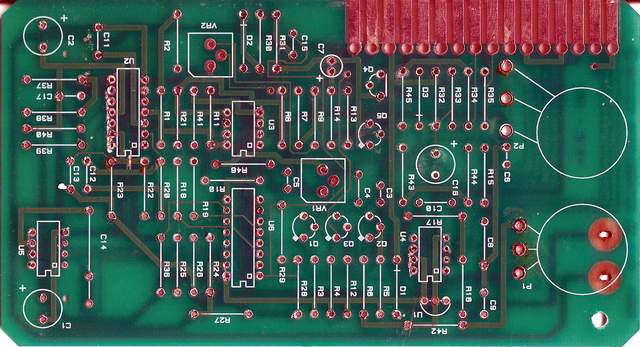

                  • #99
                    Here is what i did. It is possible that i also made some mistake, because original 3900 pcb is horror for tracing. Was it me (to tired) or this specific pcb; fact is that this pcb is horror for tracing. Most probably drawn by some lunatic.
                    That's why intend to trace it correctly and later draw my own pcb, smaller and much better.
                    If you spot any mistake please let me know.
                    P.S. you will notice many resistors with different values than those from previous work, done by our turkish colleagues. I am not sure if there are real differences in 3900 versions (maybe they have different version than my) or those were only mistakes form turkish colleagues. Because i am 100% sure in values i am posting here. 1000% sure and i guarantee those are accurate.
                    Maybe i made some conection wrong...am to tired, but values are accurate, don't worry about those.
                    • Is it possible that White's made some resistors values corrections in late 3900 version?
                      Because i am very confused with turkish version!? Are those guys really made so many mistakes ?!
                      Here is the list of variances (mistakes in their datas):
                      turkish trace.........my trace
                      - R35- 3K....................300 ohms
                      - R34- 1M....................1K5
                      - R15- 47 ohms...........470 ohms
                      - R44- 1k....................10K
                      - R12- 1K....................10K
                      - R6- 170R.................2K7
                      - R28- 100K.................24K
                      - R29- 240R.................24K
                      - R27- 100R.................10K
                      - R24- 1K....................10K
                      - R36- 1K....................10K
                      - R2- 1K5..................56K
                      - R22- 1K...................3K
                      13 resistors differs !?!? To much! That's why i am asking this, because it is hard to beleive that turkish guys made so many mistakes!??
                      Or they really did!??
                      Intentional? Unintentional?
                      • ... in addition..
                        • Ivconic, maybe the PCB the Turkish guy had, used 1% resistors. These are difficult read by eye. Notice how your values are different by 10x on many. I used to own a 3900, in the 1980's it was really stable.
                          -mark
                              -mark
                              Yes, at my 3900 pcb there were also 1% resistors. So i removed them from pcb and than measured. That's how i got proper and accurate values and also chance to scan original pcb on scanner.
                              • Originally posted by lonelyWOLF View Post
                                hi i m from Turkey(emekli amca)
                                I completed my friend's (gürdal s ) jvn project with tgsl coils long time ago.. why tgsl coils? because i have 't orginal coils data ..autotune works perfectly. watch video
                                R35 300 ohm
                                R34 1K5 (scale limit resistor not tested)
                                R44 10K
                                R12 10K
                                R6 2K7
                                R28 24K
                                R29 15K
                                R27 10K
                                R24 10K
                                R36 10K
                                R2 56K
                                R22 1K
                                That's more like it.
                                Only:
                                -R29 15K
                                -R22 1K
                                are different than on my pcb...
