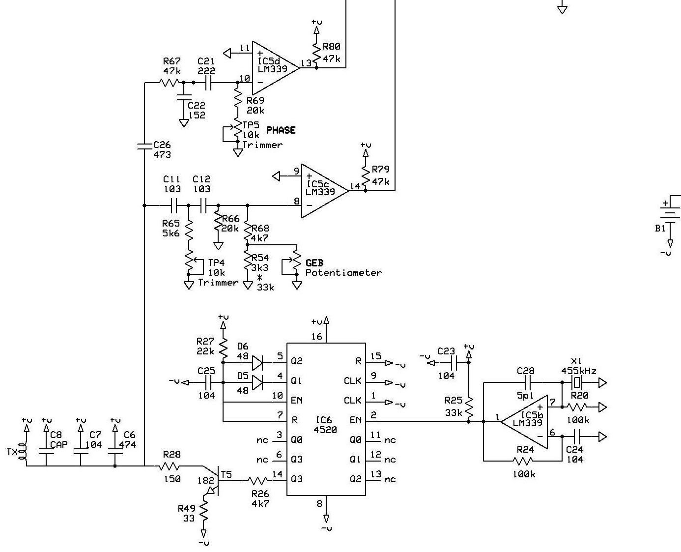

    It is always nice to have the schematic across the post like this:
    Click image for larger version  Name:	Silver Star 5 Sch.jpg Views:	0 Size:	826.1 KB ID:	414974​
      This part can be replaced by stm32f103 or arduino nano, that will allow to put one capacitor in Tx coil and easy adjust frequency for tuning. Base on value Tx capacitors number of turns is approximately 80 turns, 0.5mm wire, however I will do 200 turns, that will increase voltage amplitude on coil, my Rx coil (6.5 kHZ ) is 500t wire 0.15 mm.
        Yes that is correct.
        Attiny is quite enough for such work and does not take up much space on the pcb.
        With an internal oscillator, it does not need any additional components.

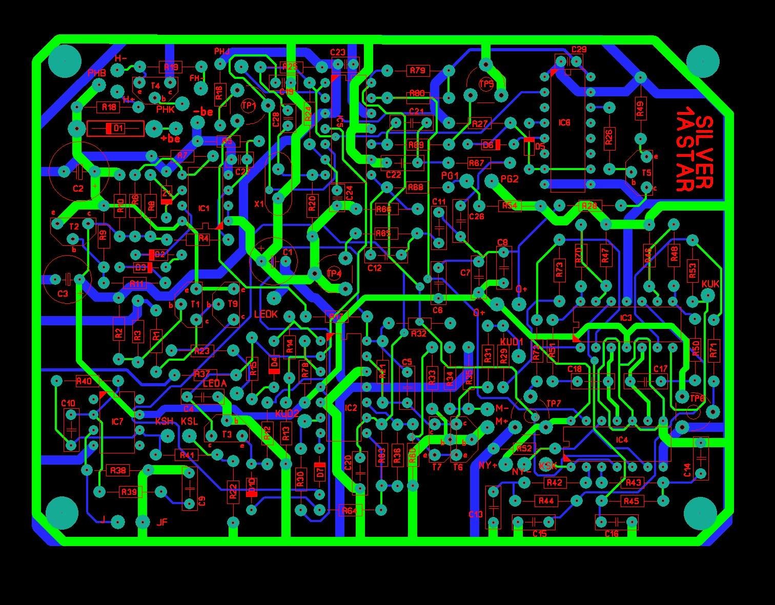

                3. The Silver Star as a depth finder
                  can you do that in gerber ?
                    look for this in red
                      Sure;

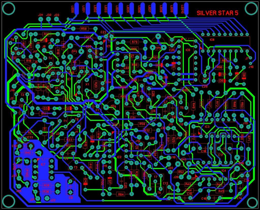

                        And now Silver Star 5 pcb:
                        Click image for larger version  Name:	SS5pcb.jpg Views:	0 Size:	318.9 KB ID:	414999
                          Pito if you intend to build 2box; than Silver Star 5 is more suitable for it.
                          Now you have Sprint Layout file and gerbers for it too.
                          I intend to redraw schematc too, but it is more tedious job, it will take a time.
                          And the original schematic (post #17) extracted from the PDF is good enough by now.
                            silver tr.zip
                            So post #27 is good for schematic post #17 ?
