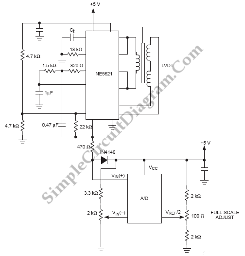

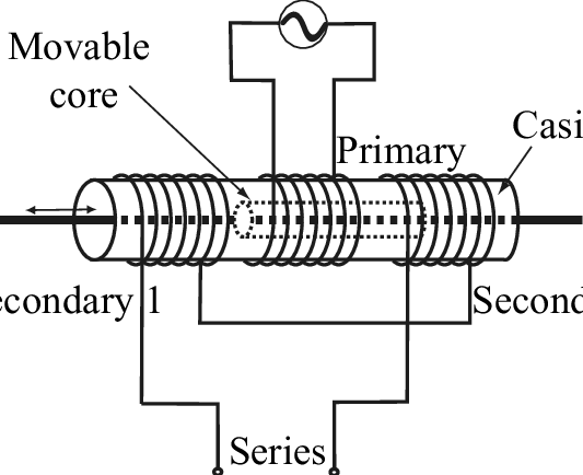

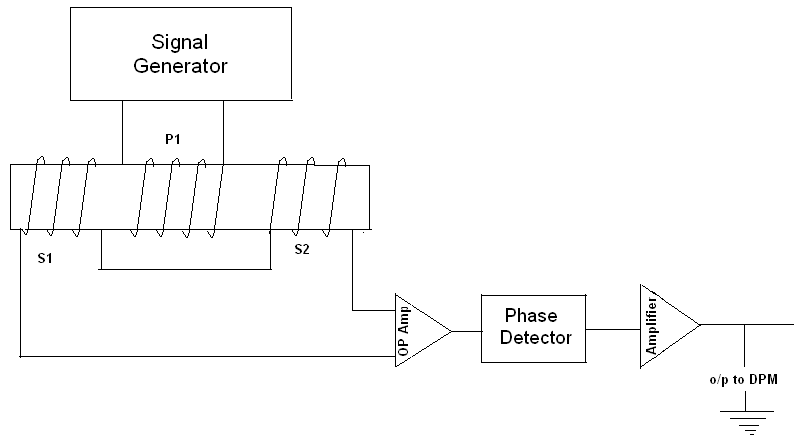

          You may be interested using LVDT principle.
          Click image for larger version  Name:	image.png Views:	0 Size:	26.9 KB ID:	418831Click image for larger version  Name:	image.png Views:	0 Size:	24.7 KB ID:	418832Click image for larger version  Name:	image.png Views:	0 Size:	10.2 KB ID:	418833Click image for larger version

              It's true, that differential schematic give very good sensitivity. But using of NE5521 from 1994 year is not good idea according me. This IC now is hard to find and the price is more than 10 USD.

                                That is a 4mm steel ball, jus testing mentioned LVDT principle, marks are at 1" and 1 1/2", Rx coil is connected directly to oscilloscope without any processing.
                                https://www.youtube.com/shorts/aVN0CnoN8BE
                                adding simple electronics will increase the sensitivity, by 2 times
                                - expected
