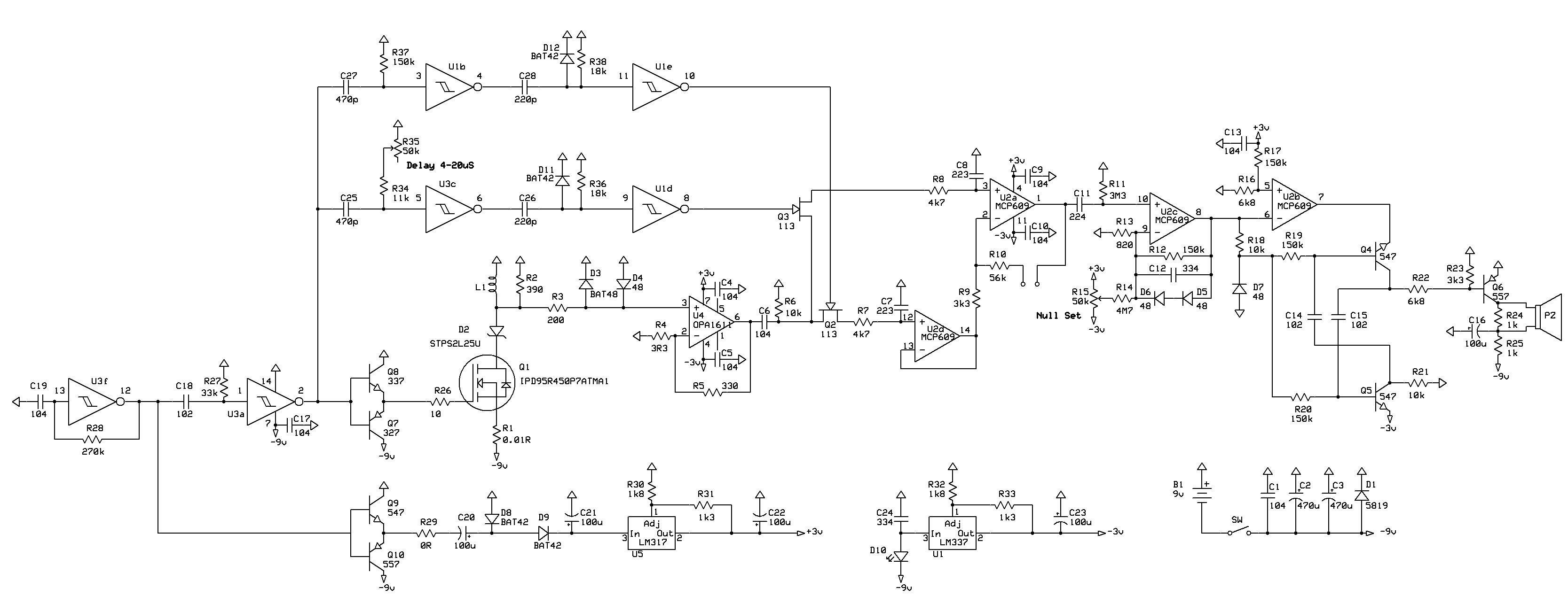

                        I don't know what motivates (or prevents) you not to draw a schematic clearly and legibly?
                        (not only you, I'm addressing all those (and there are a lot of them, especially Bulgarians, btw are you Bulgarian too?) who have the same bad habits, to draw the ugliest and most unclear schematics)
                        LM337 input is not clear to me btw...
                        Remark; very bad results for such a "complicated" schematic? A video demonstration of the work would say a lot.
                        Is it so difficult to draw the schematic a little more clearly, for example like this:
                        Click image for larger version  Name:	Sch.jpg Views:	0 Size:	362.5 KB ID:	418891

                          Proof that I am honest is my effort to draw a schematic clearer and more legible.
                          As I said, the only thing that is not entirely clear to me is the voltage input to the LM337.

                          Finally, I can trace your pcb design and see for myself how what is connected.
                          But it would be easier if you provided a sketch of the pcb layout with components markings and labels.

                                First, thank you for good words for this project. Inside have not nothing new as schematic. I just picked up very carefully every component.
                                Your drawing of schematic is more readable. In my variant, I put many additional information for make more easy the repetition from DIY people.
                                It is important that the resistors around the coil have to be as 3pcs in series - the peek voltage is appr. 1000V. Variant with one high voltage resistor is inconvenient - too expensive or too big size of the resistors.
                                In your schematic you dropped module for battery low indication (yes it's optional).
                                LED diode in the input of LM337LZ is for "Power on" indication only.
                                Now, I prepare final versions of detailed BILL OF MATERIALS and sketch with PCB layout and component's placings.
