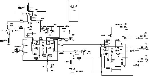

        Here i attach my circuit. Please help me out and tell me what is the problem in this circuit, why it is produce noise. Speacially what other type FET transintor I can use Instead of BFW11.
        I found this type of metal detector use Papaer type Booster capacitor with Coil. Is it necessary, If I use polyster or myler type capacitor, what is the difference ?

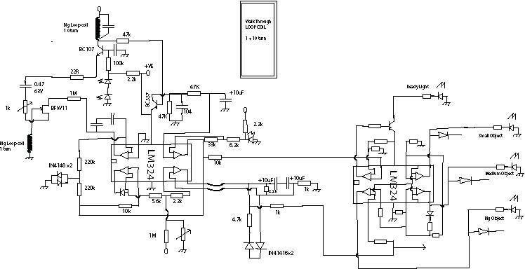

                  Here is the schematic
                  Thanks Qiaozhi,
                  Hope you can help me. Here I attach the schematic again.
                  Jamil
                      sorry for uploading problem
                      sorry for uploading problem, here is shematic.

                          For null the circuit I use 1 K preset with transistor BFW11. I made the circuit already and its works, but its main problem is very much un-stability. Suppose its works 2 mints good and after 2 minutes continue false alarm 5 to 10 minutes if I increase sensitivity a little. This is absulateyly not tolerable for Walkthrough type. Here I attach my circuit picture and my coil picture.

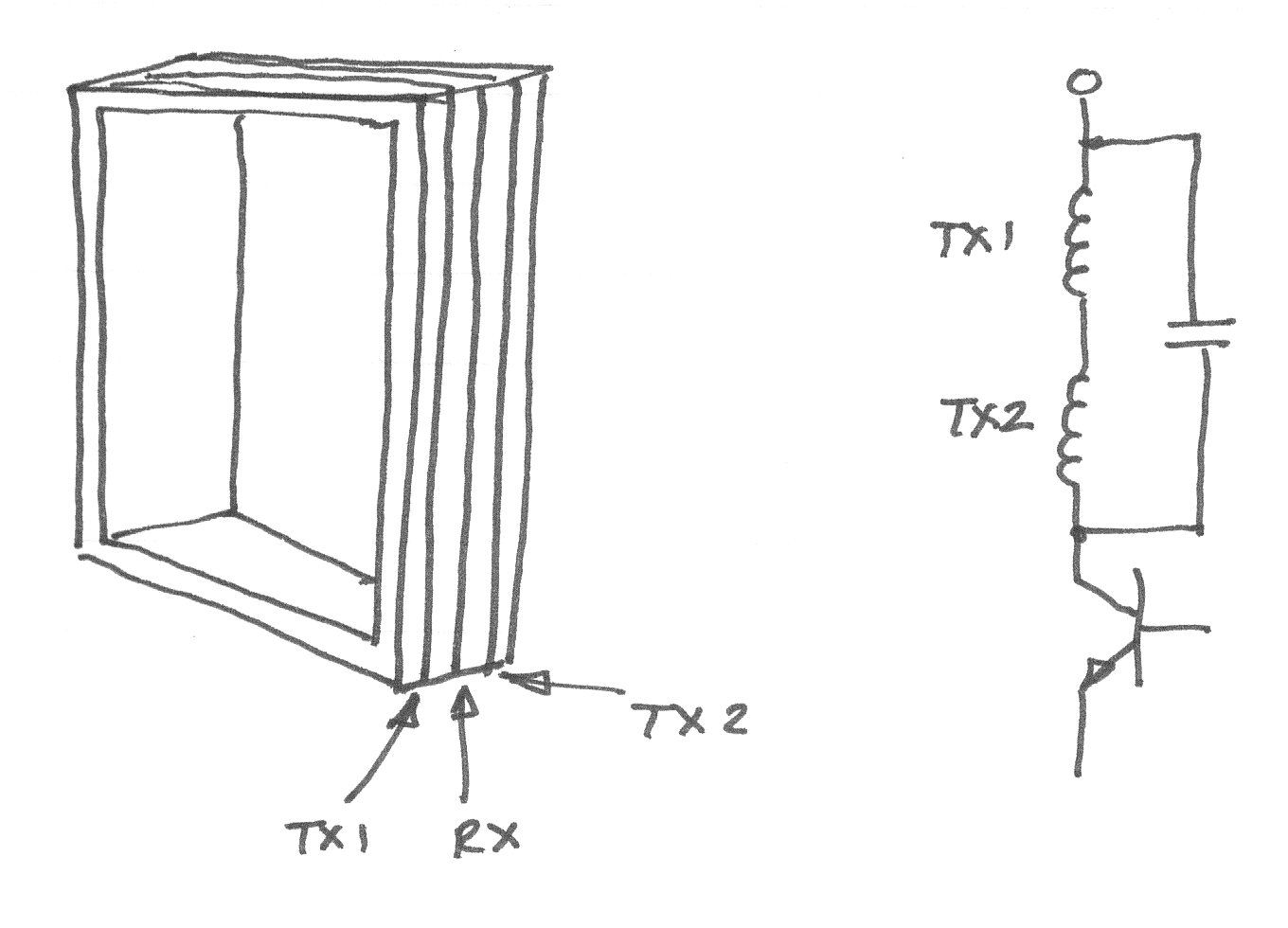

                              It appears that your coil has both the TX and RX coils wound together. This will cause huge problems with nulling the coil. Also it's difficult to tell from the schematic, but it looks like you are using a non-motion mode of operation. If instability is occuring after a couple of minutes, this may be indicative of thermal instability. i.e. voltage levels are drifting with temperature.
                              Here's a couple of suggestions:
                              1. Rewind the coils with the RX coil in the middle, but with the TX coil split in two sections, but spaced equally either side of the RX coil. This is a co-planar arrangement. Nulling is achieved by changing the relative placement of the coils. See very rough sketch below.
                              2. Use a 2-box setup with the TX and RX coils placed at 90 degrees to each other.
                              The P.I would probably still be a better solution.
