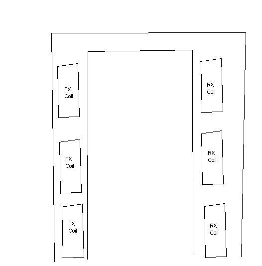

    Could I use T/R Locator metal detector as following form, both coil will be paralal or perpandiculer ?
      This is how most walk-throughs are designed... multiple TX coils on one side, and multiple RX coils on the other. They create detection zones.
      I own a Garrett walk-through, always intended to take it apart and show how the coils are set up, but never have. It's that round tuit thingy...

          This is a picture of a multi zone coil inside walk through. It is may be TX RX system. But its circuit is too complex That I cannot understand. I need help plz.

              I don't think a 2-box would be good for this application. These detectors are designed to detect large cache sized targets.
              According to Carl, this is the usual coil configuration, and in the images you posted it looks like they are parallel, so I suspect this would only work well for a P.I. circuit.
                Here's a neat explanation of how a walk-through detector works (with animation) -> http://travel.howstuffworks.com/airport-security3.htm
                Depending on the complexity you require for your project, multi-zone coils may not be required. Just have a big loop on one side of the arch connected to your P.I. circuit.
