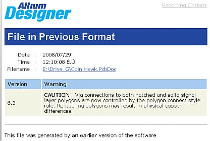

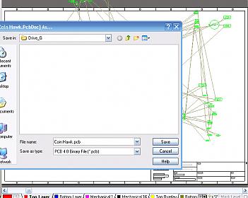

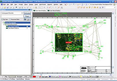

                        • #57
                          Hi Sean Goddard
                          I have installed protel dxp altuim 6.9 (200 ,when open your file
                          Seeing seem this :
                          Also I have this massage;
                          Please resave coninhawk PCB file inPCB4.0 format and upload here .
                          With this method I am be able open it with protel 99se soft.
                          Thank you .
