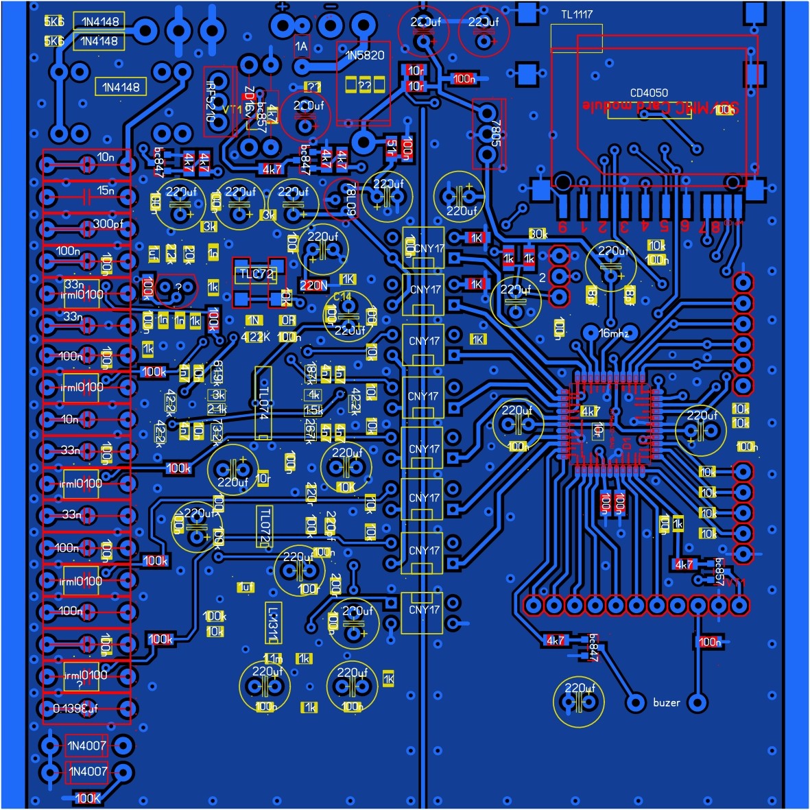

      If you open a lay6 file in the Sprint Layout program, then when you hover over an element, the name of that element will appear.
      Thank You Fisher. I instaled Demo version Sprint Layout and now I see description .

                      Has anyone if anything looked at the pcb and schematic? One fet is not marked as well as the inductance of 100uh is nowhere on the pcb and the 4 resistors are marked as R? Here are the added components, I have not reviewed the schematic in detail!
                      • #56
                        I thought of sending the file for development, but when I reviewed the file again, I found that there were two errors and the question is how many more there are, I have the impression that this was crossed out very quickly without review.
