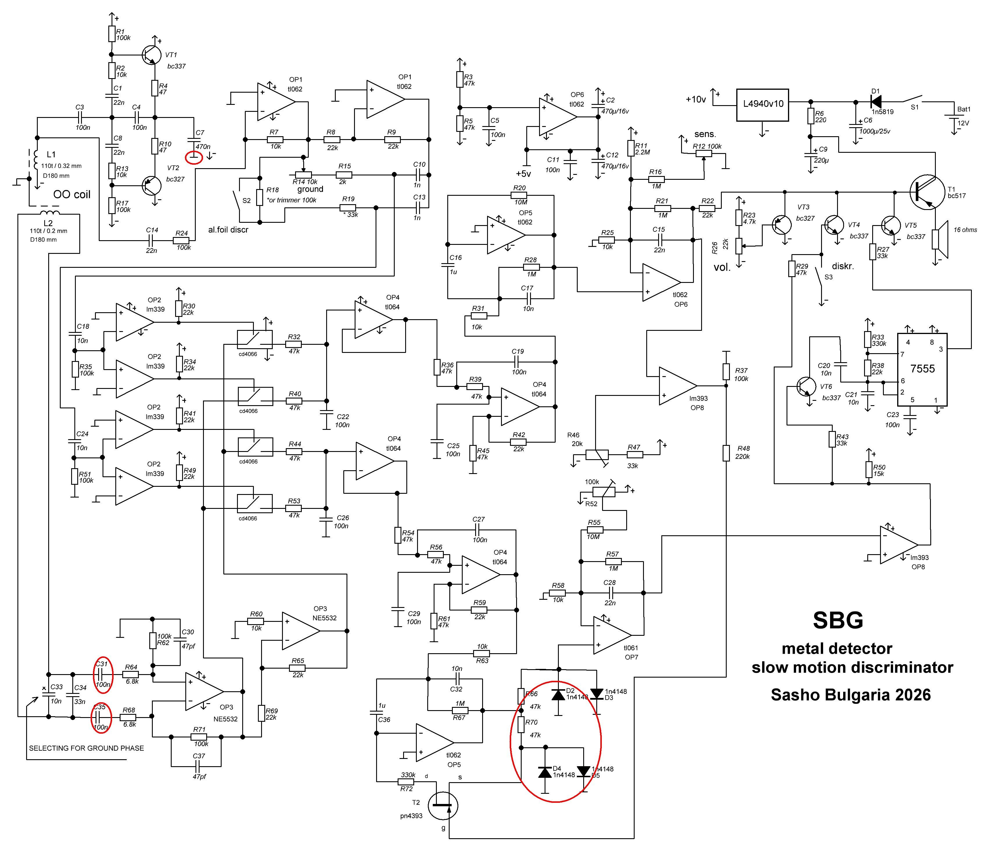

    Thank you so much, SCS-bg, for sharing your schematic. I'm going to build your detector and test it in the field. I'll take some time to make the single-sided PCB. Your video intrigued me, showing how the sound varies with different metals and how it discriminates between them. I think building it will help me understand its operation better. Thank you so much for your contribution to this forum, and we hope you get well soon!
      This is a great "brain teaser" for me on this boring evening!

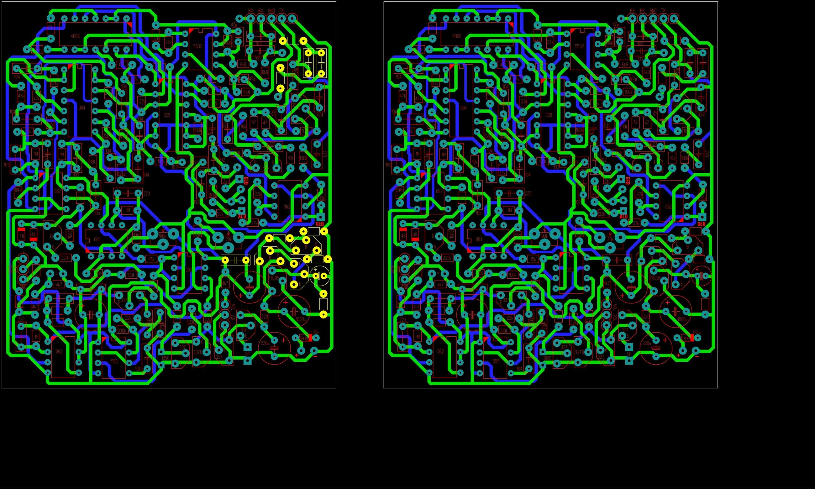

      I "decoded" most of the pcb.
      But there are a few parts that I haven't been able to decipher and need some help here.
      I also found a couple of inconsistencies between the schematic and the pcb. I marked everything.
      BTW my schematic is bad and will need a lot of fixes, so ignore it!
      Instead of clarifying things; I made even more confusion with my schematic!
      In the attachment, I provide a Sprint Layout pcb layout on which only need to write down the values ​​of the components that I have not been able to decipher.
      I also make a few remarks on the original schematic.
      CLICK TO ENLARGE:​

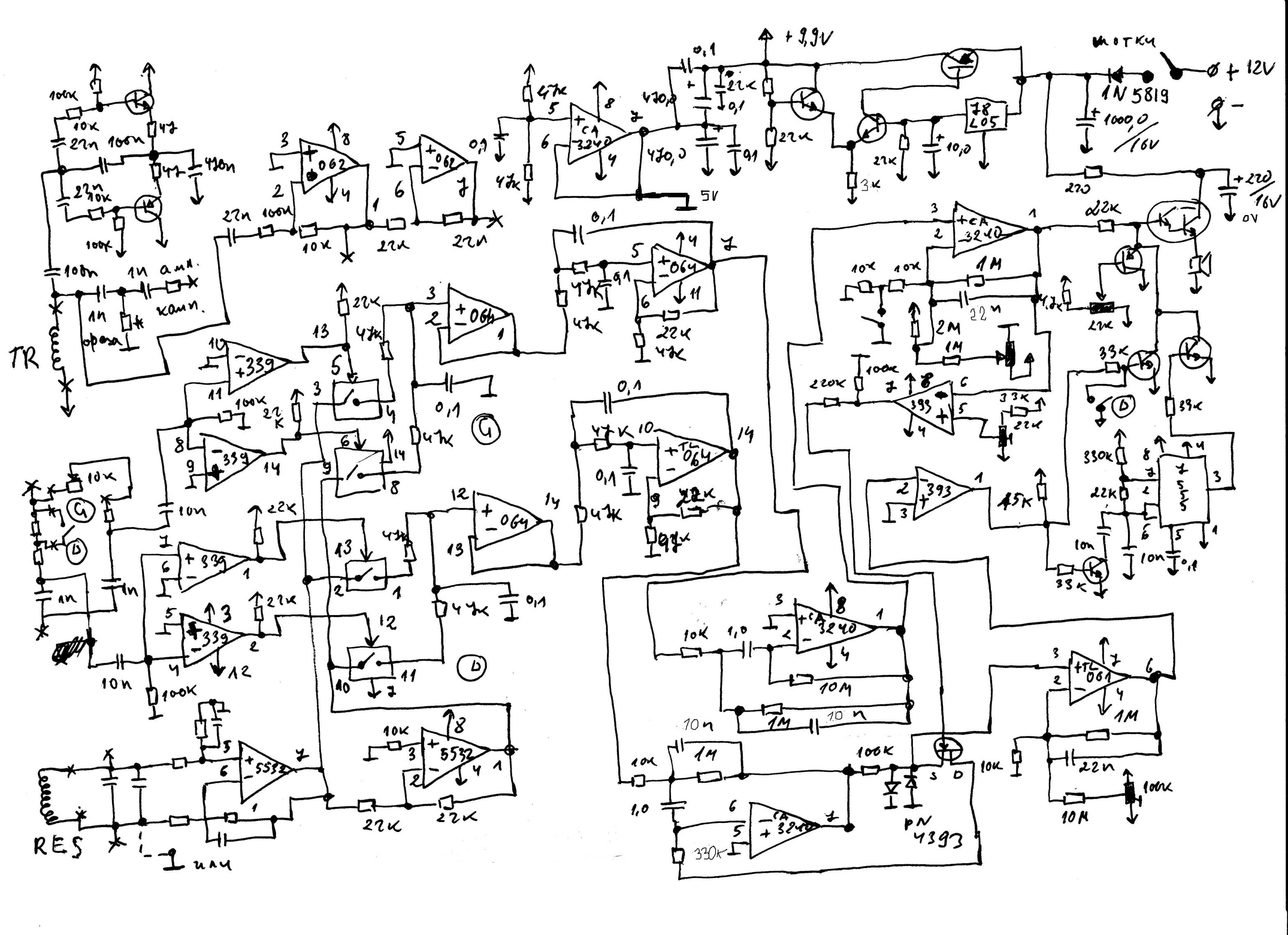

        I think you are working on this board in vain. I made it myself with an iron according to my ideas. In practice, many changes were necessary. This is a test board of this design. The elements are soldered additionally. No one is a prophet in electronics. For example, the diode limiter at the input of the TL 061. No one can predict that the amplifier has a trigger effect when a signal with a large amplitude has a trigger effect. The circuit that I have sent is final and working. Maybe if I had decided to produce, I would have redesigned the board. Now I have no such intention. You can only be happy that I have done the hard work.​
          You need to know that the circuit had a small drift of the discriminator when the stabilizer was transistor. With an integrated one there is no such problem. The circuit has also been tested with DD coils with excellent results. There is a problem when working with coils with small inductance, for example omega and coplanar. Then changes are needed in the generator.​
            The board also includes circuits for compensation of the received signal, which turned out to be unnecessary. However, many beginners will have a hard time dealing with this. Do what you see on the diagram and you will be satisfied. If you do something different, you will get many related problems.
              Ivkonic correctly noticed that the 470nF C7 capacitor in the generator is connected to minus. I made a mistake when drawing the circuit with the program.​
                A separate diode limiter is needed at the input of the TL061 to prevent leakage currents in the control of the PN4393. Without the diodes D2 and D3 as on the board it also works. But not as well.​When connecting the input of the TL 061 directly to the output of the operational amplifier without a limiter, a trigger effect occurs. So this is what works best.​
                  This is the schematic of this board. Many things are different.​ Click image for larger version

                    "...I think you are working on this board in vain..."
                    No, it is separate hobby for me, to "brainstorm" the sketches.
                    Now I get it right, thanks for clarifying.
                    The most proper is the neat schematic you posted earlier ("2026") , but with only one small correction; the 470nF goes to minus instead the ground.

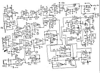

                      This schematic, which is hand-drawn, is a schematic of the board you're working with. It was an experimental board. I wanted to help you. But the design underwent changes that you see on the 2026 schematic.​

                          Well done, you are very persistent. You will get a very good result if you completely change the board according to the 2026 scheme. With a stabilizer integrated circuit​

                              Yes, I will look at the pcb design in the next period.

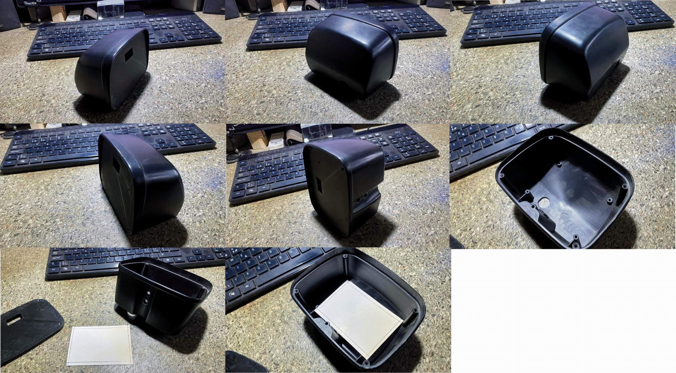

                              I have a nice box from Bulgaria, I think it is a type box for "Golden Mask".
                              I'm just measuring the internal dimensions, to see how big the pcb needs to be.
                              The dimensions are not large, so drawing the pcb will be a little more complicated.
                              I will have to give up my favorite dimensions of 7.5mm for resistors and diodes.
                              I will use 2.5mm for both resistors and diodes and maybe 5mm in some places, where the situation allows.

                              Here is the Sprint Layout template for the pcb that fits into this box:
