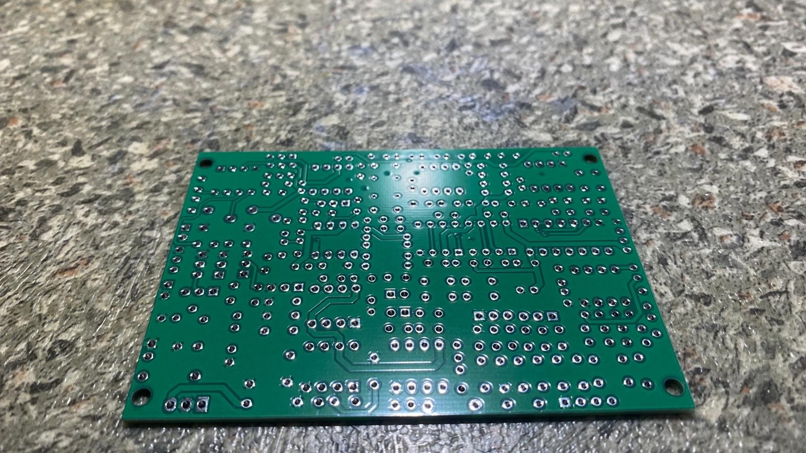

  • Unbelievable, but it finally happened!

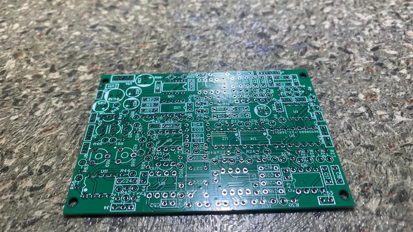

    The PCB from China has arrived!
    A colleague sent it to me a long time ago, but due to a bad choice of sending method; pcb traveled too long!
    So much time has passed that I have completely gone out of focus and topic.
    It will take me a few days to pull myself together and get back to this thread.
    I'll let you know here when I make some progress.

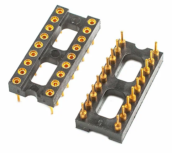

      my suggestion avoid problems - sold to PCB or use золотые панельки для микросхем goldplated sockets.
      Click image for larger version  Name:	золотой разъем.png Views:	0 Size:	279.4 KB ID:	449721

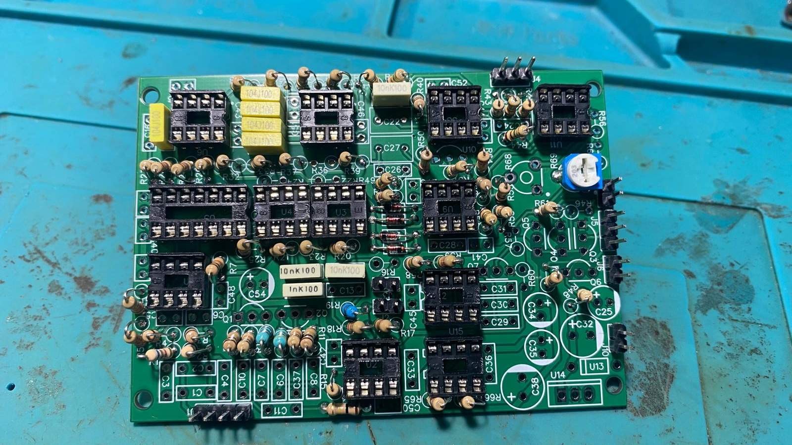

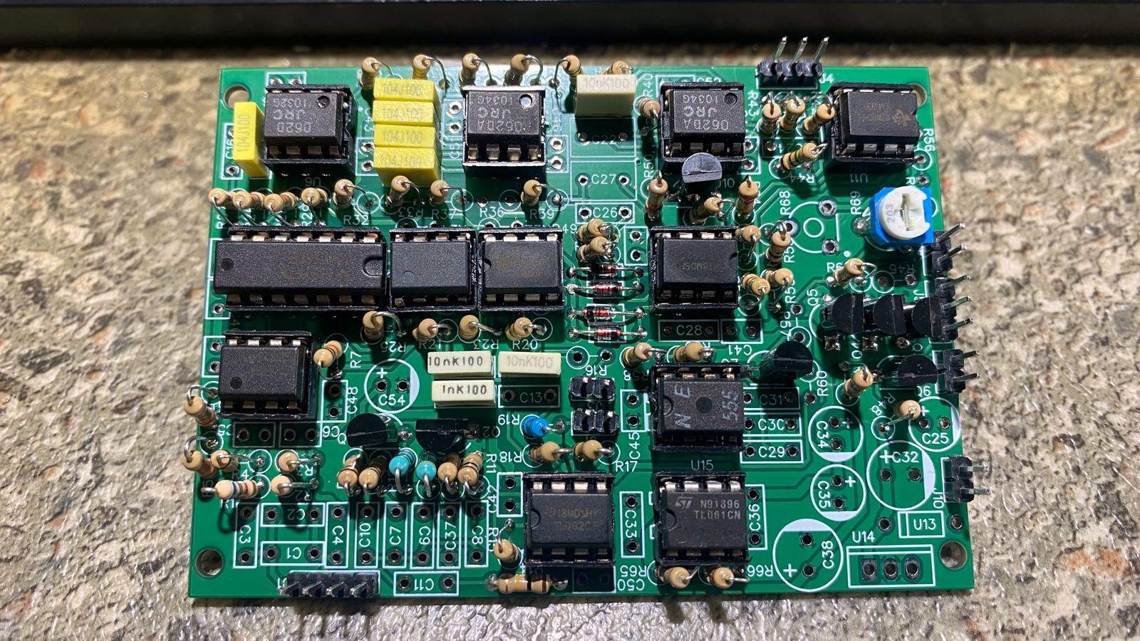

          • I started soldering the components.
            And like Murphy's Law ... I'm always missing some trivial components!
            I will have to order them and wait a few days.

                    ... In several areas (U3, U4, U5), soldering in sockets would be difficult...​
                    Not at all...
                    The 2D/3D drawing on the JLPcb website sometimes does not reflect reality.
                    I have a lot of experience with those web displays so I wasn't too worried about what would happen on a real pcb.
                    Damn capacitors!
                    I always miss them.
                    I have "tons" in boxes in the attic... but I don't feel like searching and digging, because it's all unorganized and unclassified.
                    It's easier to buy new ones from the BOM list (which I didn't make because I'm lazy).
                    Click image for larger version  Name:	Sashos_detector.jpg Views:	0 Size:	488.7 KB ID:	449879​

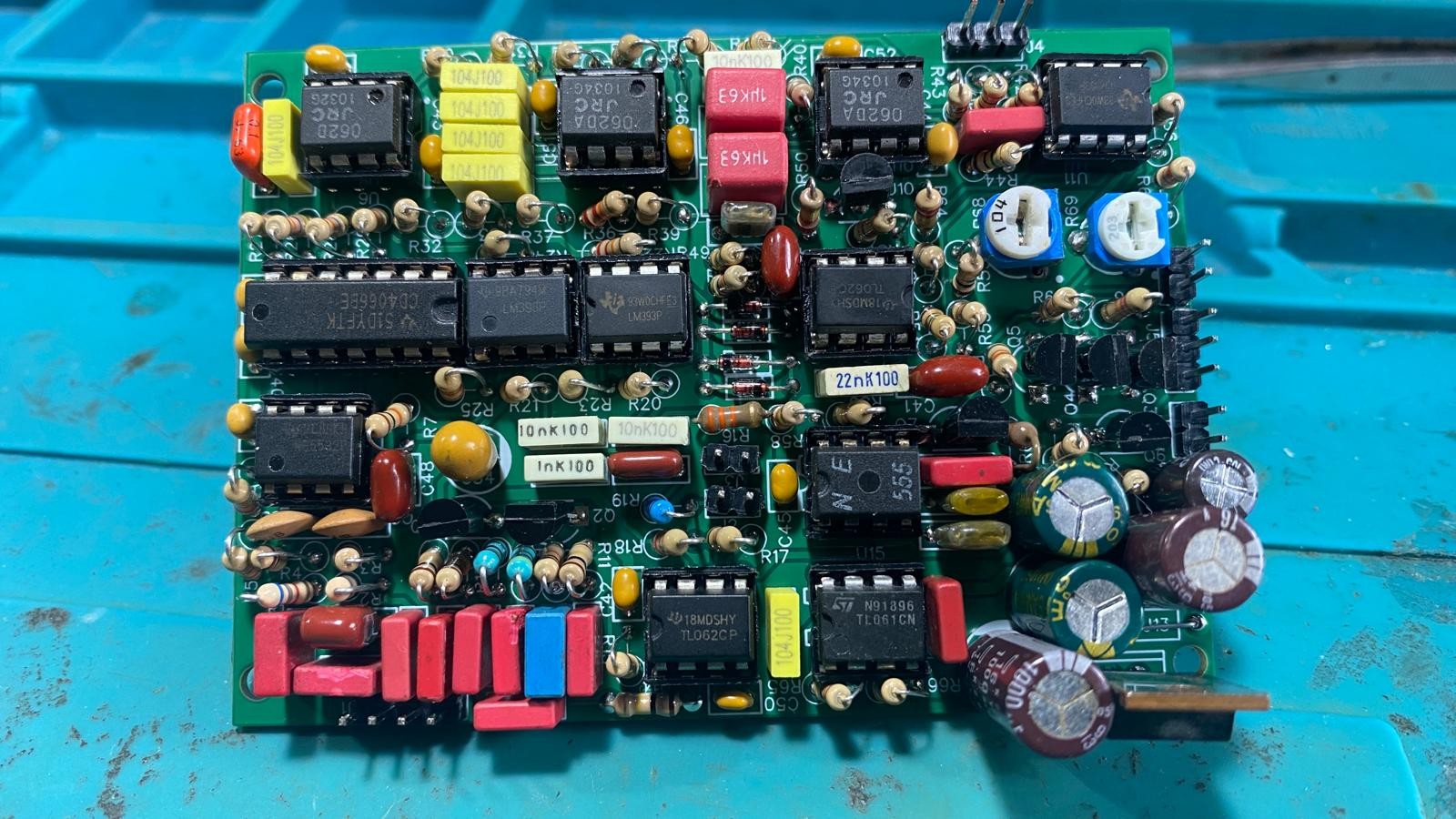

                    • Well...
                      what do you know...
                      I thought; who will now wait for the components, it will take a few days for them to be ordered and arrive at the address.
                      I went to the attic and found everything I needed.
                      The PCB is finished, but I'm quite exhausted, because I'm no longer in shape.
                      Now there's a short break so I can devote myself to coil.
                      • Without any adjustment, without turning the potentiometer, as I soldered everything - I immediately turned on the voltage.
                        Works like a charm from the first switch on.
                        Now I am definitely motivated to devote myself to coil making.
                        This is very promising!
                        Well done Sasho!
                        A phenomenal project!

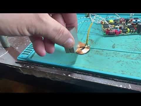

                          • And now we are waiting for the results in real soil. The tests in the air are good - as ivconic said - every proposal must show 3 things: a schematic, a PCB design and a video in real conditions to be properly evaluated.
