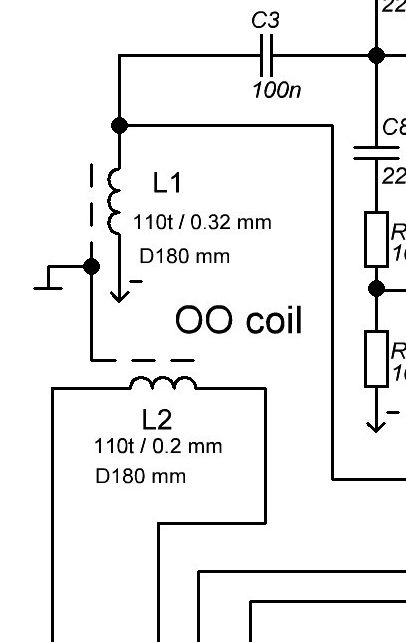

      As far as coil specs; Sasho already gave the specs:

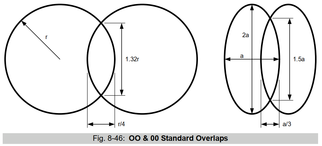

            My 3D printer has a working volume of 220x220x250mm. But in practice I always use 200x200 bed area.
            Ideally would be to 3D print the "OO" coil housing...200x200mm.
            But how do I know the exact overlap area in advance?
            For precise balance.
            Maybe Aziz could help with his magic here?!
            Just ask the AI. AI can tell you the answer in seconds.
            I would take the whole 20x20 cm printing space for a rectangular coil. So total coil witdh = 20 cm (with overlap). 20 cm coil height.
            Overlap approx. 3.0 - 3.2 cm, coil width approx. 11.6 cm, coil height 20 cm.

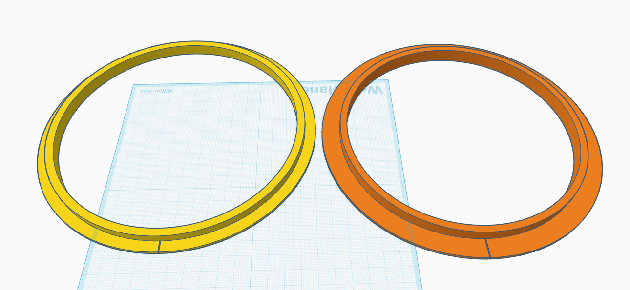

            • Yes, I asked the AI ​​to calculate the dimensions of the "channel" for winding such a wire and 5x5mm is about the "safe" dimension...
              I can start with the 3D drawing...

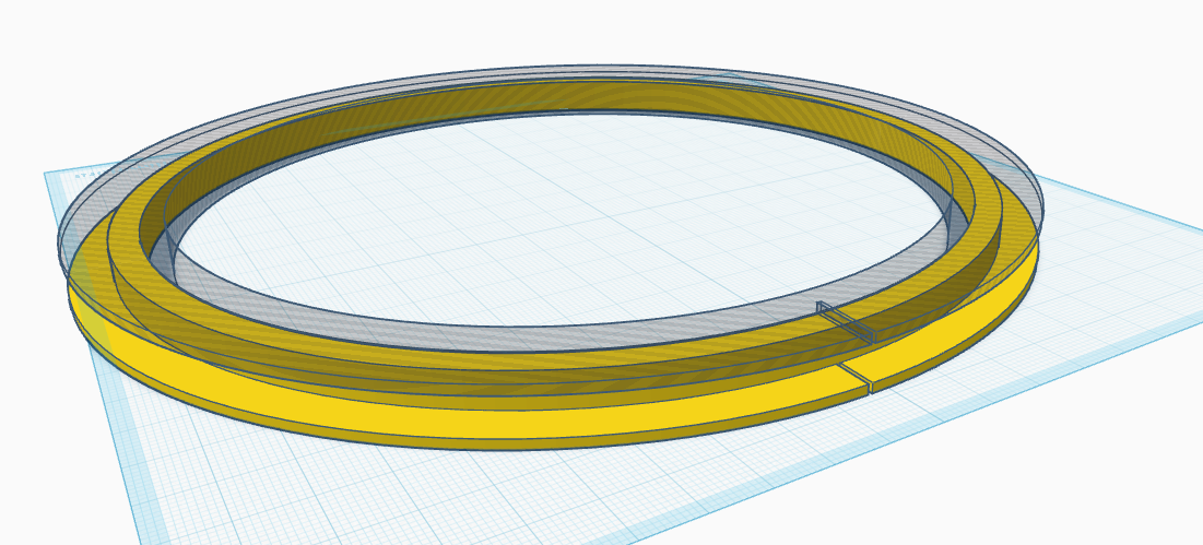

                  I'm trying to draw a 3D "tradeoff" (quality/speed/good design) for winding "OO" coils.
                  This will be a collapsible and detachable "jig" for winding coils.
                  That's a theory for now, we'll see what practice will show.

                      I suspect there is a typo; "r/4" should be "r/2".
                          This is very useful info, thanks!
                          Instead of AI hallucinations, this seems much more real to me.
