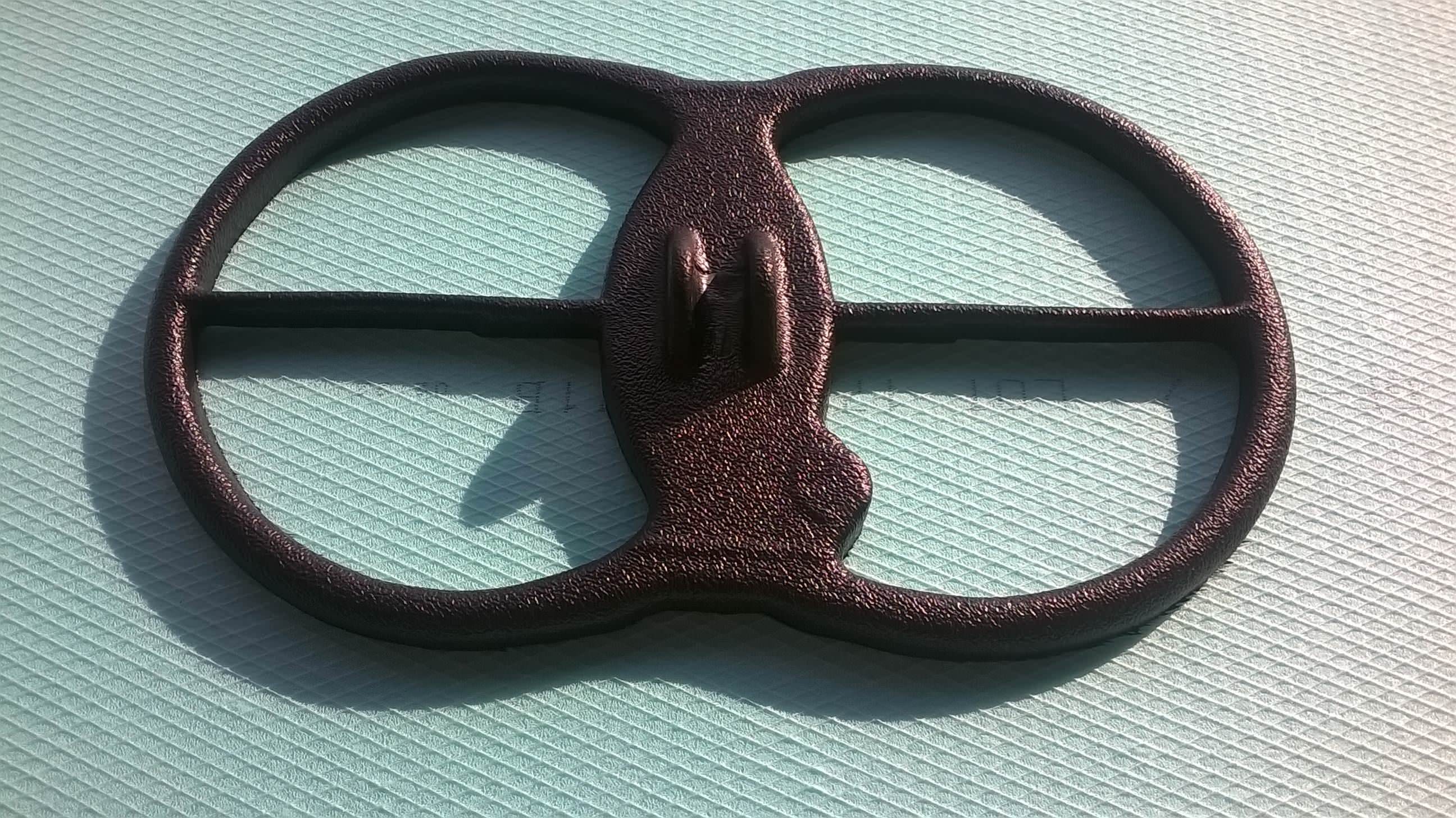

          • I have sent you a shell to see and make from it. It was made by a colleague, but he is no longer alive. He was a good man named sinko1
            ​ in the forum from the city of Varna, Bulgaria.​​
            • Originally posted by algan View Post
              Algan, the colleague's name was sisco1​

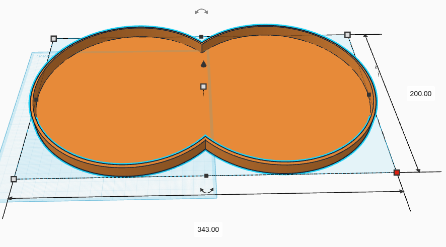

                  • As I wrote before; the working area of my 3D printer is 200x200mm... that's why I can't print the whole enclosure of that type, so I'm not interested.
                    First I will make a "jig" for winding the coils. And then I'll think about a way to make an enclosure...
                    An approximate assessment of the dimensions of the enclosure for such a coil, with the fulfillment of the given criteria; it would be unprintable on my printer.
                    The approximate dimensions would be 343x200mm:

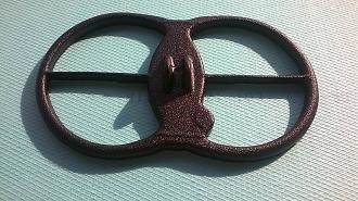

                    • Such plastics for 00 coils were made by someone who had the nickname Hektor on the forum and his real name was Tony. I bought from him some ten years ago, maybe a little less of that kind of plastic. Maybe someone from Bulgaria knows him?
