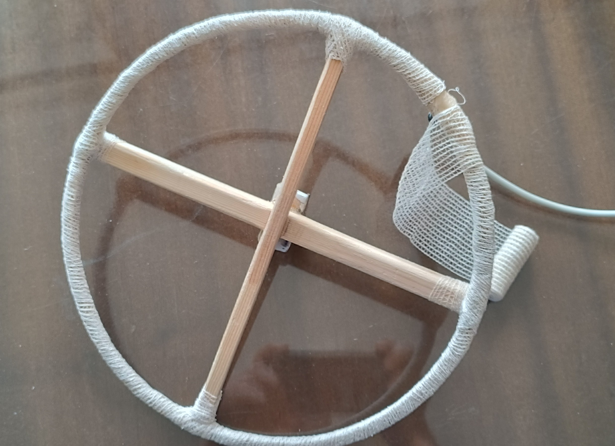

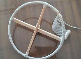

              • #52
ID:	448421 A coil is easy to make. See how I make mine. Bandage, a wooden profile and epoxy resin. You apply the resin with a brush. It turns out very light and strong. In the picture you see a coil for PI. But I don't want to do anything anymore...

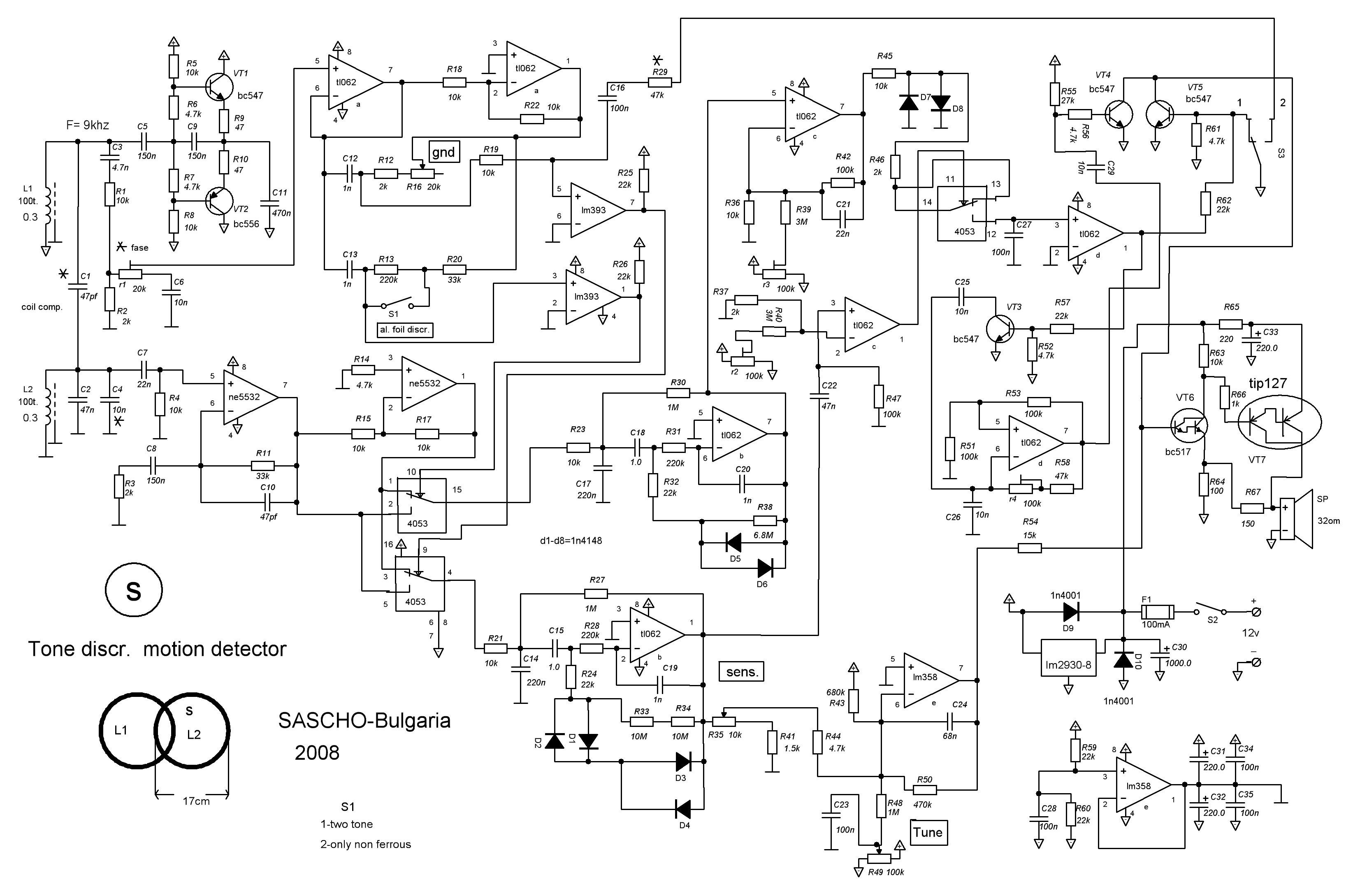

                • #53
                  Hello Pechkata,
                  Is the detector board in the video you posted based on the Whites AF108 mine detector?​ Or what circuit is the base?
                  Hello GeoMax
                  Yes broadcasting from AF108 - analog small board.
                  The big board is this circuit.
